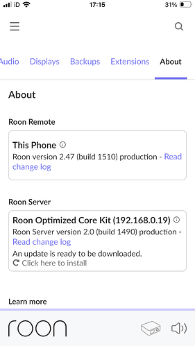

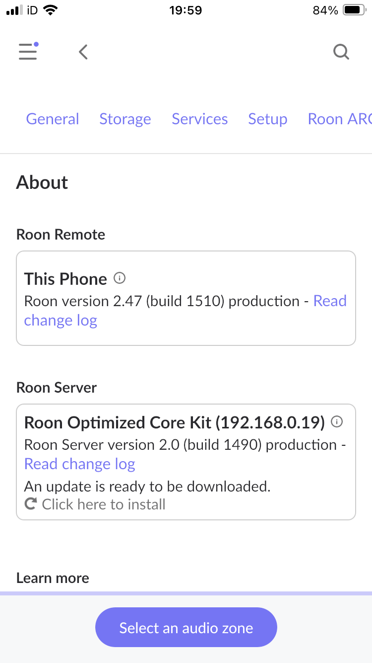

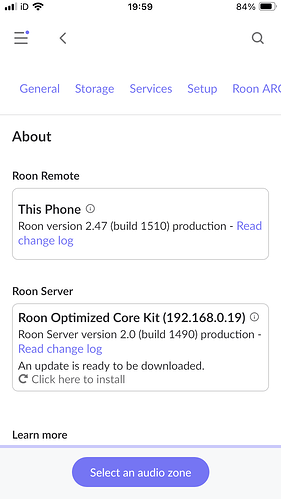

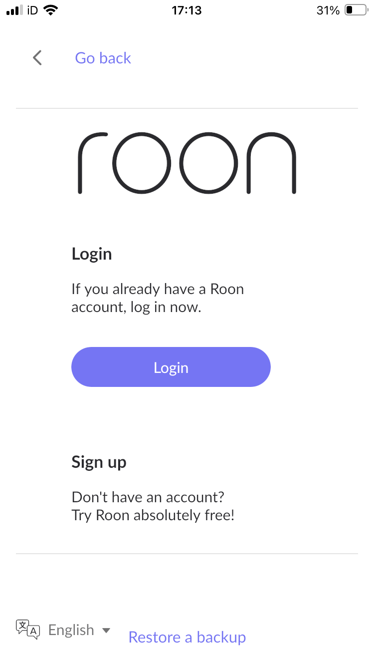

I thought I had resolved the issue yesterday. I update the firmeware to 1510 and Roon will not play any music, I can see my library press play and nothing, it just hangs, reboot the Rock and it defaults back to 1490 and the music still does not play. Wont even play music stored on a HD . `Wont connect to Tidal, just everything appears frozen
Roon Rock connected by ethernet to wifi router

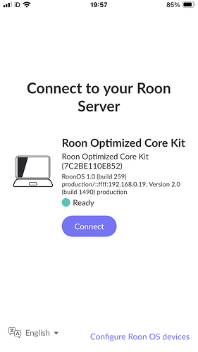

I’m hoping this helps explain

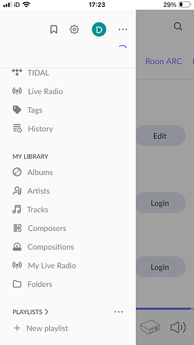

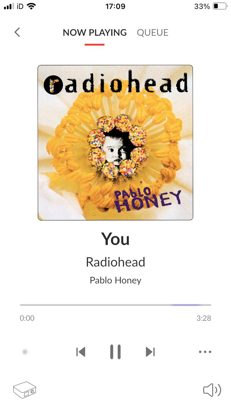

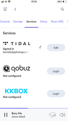

This is also an issue where it is constantly struggling to access Tidal and so playlists are not updating asin the second image its constantly updating something

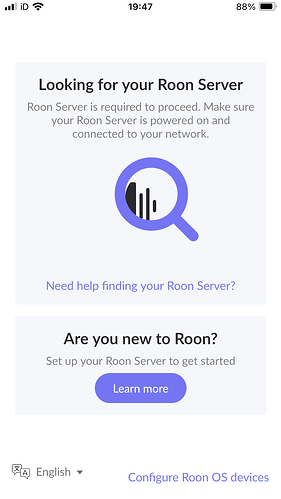

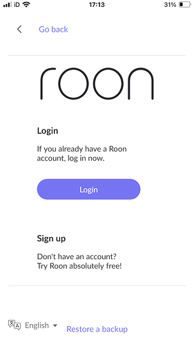

I performed all of those steps and it booted up and the iOS device started loading all of my music
As soon as I went to play something I get " looking for Roon Server"

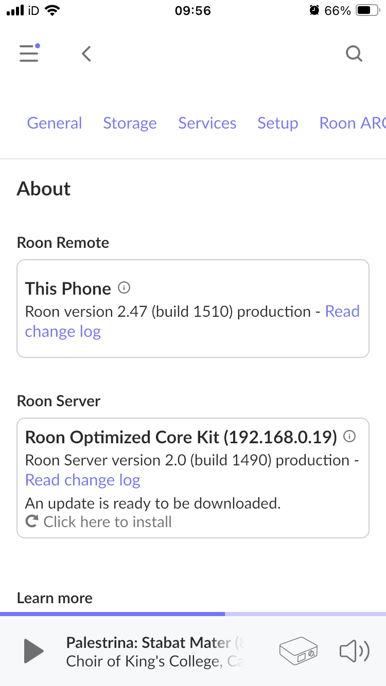

Another update:

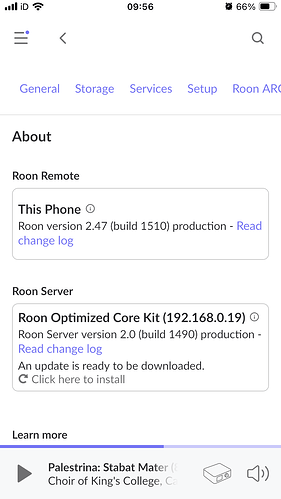

I rebooted the Roon Rock, it fired up and has defaulted back to the 1490 build
This is very frustrating
Music now plays but its defaulted back to 1490

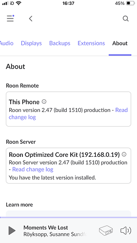

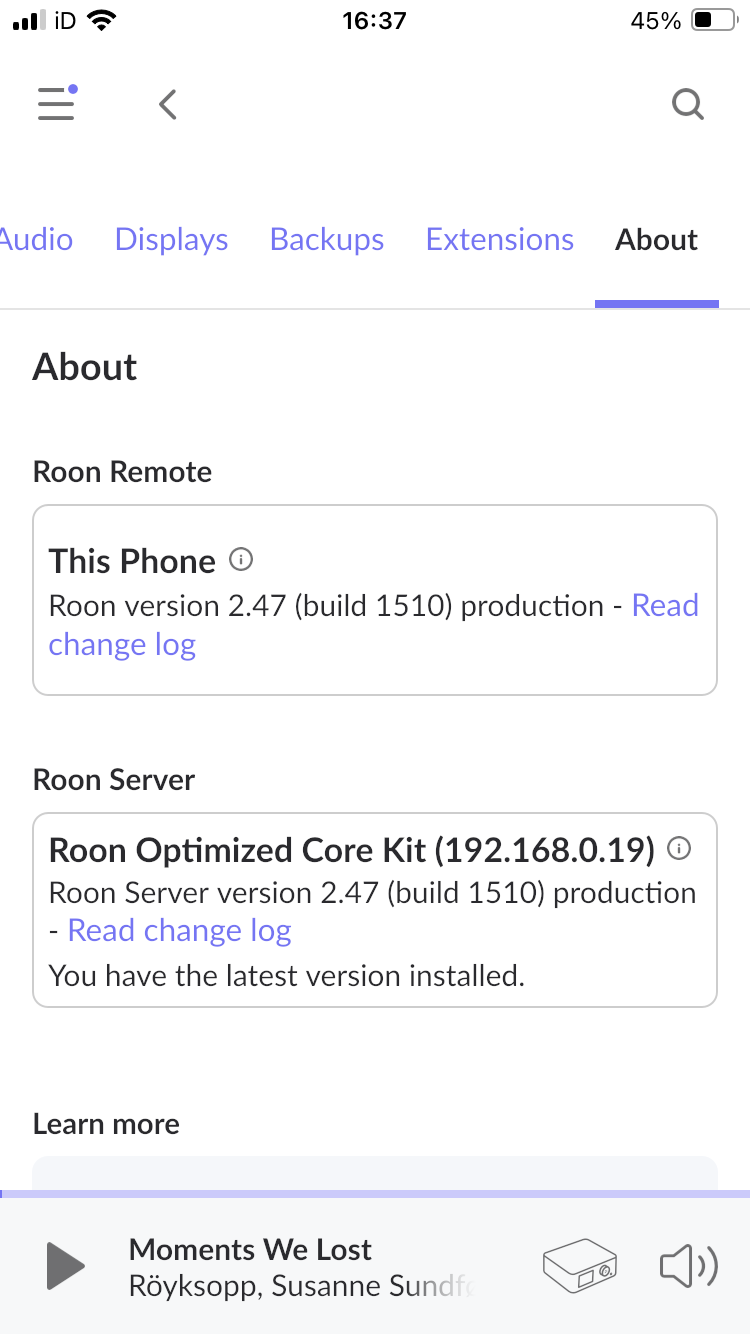

Updated to 1510 and its held but I have not rebooted the Rock so not going to chance it.
Roon iOS working well and quicker
Still no idea why when I reboot the server it defaults back to 1490

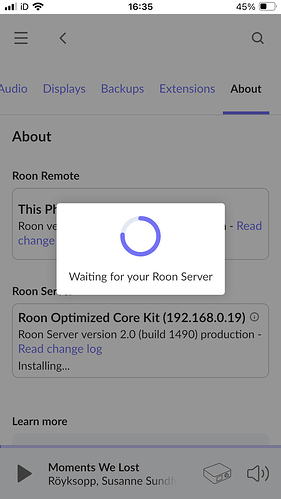

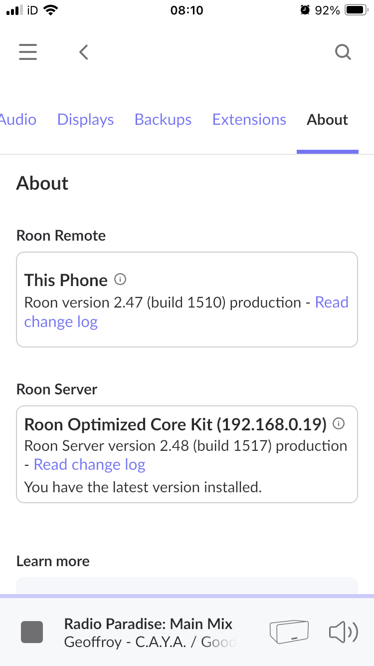

I’ve just performed the latest update
My server has updated to 1517
Yet my phone is still 1510

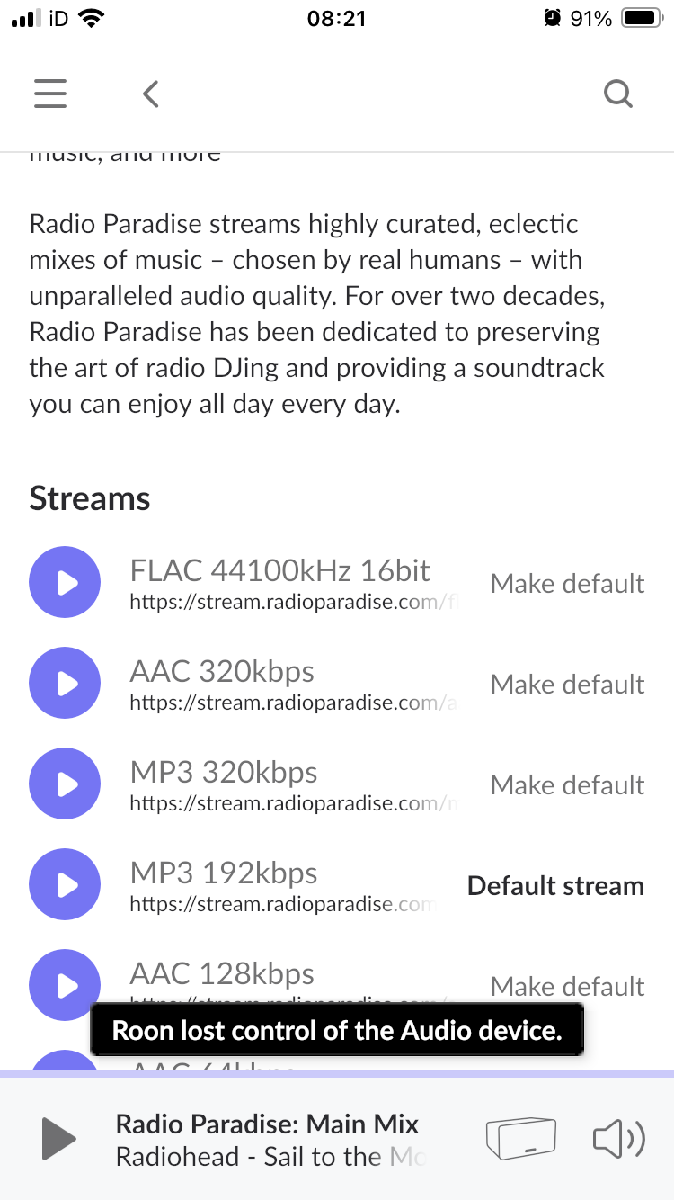

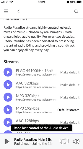

I am experiencing very poor playback even on Live Radio where I keep getting Roon lost control and playback stops

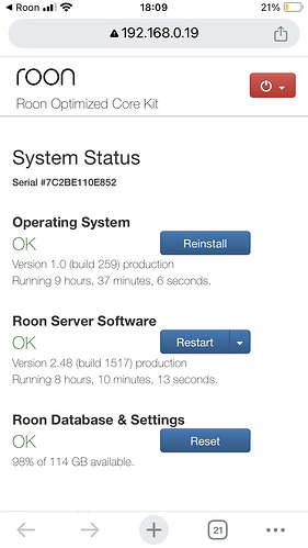

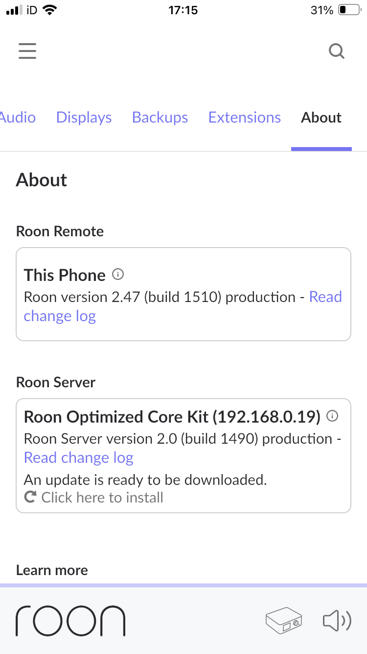

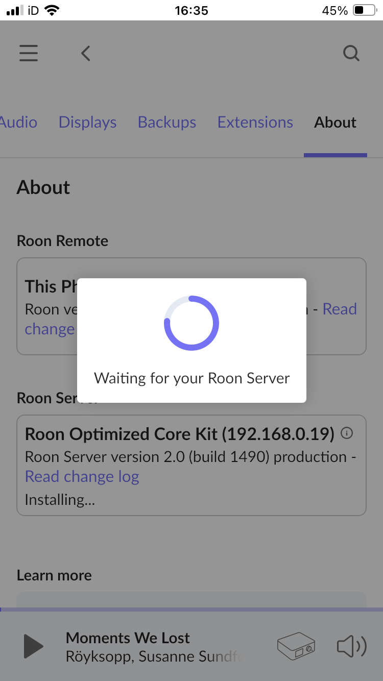

Ok I have done the update
Rebooted the core and it’s defaulted back from 1517 to 1490
Hi @David_Pullum,
Can you please share a screenshot of the RoonOS Web Administration page?
Try creating a Backup and reinstalling RoonOS itself via the web administration page.

Hey @David_Pullum,
Thanks for the update - it does appear that you’re ROCK is running the latest version of Roon.

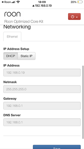

We’re seeing a handful of network-related errors as well - is your ROCK hardwired to your primary router? Can you give your router a reboot, and see if your issues persist afterward?

Yes the server is wired directly to the router, i will reboot and see if that makes any difference
BTW is it normal that the roon rock is on 1517 and the iphone 1516 ?
Hi @David_Pullum ,
Thanks for letting us know you were able to correct the Seagate errors. Do try the reboot and let us know how that goes.
Yes, sometimes the versions will differ. When we have releases, we mention the latest build numbers in our release notes section:
