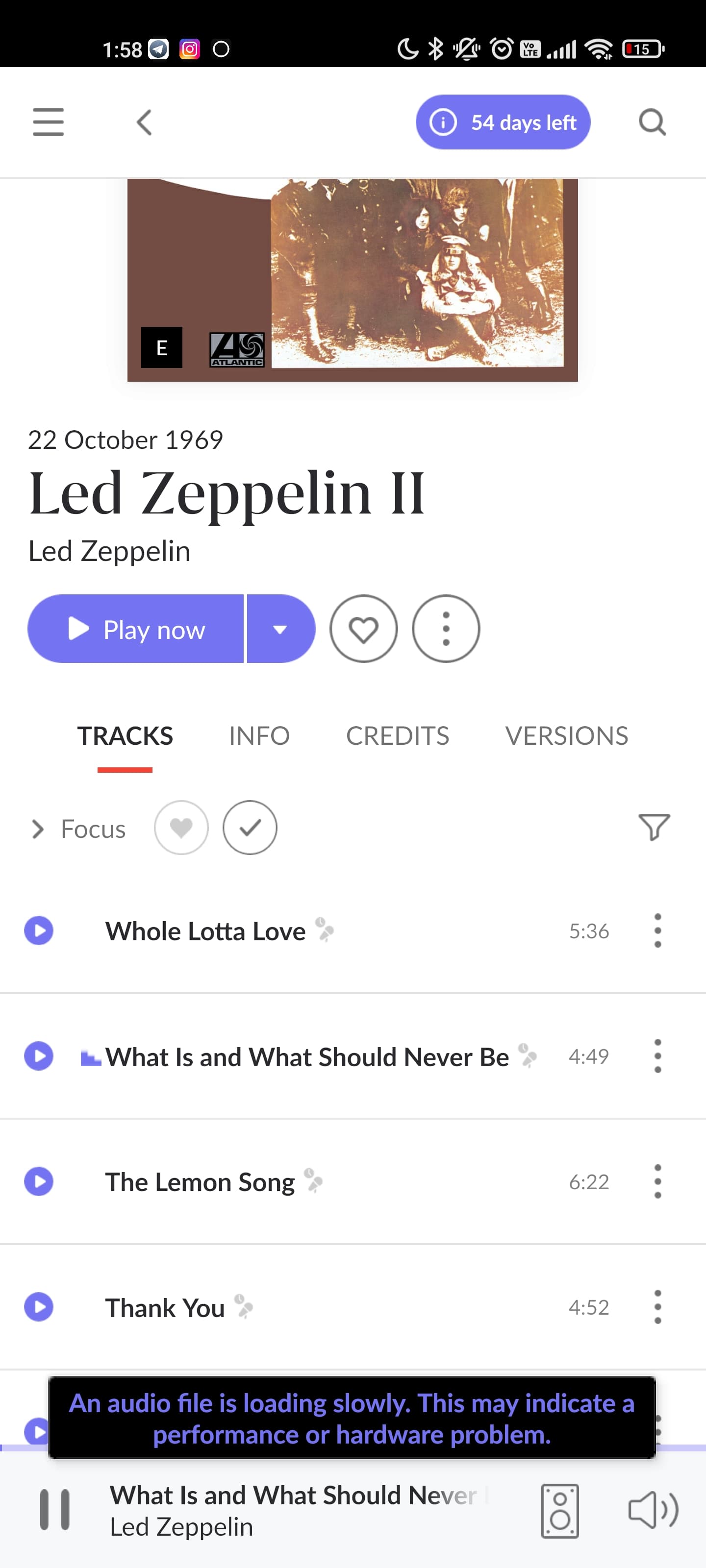

  1. On some albuns I get this error:
Those are regular FLAC files. And I listen to the others perfectly. But one or two albuns I get that message and just skips to the other song. I not considering a network issue, otherwise it would be in most albuns, not just 2/3. Also the server running Roon is an intel 11th generation, installed on a 1tb pcie SSD with 32gb RAM. Any advice/tips?

That could be your issue. Optical can get flaky when you go above 96, it can depend on the particular transmitter, receiver and cable. So, it might go to 24/192 depending on the devices involved, but, it is never a sure thing. For example, my NAD 3020 did 24/192 over optical, but, when talking to NAD tech support, they pretty much stated that they only rate their transmitter to 24/96 reliably.
You might: try a different Optical cable. Or, try using Coax instead.
Hum, I’ve got one of those kabledirect optical from Amazon… they’re not the best, but surely not the worst. But that wouldn’t affect also others?
Going to check if the specs are the same in albuns that fail and then ones that don’t .
Coax is not an option because I use the inputs for my turntable. Loxjie engineers had the brilliant idea of sharing the coaxial in with the RCA. Lol. But surely I can test just to check that theory. Thanks
