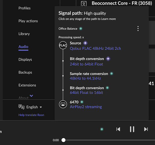

When you try to start playback to a B&O AirPlay zone from Roon Server, do you see the “Playing Now” signal path appear briefly and then stop, or does nothing happen at all?
The signal path shows, and the playback seems to be starting, but never moves past 0:00.

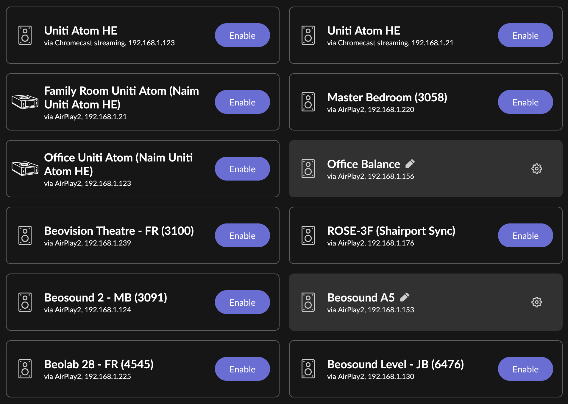

Could you please send us a screenshot of your Settings → Audio screen in Roon? This will help us better understand how the AirPlay zones are detected on your setup.
It’s far too large for a screen shot. Here’s an example:

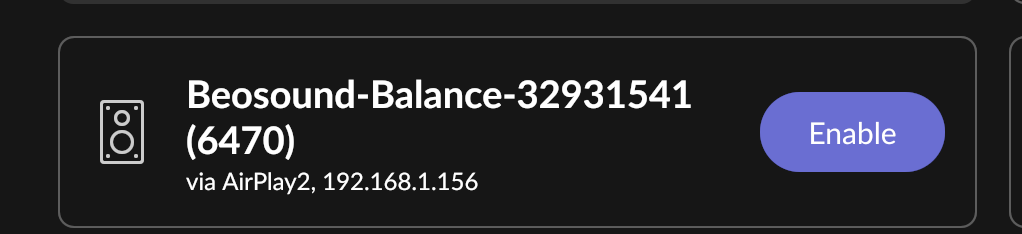

Note that I disabled a bunch of previously active devices in order to rule-out problems. Note, too, that some devices are showing up more than once…but I’ve tried both. See this:

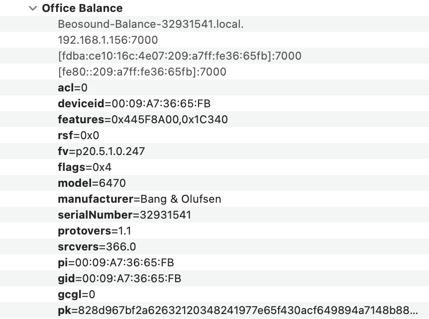

Same IP, same service, different name. Here’s the airplay mDNS info:
