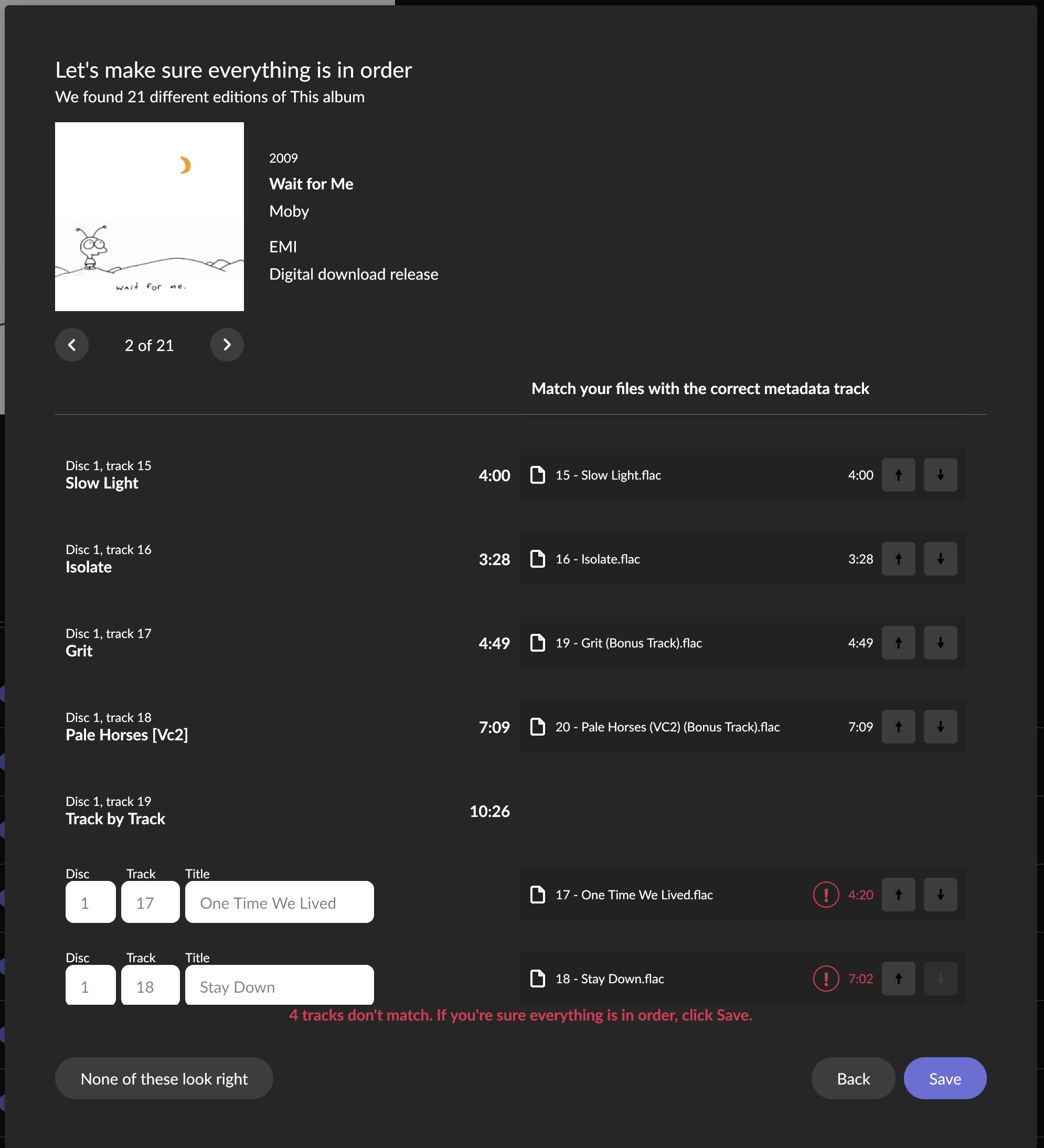

ALL I ask from Roon is to fix the ancient Album Identification field… can’t believe I still have to click the Down or Up arrow like 10 times to move a song to the top or bottom of the tracklist, when with a single click + Drag icon would be so much faster…
And also it’s annoying when you try to move a song that has to go through a middle track that is correctly identified, it screws that track’s position by moving it up or down and then you have to Move that one as well later.

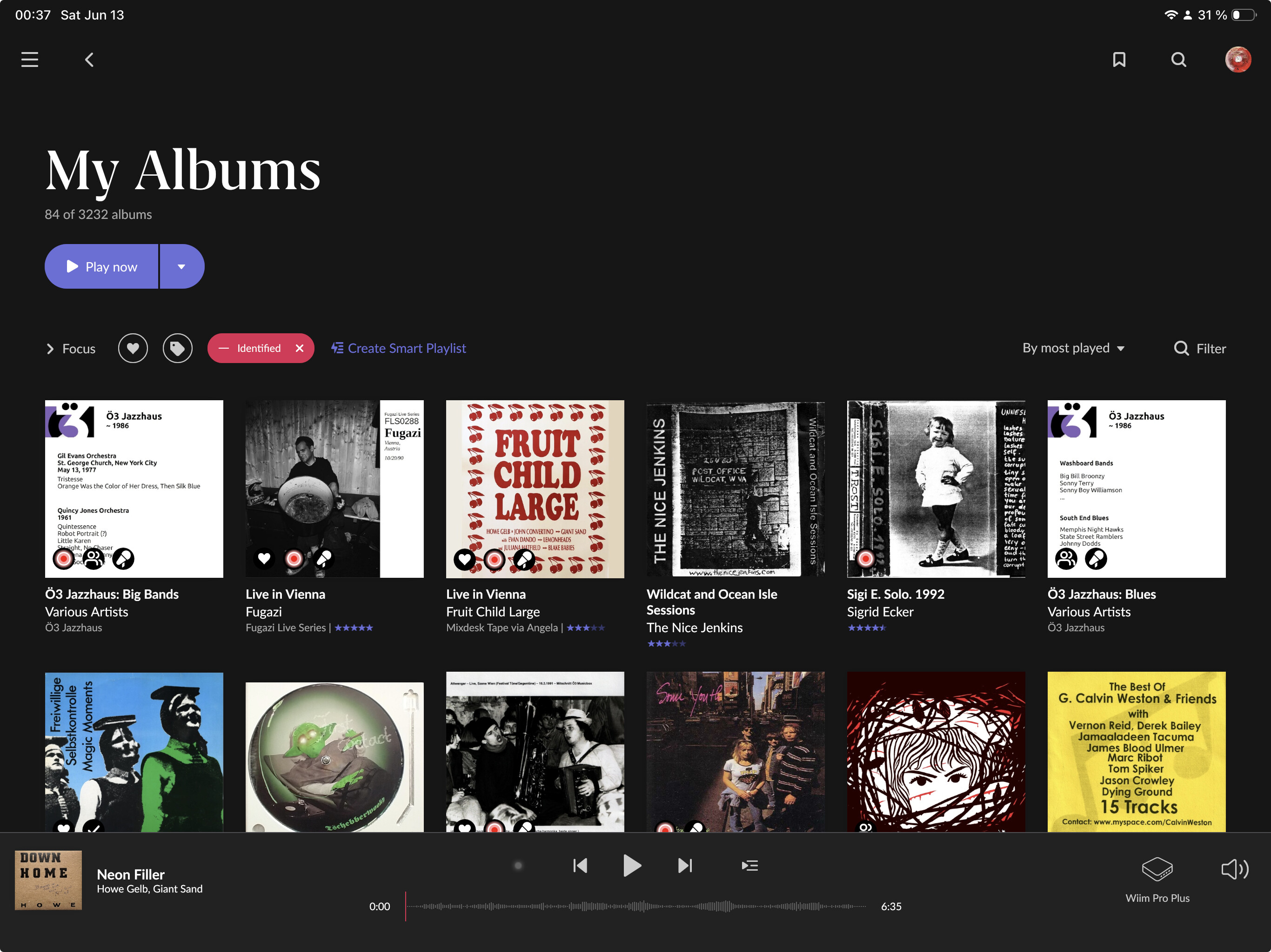

Another request would be to add a filter to the Library filter to show “unidentified albums” so I can fix them, right now there’s only “identified” albums option, which I find it odd, should be the opposite.
That’s not „feedback on Early Access Roon 2.70 Build 1663“ and probably better directed to Feedback
Select the Identified option, then click the resulting purple “+“ Identified tag to invert it, which turns it into a red “–” Identified and accordingly changes the meaning to „Not identified“. You can do this with most Focus options.
Any filter option that is used can be converted to the opposite. So, if I’m on my Windows laptop and I filter for “identified” and want all the “unidentified”, after it is a selected filter, I just hold Ctrl and click on “identified” and it turns the bubble Red, to indicate it is now searching for all “unidentified.”
I don’t think you need the Ctrl for that, just click it. At least that’s how it is on macOS.
Ahhh thanks for pointing this out! I had no idea… :slight_smile: It worked with just clicking on top of the + sign.
