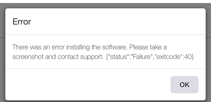

Yesterday I tried to use the Reinstall button via the Web UI, I saw that it downloaded the new OS. After this I saw the following error:
There was an error installing the software. Please take a screenshot and contact support. {"status":"Failure","exitcode":40}
I have already tried a full power cycle of the Titan and restarted my network gear to clear any potential download caches, but the Web UI keeps failing immediately with the exact same exitcode:40 when I open it.

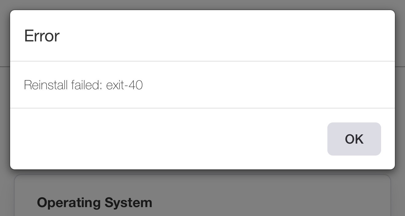

Not a solution, but tagging in to say I am having a similar issue with my Nucleus One. My only difference is that I am on Roon Server Version 2.67 (build 1661) production, and I got this same error message (multiple attempts) trying to use RS version 2.7 (build 1663 and also build 1665). I even tried using different browsers to access the Nucleus admin page, just in case it was a browser cache error.
Rebooting the Nucleus from the Admin page, or physically, restores Roon to the previous state and it runs great as it had been. So, not overly concerned, just wanted to see the improved speed and stability that has been documented and discussed.

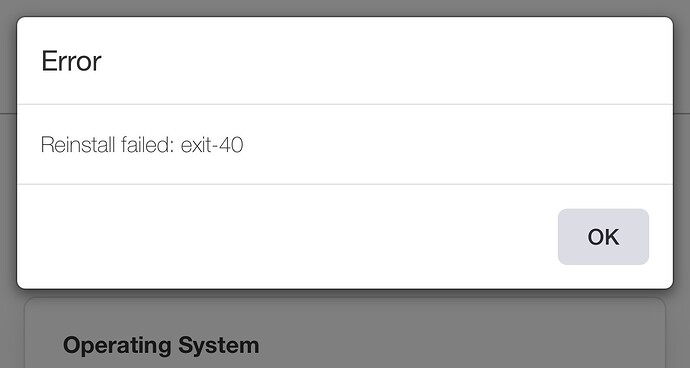

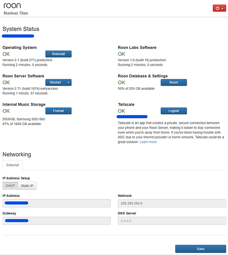

I previously reported in a different thread that when I tried to roll RoonOS 3.0 back to production to test a different issue (now resolved), I was getting an exitcode 40 failure.
Last night I updated to RoonOS 3.0 build 279 using the built-in update mechanism through my Roon desktop client. I then performed a reboot and let it run overnight. This morning I attempted to roll back to production again. I can confirm it worked without issues.
I played one song on RoonOS 2.1 build 271 before switching back to RoonOS 3.0 build 279. Tailscale also remained signed in moving both directions.
