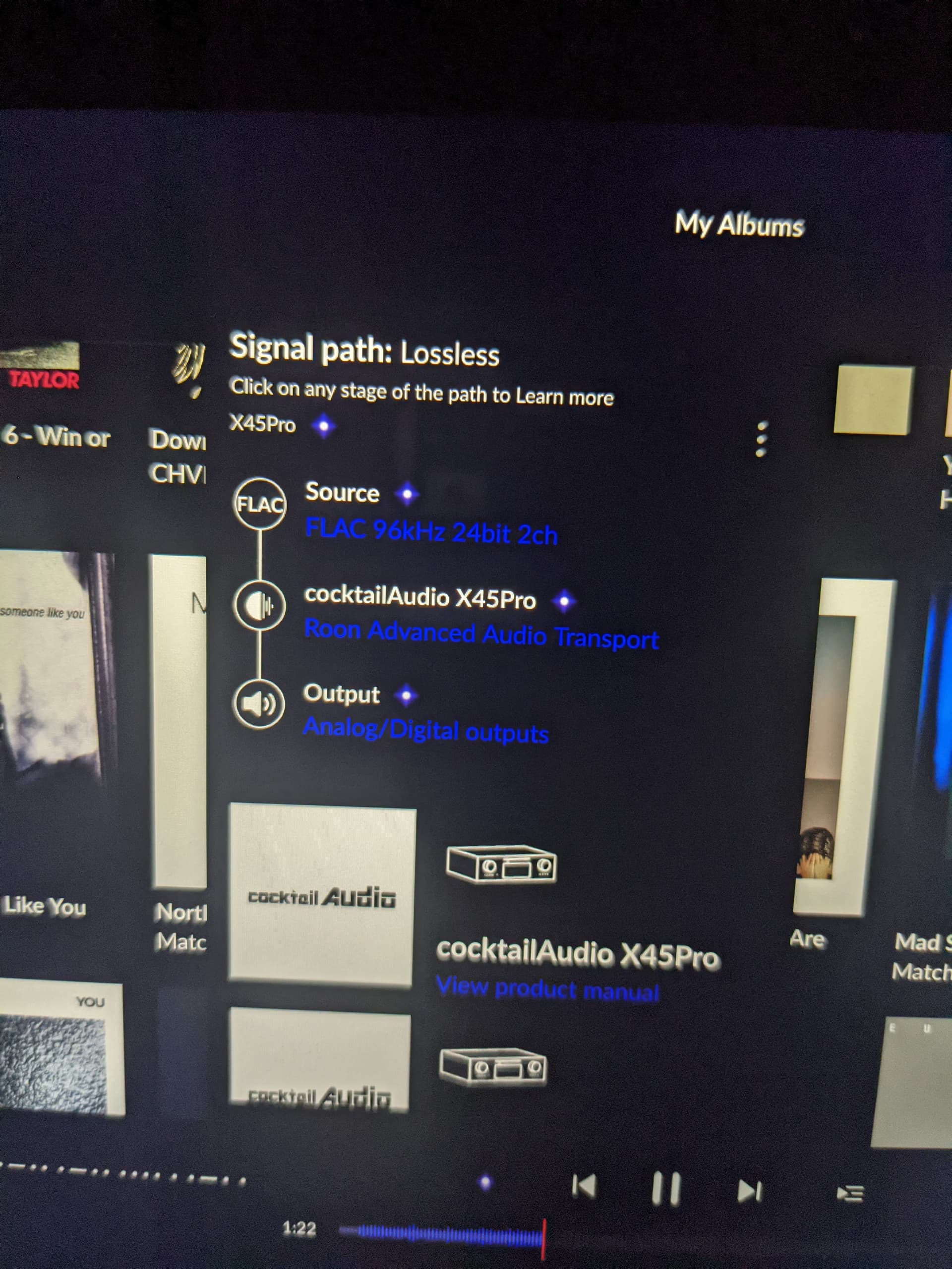

1Gb Ethernet connection
Devices are side by side into 1Gb switch
Cocktail Audio X45Pro
Library Size
30,000
There is an intermittent stuttering issue with streaming FLAC files from X45Pro.
The higher the resolution the more the frequent the issue occurs.
With playing the files locally on the X45Pro zero issues.
Problem does not occur playing WAV
No DSP settings or processing enabled.
