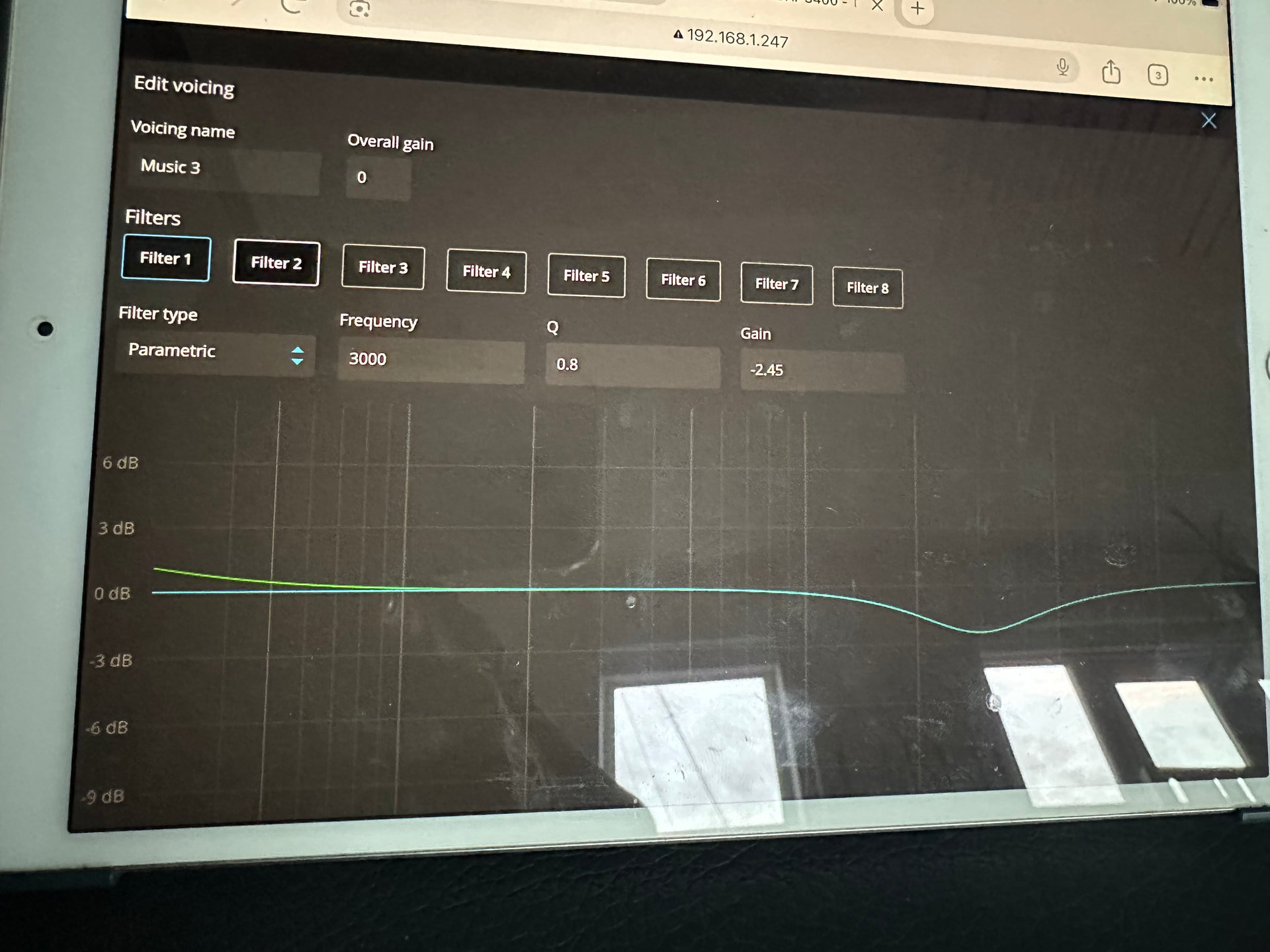

Hi Louis,
of course, Focal Utopias are utterly wonderful, that’s why we buy them :smiling_face_with_sunglasses:
I have the smaller Diablo, my friend has Scala, like you
We’ve settled on a curve centered on 3000hz
With a -2.45 gain snd a Q of 0.8
This knocks off sone of the harshness but leaves the air and detail
We do this in Lyngdorf amps, not sure how to do it in Roon, never needed to
While you’re down there (actress/bishop aside) I use a bass lift curve too..
20hz Q 0.5 Gain +3.5
thus gives a more realistic heft to kick drums etc, without getting at all bloaty
Phone doesn’t allow this screen in Lyngdorf software, so here’s a rather grubby photo of the iPad screen to give you a starting point
I’m now off to get the isopropyl to clean it
Thanks Andrew. I had considered the Lyngdorf Room Perfect room correction but still unsure I need it. The roon PEQ DSP is a great tool and allows you to do a lot. The “trick” is to carefully tailor the higher freq’s without losing what makes the speakers top end special. For me there are only certain tracks/recordings that need any adjustment. I also was able to tweak my room treatment to further tailor the sound. My low end sounds very good so no adjustment needed there. And your Diablo’s are some of the best stand mounts around. Thanks again.
