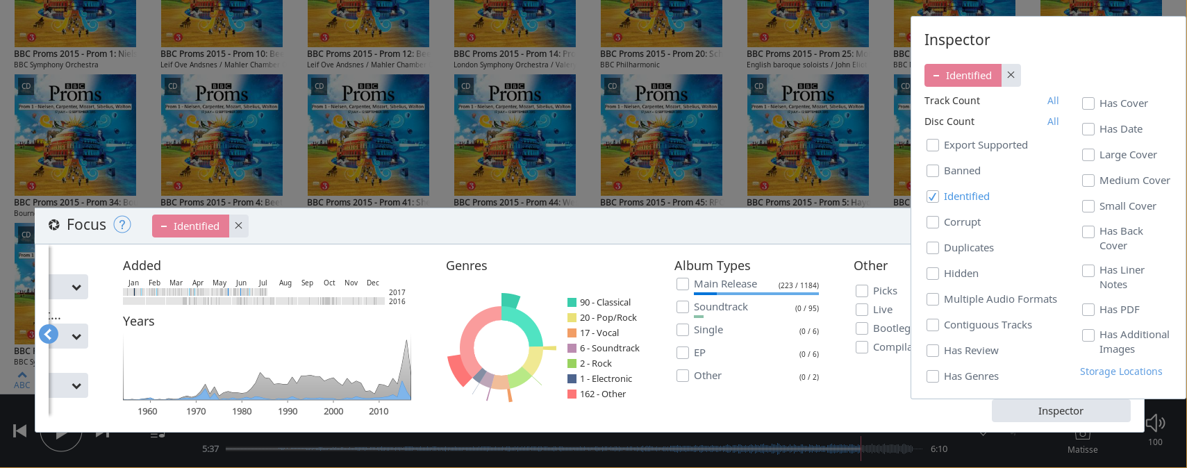

The Focus function had a completely different UI design (and software coding) in early versions of Roon, and then it was possible to invert Duplicates.
I suppose that Roon Labs thought that “not-duplicates” was not necessary to display in the re-design of Focus, since it is the same state as when “Duplicates” is not selected in the first place…
