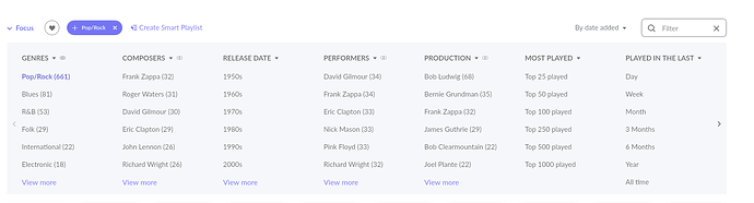

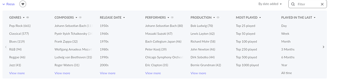

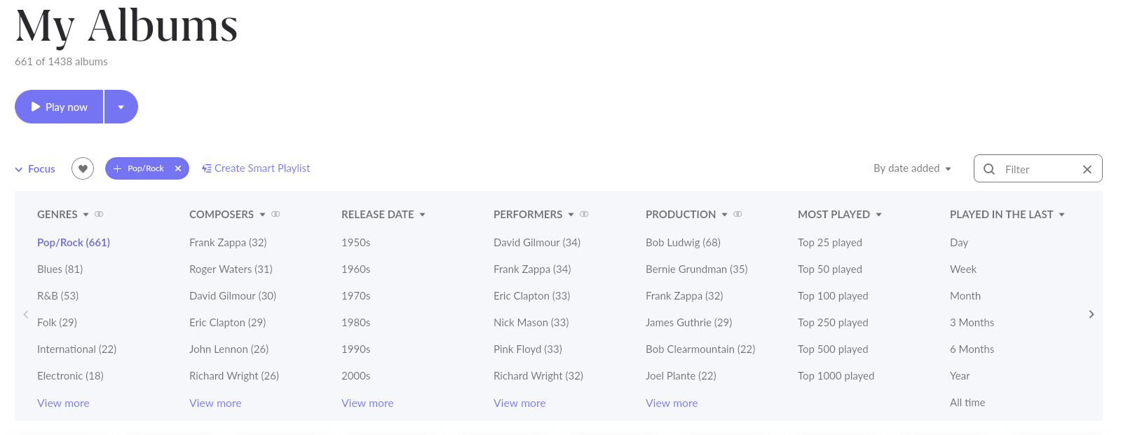

  1. the behavior is that Match Any behaves like Match All and that is wrong; Match Any should allow you to select multiple genres without one exluding the other but this is not the case; if I put it on ‘Match Any’ and I select .e.g Pop/Rock, then all non Pop/Rock genres disappear; the behavior is identical with what happens when put on ‘Match All’; this is simply wrong and VERY easy to test and reproduce
  2. when on Match Any, it should be not a problem to select Genres Blues and R&B at the same time; this is not possible however; as stated before Match Any and Match All behave EXACTLY the same way on the Genre Focus; I cannot e.g. select Blues and Rock at the same time; it will allow me to choose Blues, after I have selected Rock, but that will ONLY show me the albums that have BOTH Genres flagged
  3. read above, should be a no brainer to reproduce, put it on Match Any and Match All and see that the behaviour is identical; try it on anything else than Genre e.g. Composer and you’ll see that the behavior is not the same and works as it should
  4. no, so far I have only seen this behaviour on Focus- Genre; this is not album related, this is a 100% pure BUG and nothing else
