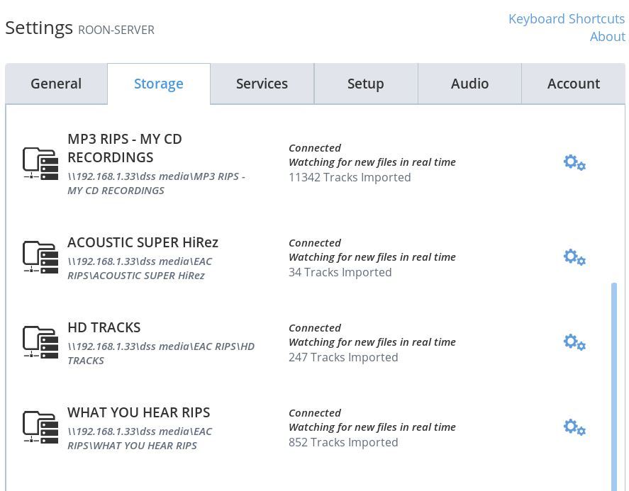

I have different folders of music on my Nas but I added only the folders that I wanted in the Storage Settings in Roon to see.
One folder (What You Hear Rips) was Wav singles and I also have it as a Bookmark. Now they will All show up in the Overview Section but you go strait to this folder with the Bookmark.

Best practice that I have found using a NAS is that I assign a Static IP address.
Once that is established you can access the NAS either thru the IP Address or the Name of the NAS that you assign to it - Example nasd3cbe7. From the NAS Control Panel, you can even change the name of the NAS to more friendly or easier name - example - MEADATA
I have found that using the static IP address for such programs as Roon or a Backup Solution is a better route to go.
Having said that, then from your laptop navigate via IP to access the NAS and then access the Shared folders that you desire. It might at this point require access credentials if what you say is a “Folder Permission” issue.
Once you are where you want to be, then copy the complete address and then paste into the Roon Watch folders with the credentials you assigned.
If Roon cannot access these folders, then again you are correct and it is a Folder Permission issue which from your NAS Control Panel is where you correct it…
