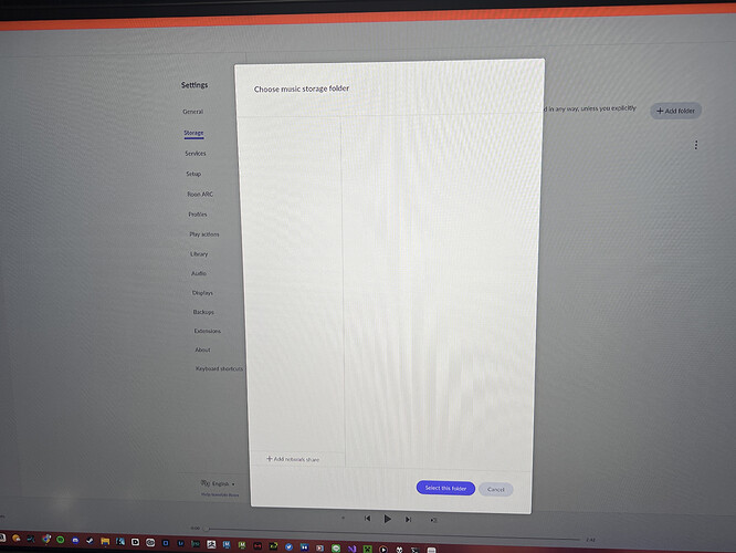

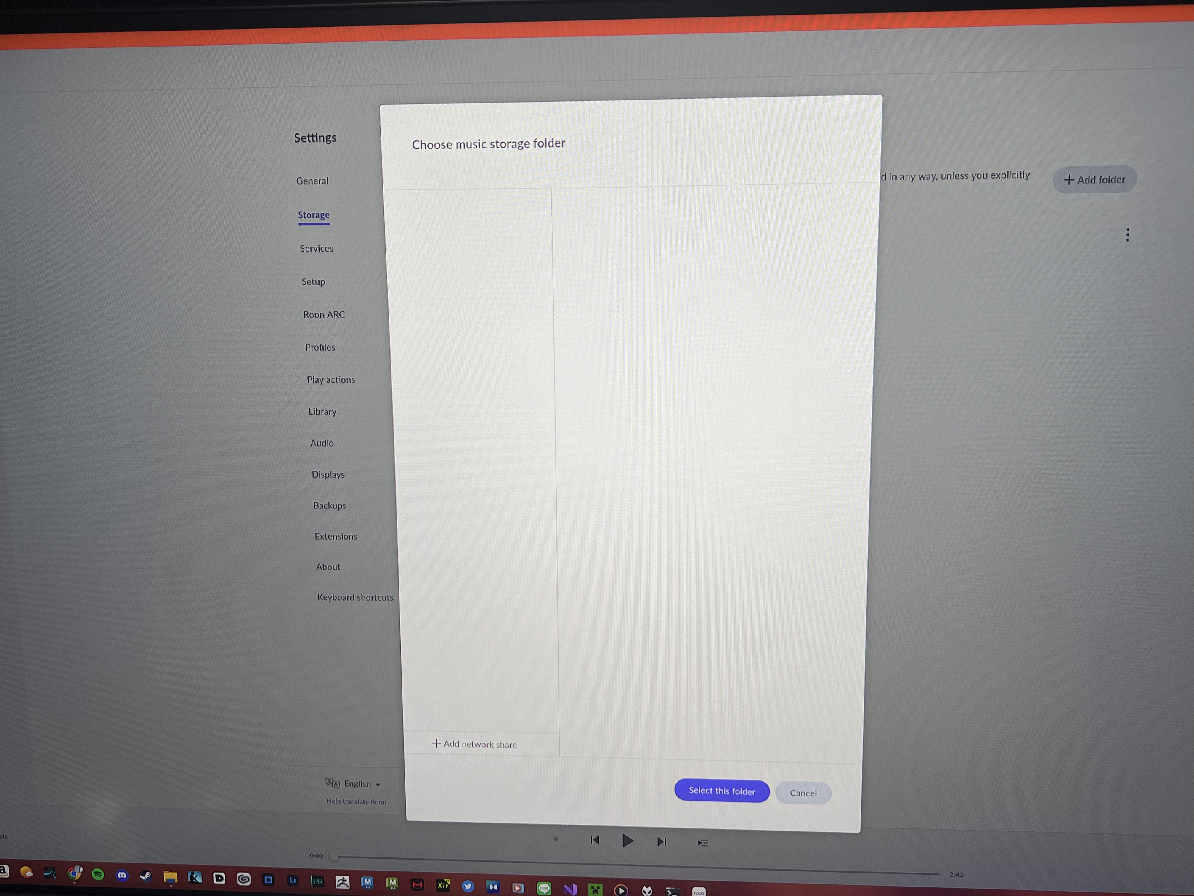

I have attached a 2.5” SSD to the ROON server to add CD sound sources, but the screen looks like this and does not show any folders on the control side or on the server side.

@daniel 2.5インチssdをusb変換で普段使っているwindowsにつなげてフォーマットしたところ接続、書き込みも問題なく行えました。roonの保存フォルダを選ぶ画面では他の方の動画などを見ると最初から何かしらは表示されているようなのでこれはroon側の問題なのではないかと思っています。
I connected the 2.5-inch SSD to the Windows I usually use via USB converter and formatted it, and I was able to connect and write to it without any problems. When I look at other people’s videos, it seems like something is displayed from the beginning on the screen where you select the Roon save folder, so I think this is a problem with Roon.

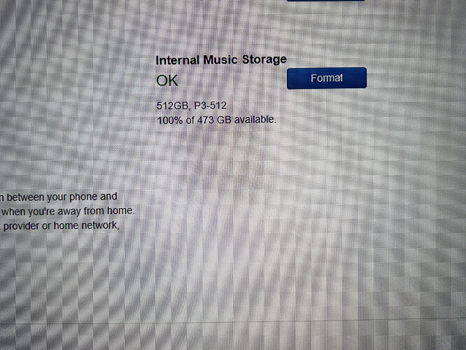

To use the SSD with Roon, you would need to format it from the Web UI menu. Do you see the drive show up there and do you have an option to format it?
こんにちは、@kakigori_5454 さん。
Roon で SSD を使用するには、Web UI メニューからフォーマットする必要があります。そこにドライブが表示されていますか?また、フォーマットするオプションはありますか?
SSDはweb UIですでにフォーマット済みです。
Hello @kakigori_5454,
If it’s a fully formatted drive, there is no folder structure.
Please try to move some music directly to the NUC drive using the following guide.
  1. Connect to Roon OS:
    Roon OS exposes a shared network folder called Data. You can access this SMB share by following the steps below:
  2. On Windows:
  • Open File Explorer > Network
  • If you see “ROCK”, double-click it
  • If not, type \\rock\data in the address bar (not the search box) and press Enter
  1. On Mac:
  • Open Finder > Go > Connect to Server
  • Enter smb://ROCK or smb://[IP Address of your ROCK]
    4.(do not include brackets)*
  1. If prompted for login:
  • Username: guest
  • Password: guest
  1. If you receive an authorization error: Let us know about it
  2. Once connected, you should see the Data directory. From there, open the Data folder and you should see your ‘Internal Music Storage’ folder - which is where you should see your external drive. You can drag and drop your music files into this drive/folder.

@vadim ありがとうございます。Dataが表示されました。
音源はどこに保存すればよいでしょうか?
新しくフォルダを作ればよいですか?
Hello @kakigori_5454.
You can create your own file structure, for example, you can create folders by artist and copy their albums or genres to them according to your needs.
In fact, you can even put files together without any structure, and Roon will still display the files in the app according to the file metadata.
