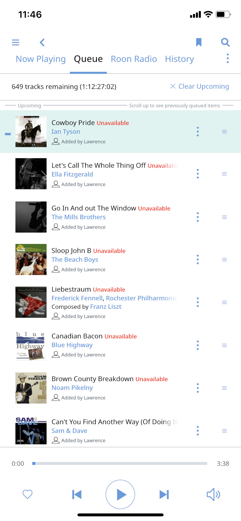

Thank you. Not long till first episode after restarting occurred at 7:28 on 11/27. Screenshot attached of last complete play. Drop occurred during Summer Wages by Ian Tyson
And here’s another drop 11/29 at about 7:28 am
Screenshot of selection included. Thanks
11:46 on 11/29 with screenshots. Won’t send more unless you need them
. Thanks!
