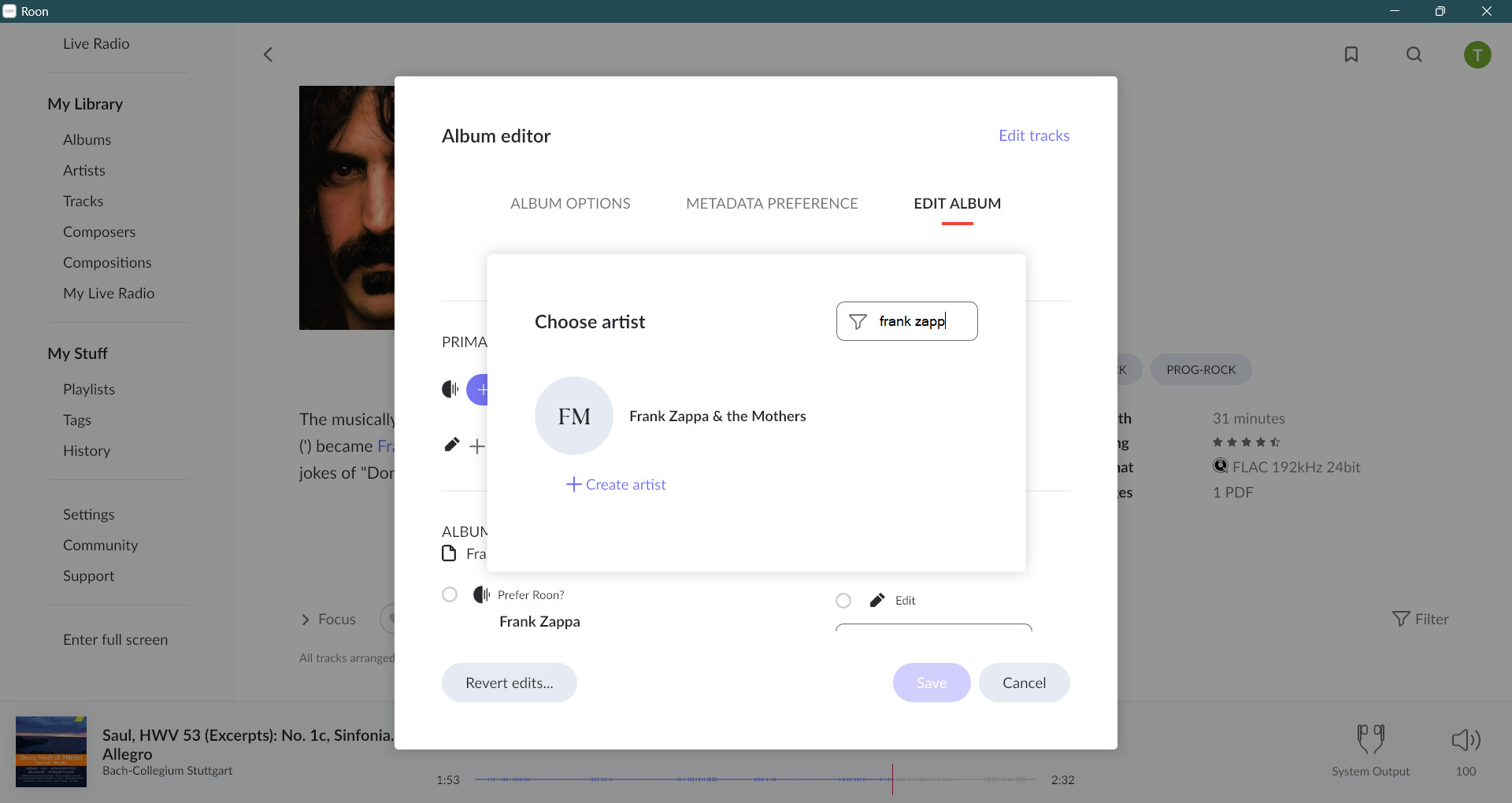

Hi @Ralf_Karpa. Is it possible that somehow your Frank Zappa artist and your Mothers of Invention artist have been merged? It’s a bit of a long shot but I can reproduce exactly what you describe by merging these two artists.
This I think this the situation you started with:
If I then merge Frank Zappa into The Mothers of Invention then I get this.
Also what happens is that Frank Zappa is now “gone” if I try to add him back in:
All that roon offers is “Frank Zappa & the Mothers”. In fact in my roon I am offered no less than 7 Qobuz “Frank Zappa & the Mothers” albums quite distinct from any Frank Zappa & the Mothers of Invention albums. Maybe there are more on Tidal.
If I go to Settings → Library → Un-merge artists, then I can unmerge “Frank Zappa” and “The Mothers of Invention” and everything goes back to normal. Does this work for you? If it does I do not know why Frank Zappa and the Mothers of Invention were merged.
