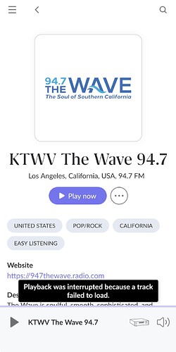

Hi,
I just tried it. When I click on “Play now”, this message usually appears and there is no connectivity. It appeared this time as well.
Then I click once again on “Play now”, I get a connection after about 20 seconds, and it cuts out after about two minutes. This is frequently what happens.

It happened at 9:17am, and connection was lost at 9:19am
