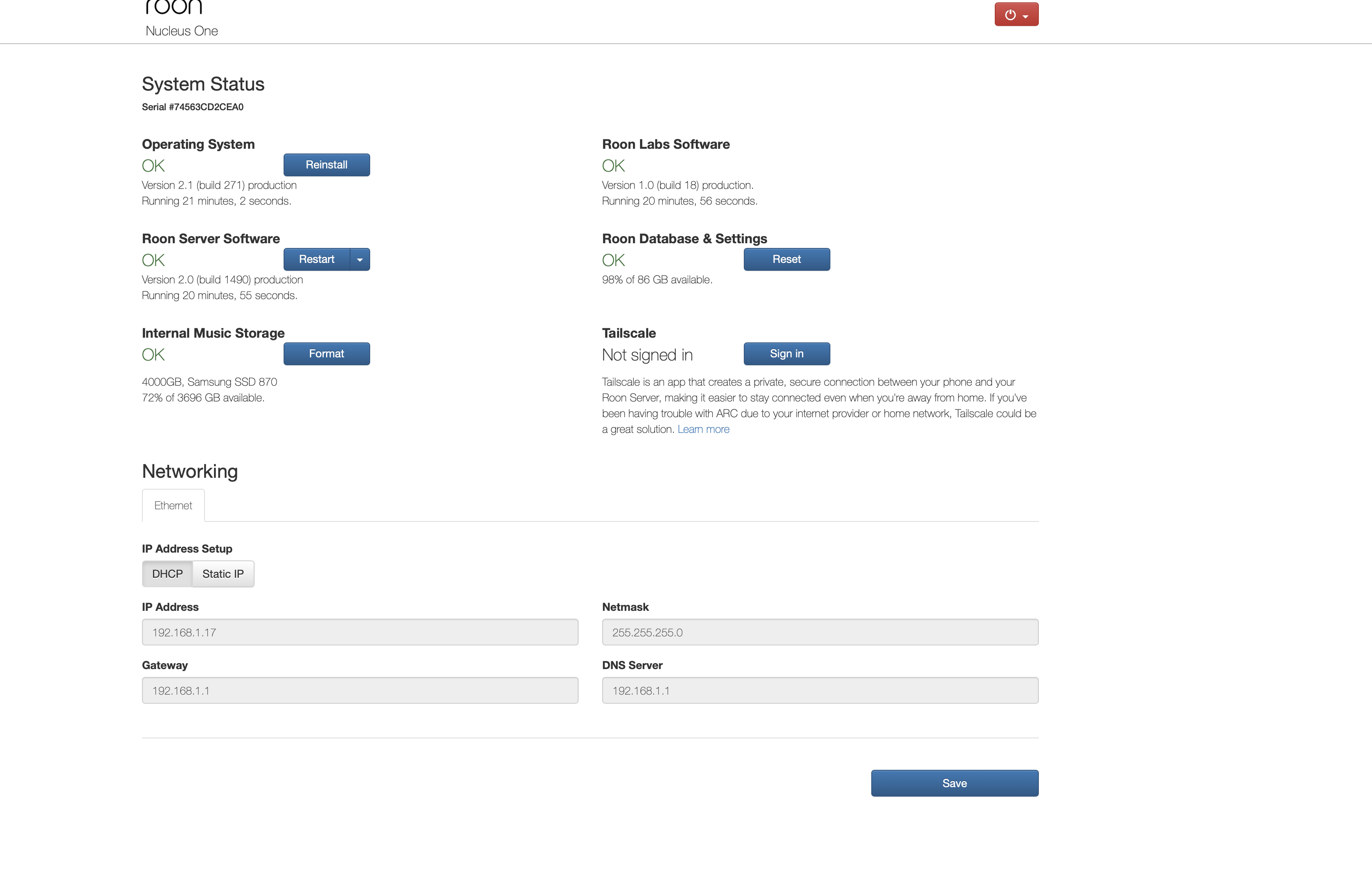

Hi, I am not restarting it intentionally. It did not appear today, so I wound up rebooting the whole network. It finally reappeared. I think we had a minor black out or brown out, since I noticed a few devices did not appear. This happens rarely, 3-4 times a year. Here is a screenshot of the admin interface. I just checked and it is still running after 35 minutes.
I don’t have such reboots on any other device, so this is rather inexplicable to me.
Still going over 8 hours later. Not sure why.
