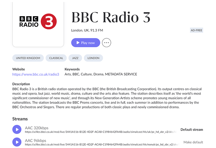

Please post the a screen shot of the station you are seeing the issue with and make sure to indicate which stream (URL) you are using.
Thanks! Here’s the screenshot:
I use the 320kbps stream. Unfortunately I can’t see the whole URL and can’t seem to see a way to get at it. I haven’t changed anything about this radio station - it’s just as it appeared when I searched for it. As it’s a BBC station, I feel I can assume the problem doesn’t lie with them (and I can tune in to the station and listen with no problems on a Roberts internet radio I have, although there’s no way to see what stream URL that is using unfortunately).
