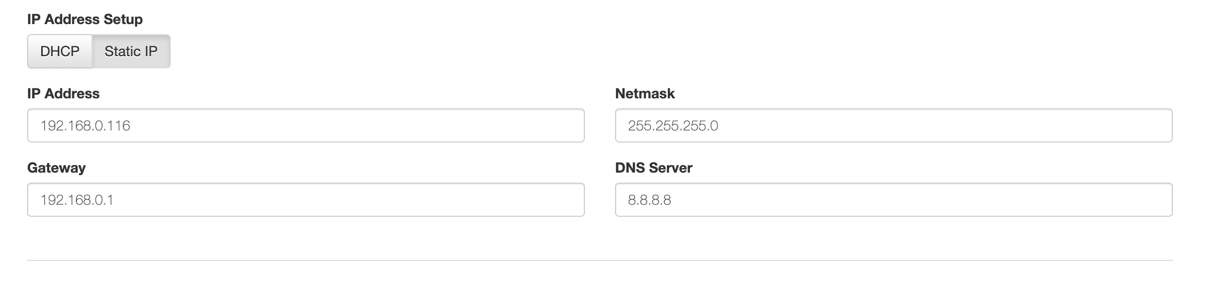

One thing worth trying on your end: change the DNS server on your router (or set it directly on the Nucleus if your router allows per-device DNS) to a public resolver such as 1.1.1.1 (Cloudflare) or 8.8.8.8 (Google).
Here’s a step-by-step on how to change the DNS settings on your Nucleus:
Open a web browser on a device connected to the same network as your Nucleus.
  1. Enter the IP address of your Nucleus in the address bar.
  • If you don’t know the IP address:
    • Open the Roon app.
    • Go to Settings > Setup > Find Nucleus.
    • Note the IP address shown for the Nucleus.
  • Alternatively, use http://nucleus.local/ (on macOS or Windows with Bonjour installed).
  • Log into the Web Interface:
  1. Once the web page loads, you’ll see the Nucleus web administration interface.
  • Change the DNS Settings:
  • Scroll down to the Networking section.
  • If the Nucleus is using DHCP:
    • Note that you cannot directly edit DNS settings under DHCP. You will need to switch to a static IP to specify custom DNS servers.
  1. Switch to a Static IP:
  • Click on the Configure or Edit option under networking.
  • Enter the current network settings for your Nucleus (IP address, subnet mask, gateway) manually. These can often be found in your router’s settings or your current DHCP lease information.
  • Specify Custom DNS Servers:
    • Add DNS servers in the relevant fields. Common choices:
      • Google DNS: 8.8.8.8 and 8.8.4.4
      • Cloudflare DNS: 1.1.1.1 and 1.0.0.1
      • OpenDNS: 208.67.222.222 and 208.67.220.220
  • Save and Apply Changes:
  • Click Save or Apply to confirm your new settings.
Restart the Nucleus (make sure Roon Server is stopped) and let me know if you continue to experience stoppages when streaming
