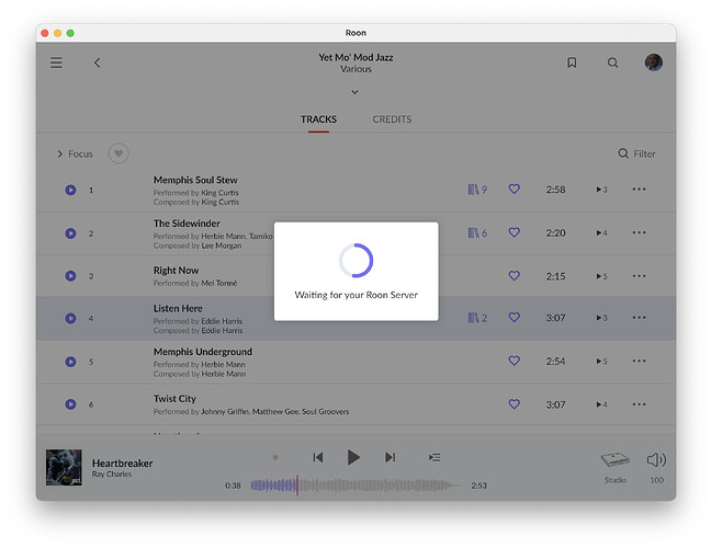

Frequent music stop playing: Waiting for Roon Server

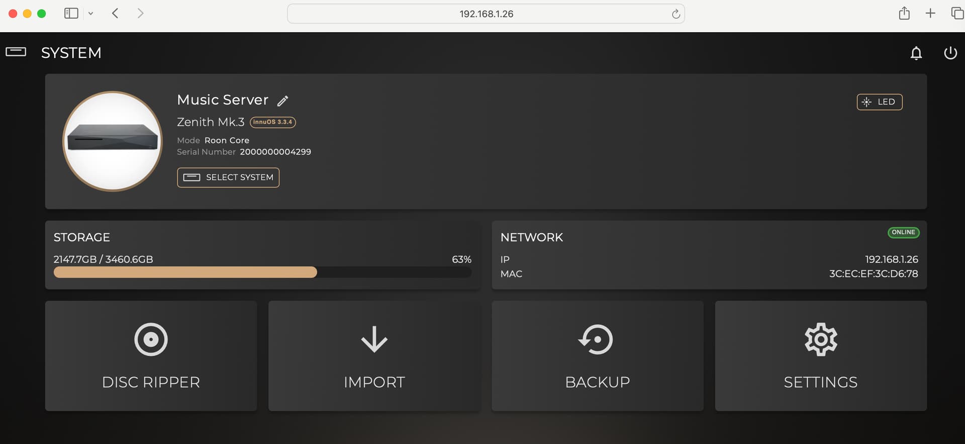

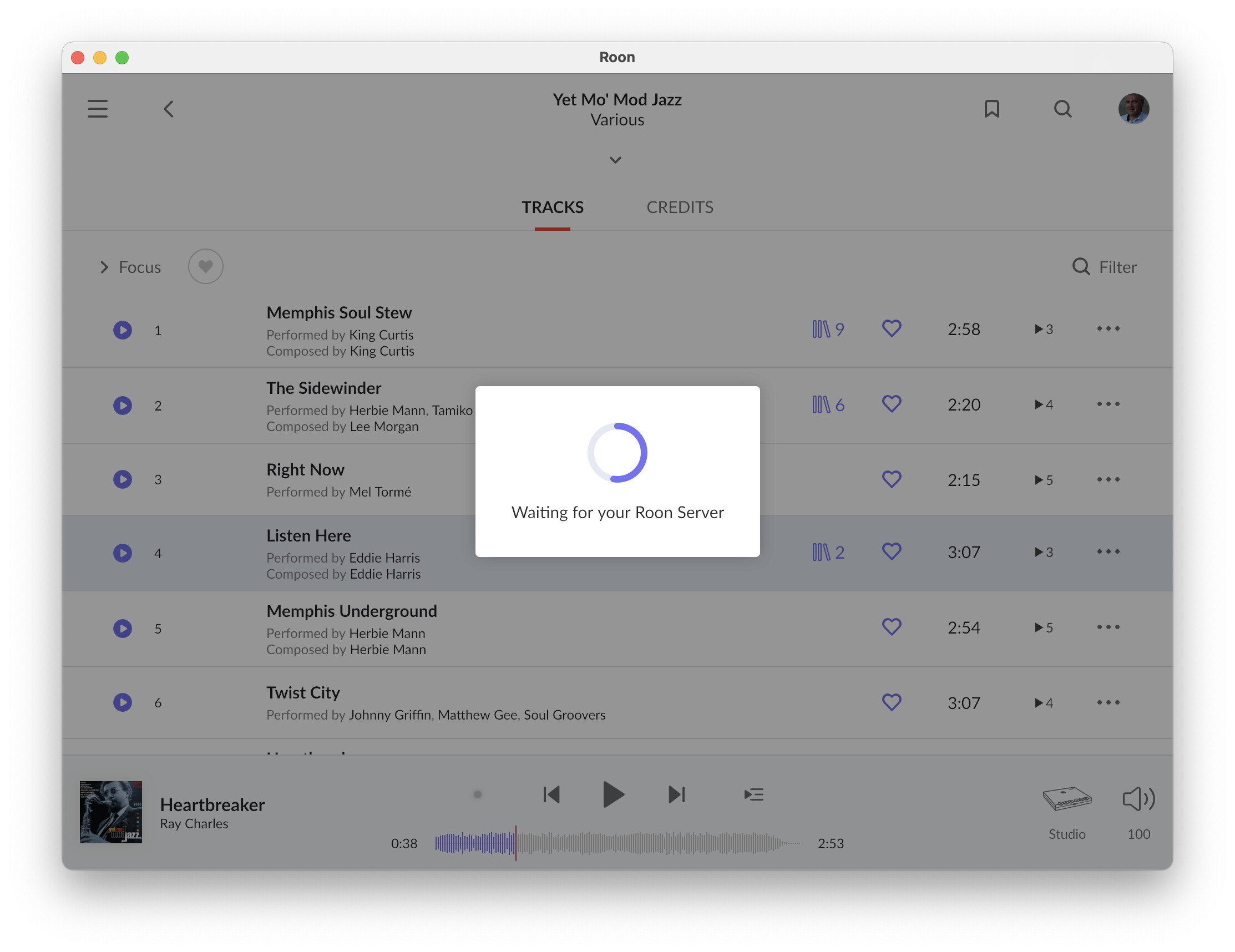

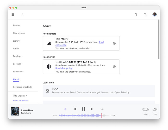

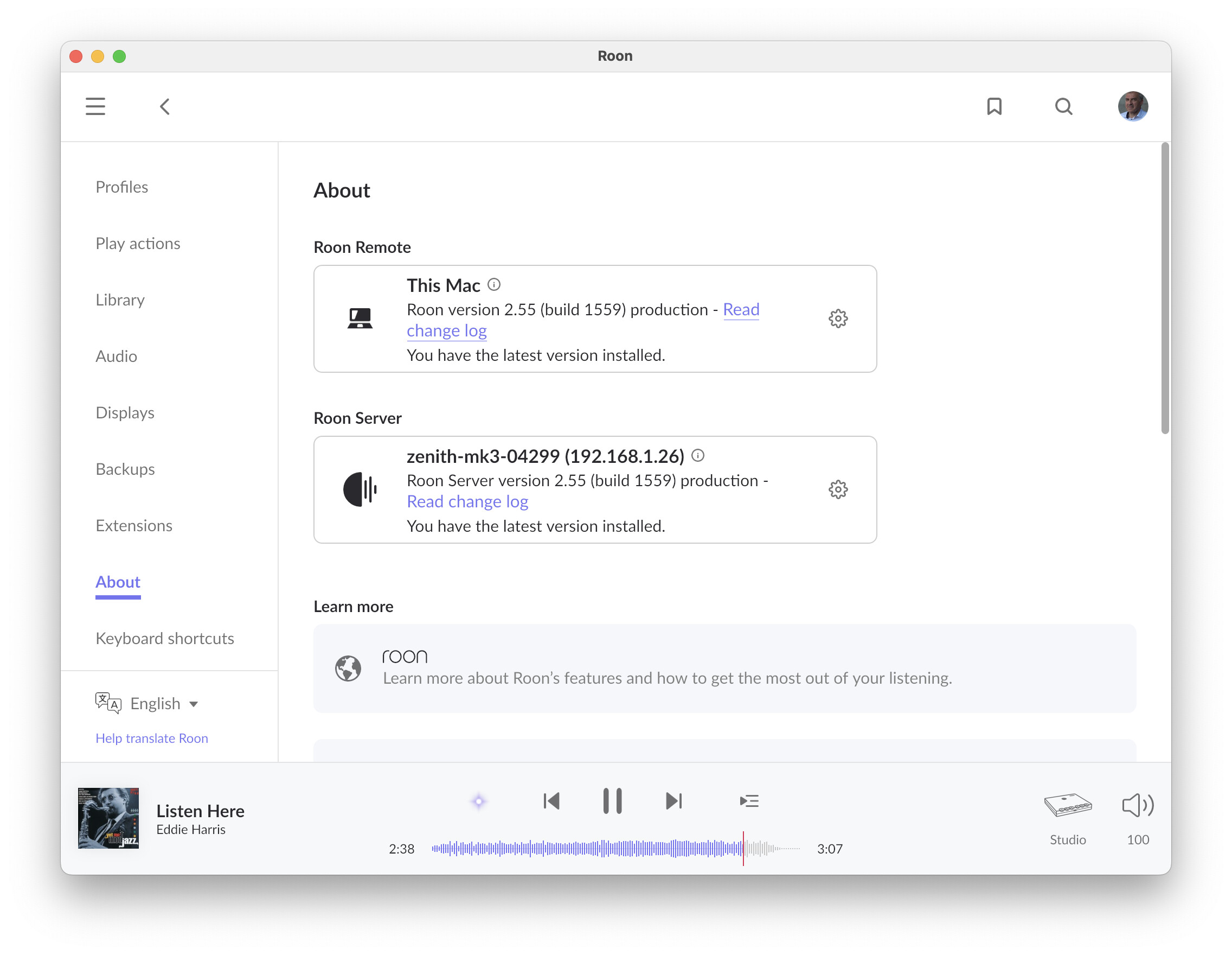

Roon Core installed on Innuos Zenith Mk3 (versions on screen shots attached). Use MacBook Air MacOS Sequoia 15.7.1 or IPhone SE.

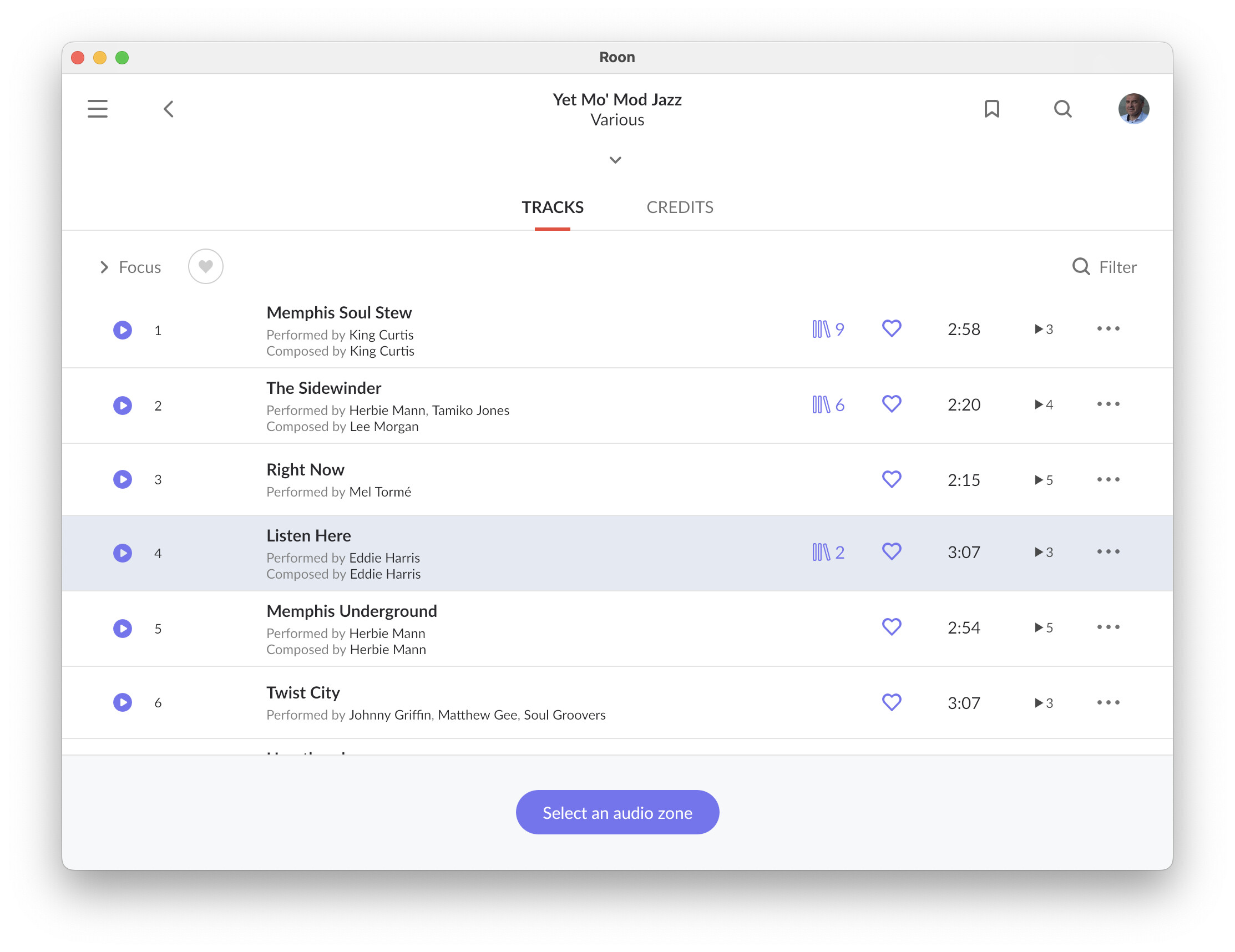

Playing music stops frequent*: Error message: Waiting For Your Roon Server or Select an Audio Zone.
*± every 2 minutes (less than 1 song).

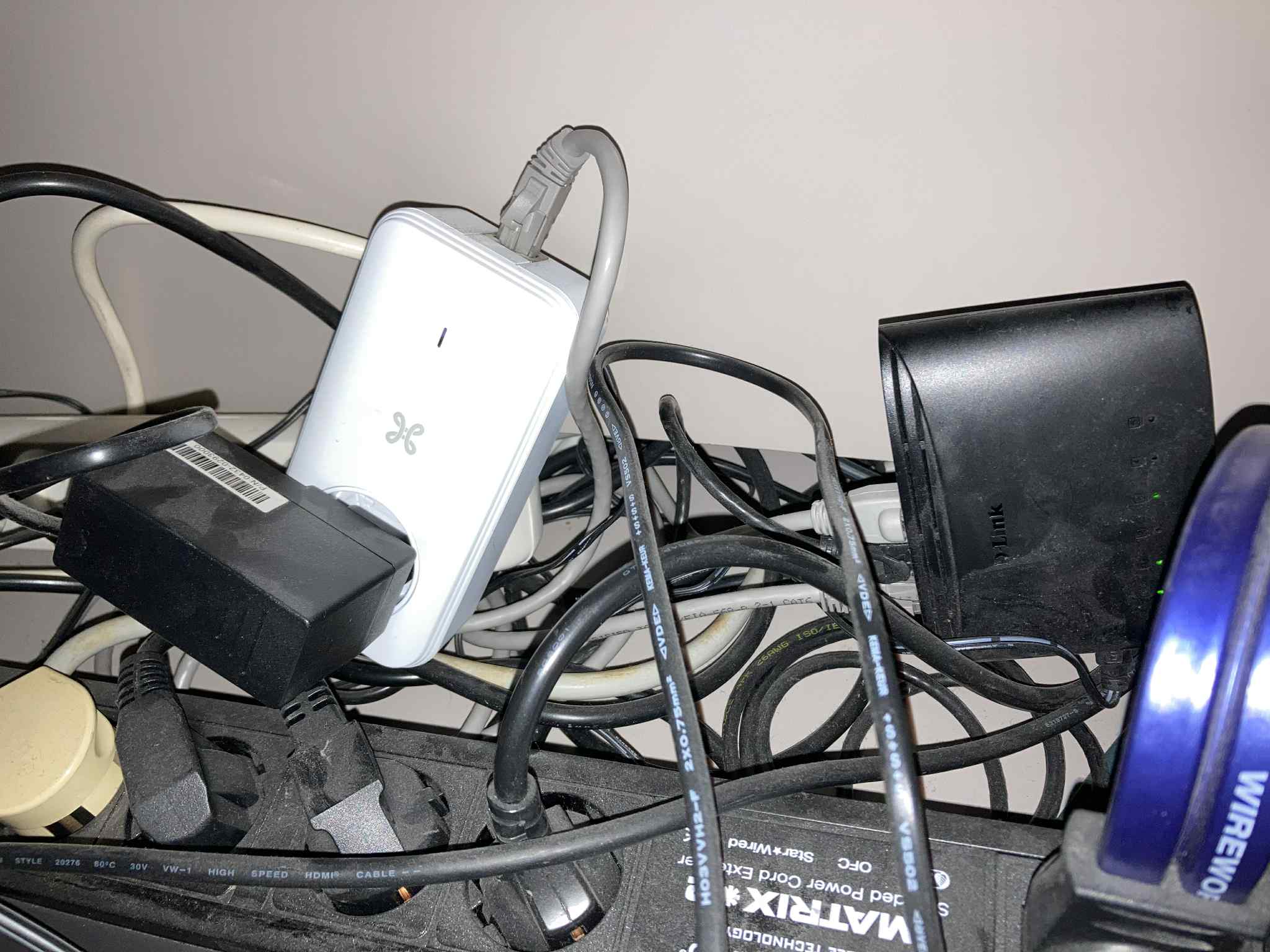

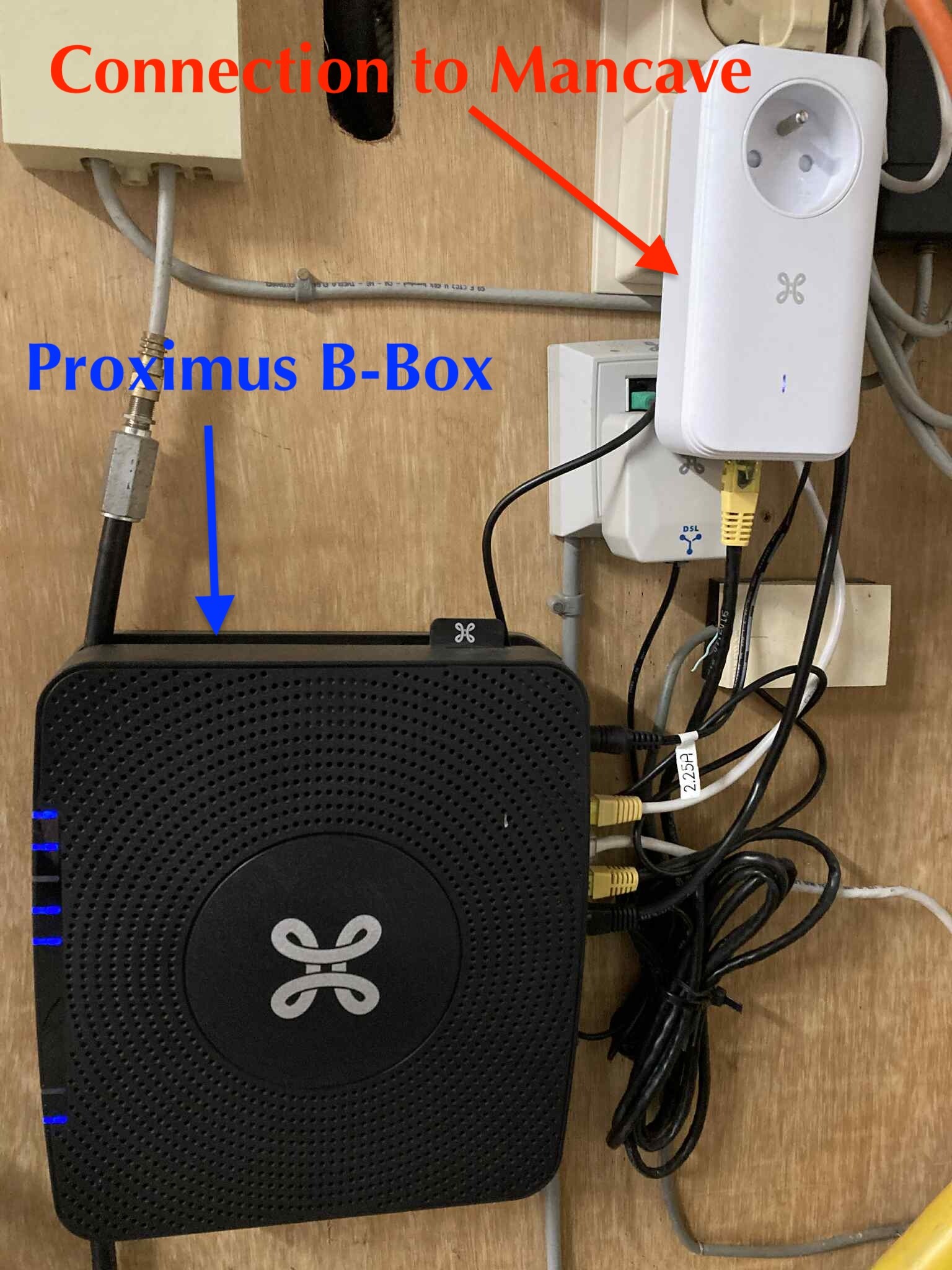

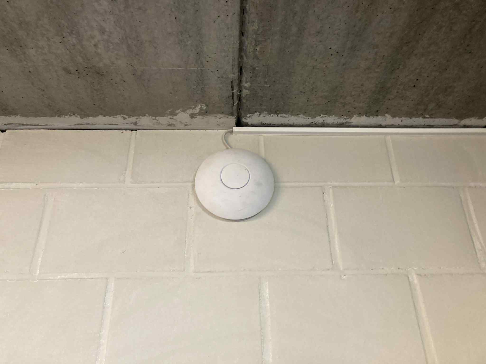

Your questions exceed my IT knowledge but I’ll try my best. See pictures attached.
In the garage I have the Proximus B-Box where internet comes in. In the house I have 2 wifi routers and 1 connection over the electricity cables. In the mancave I have the same on the receiving end. My Macbook connects to whatever is closest. This set up has not changed since the initial install 4 years ago.

I replaced both PLC’s and this seems to solve the problem. FYI I noticed the PLC’s flicked between “blue” and “red”, the one in the garage is accessible but not looked at, the one in the mancave is obstructed by too much stuff (flatscreen, a cable mountain…) so I could not compare to previously. I will ask for advice how to make I can play music even if everything drops out except electricty of course. I was the opinion that once started Roon should play the entire album/playlist since the internet has nothing to do with it.

Additional side note, we do not recommend using the powerline adapters accordingly to our network best practices described here.
