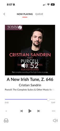

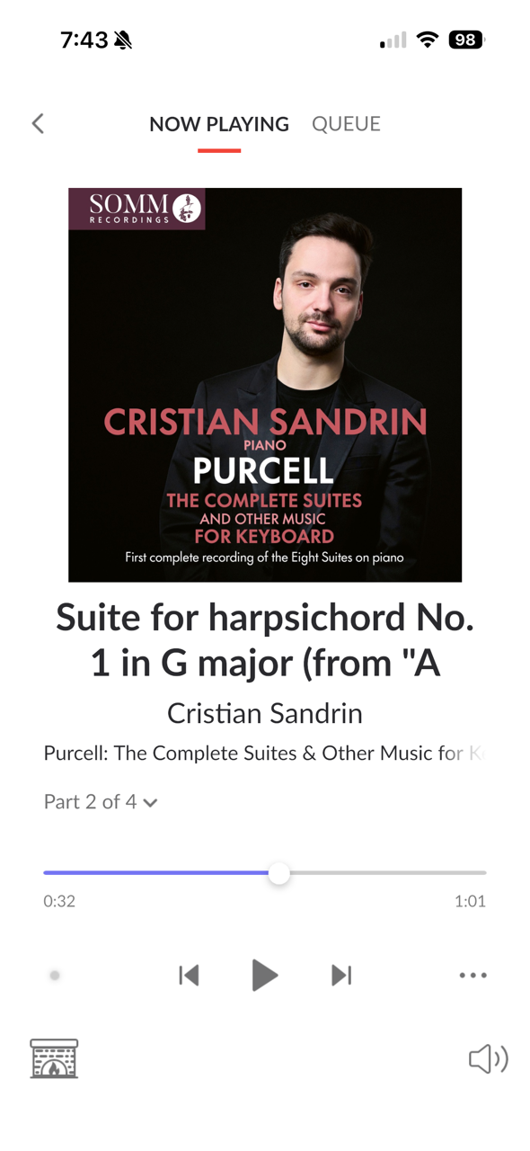

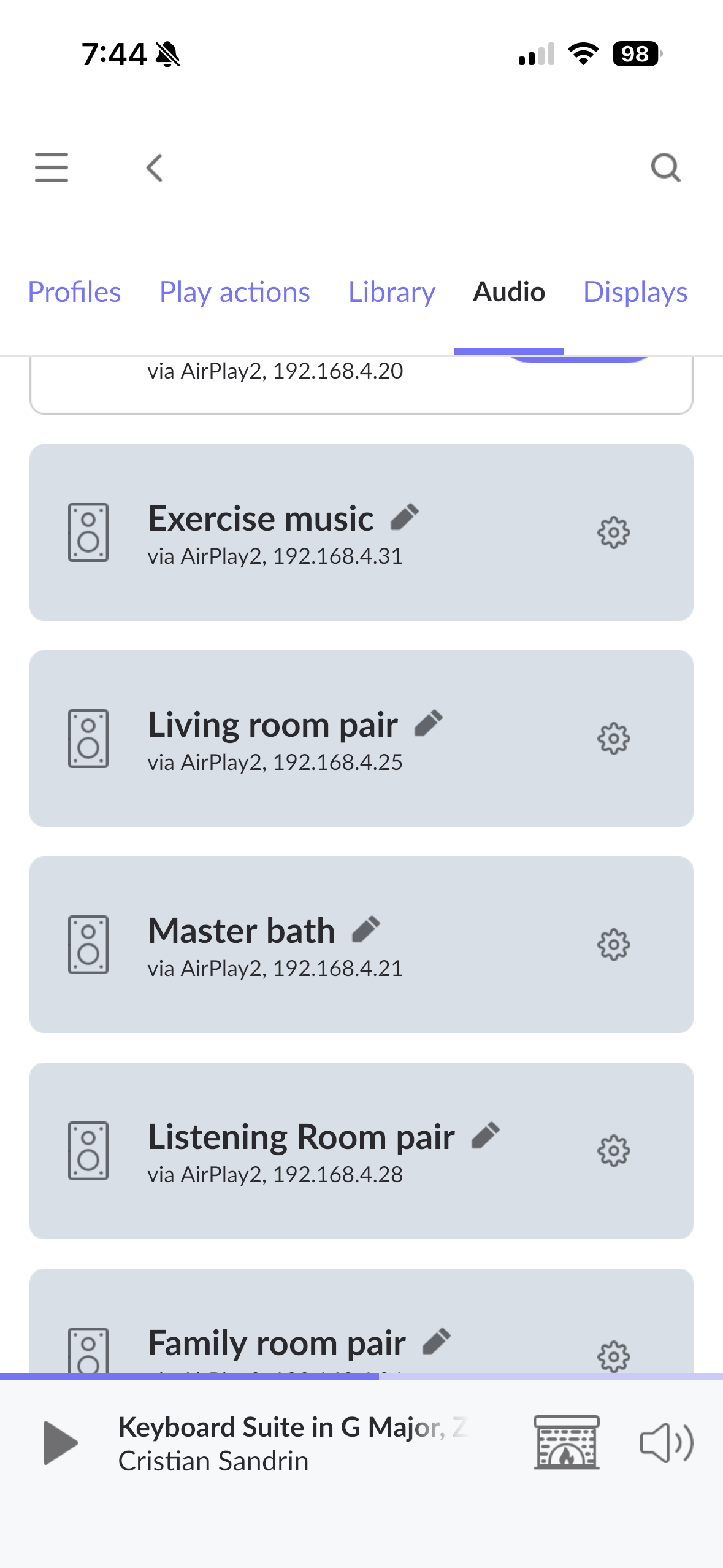

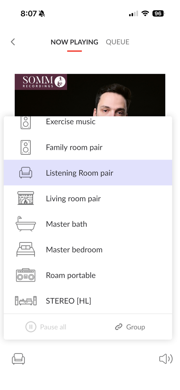

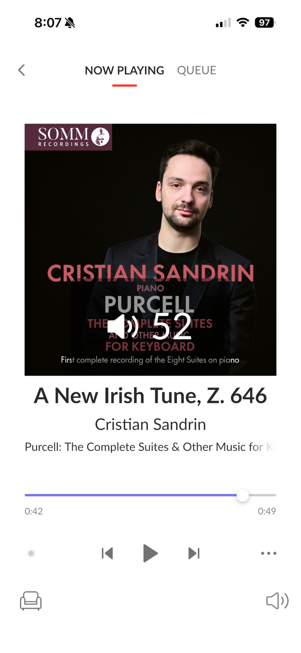

Here’s a sample failure playting to “Living Room Pai” about 1 min after starting this album. Playback stopped. No significant other network activity at the time Playing to one Sonos stereo pair (Sonos One) Additional info forthcoming in 2nd note – same behavior but Ropeee zone kept playing without difficulty while failure occurred.
Good morning, again, Vadim
Here’s another failure on a separate zone that is adjacent to the primary Eero where wireless Internet speeds of 500 mbps are the rule.

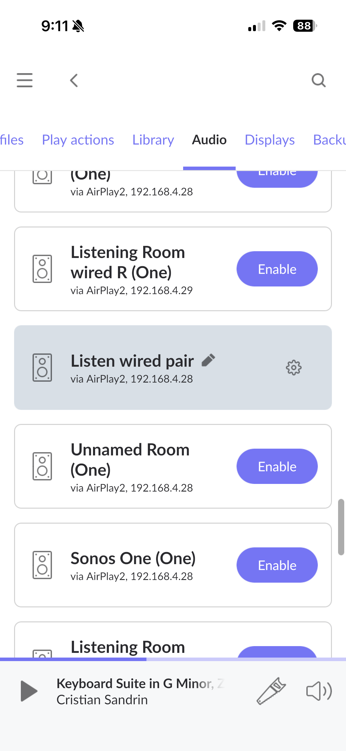

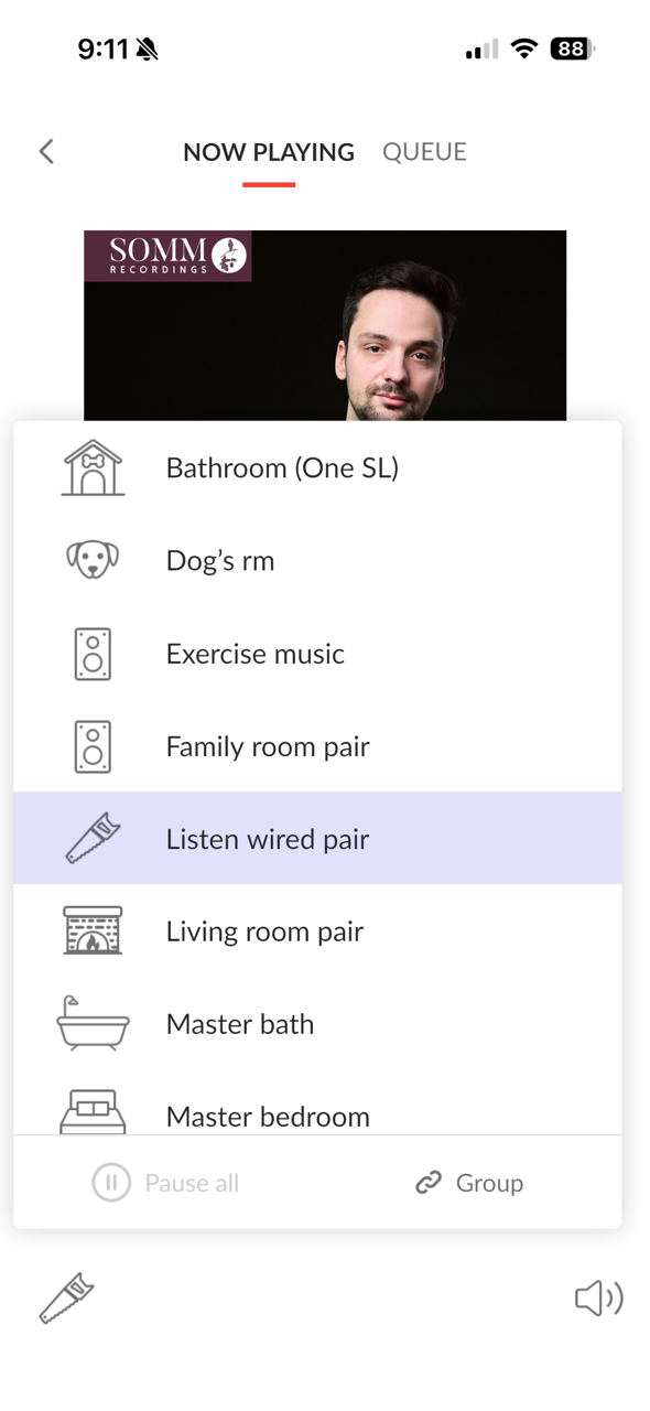

I’ve set up a wired Sonos pair and at approx 9:09 another failure of playback. Sonos shows that it’s connected directly to router and Sonos plays without pause.
I have switched to SonosNet with one wired set of speakers. Solved the problem instantly. I was fearful that I would lose access to AirPlay, but that is still available. Though I did have long-term stability with AirPlay2 for playback of one feed simultaneously to 1-2 zones, more than that was unstable. Now, five zones play the same music, no problem.
