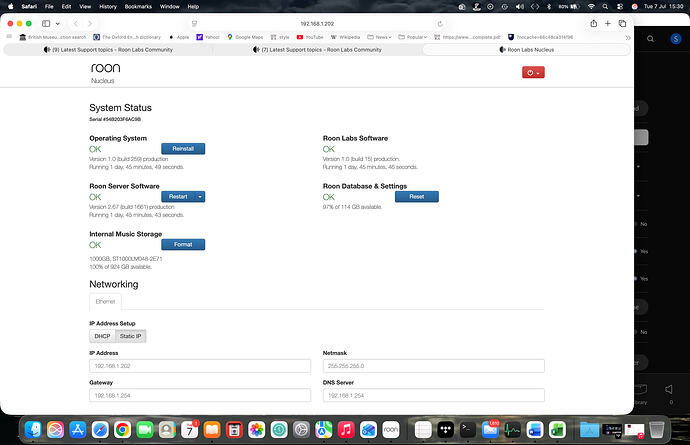

You mentioned the Nucleus is connected via ethernet to your BT Home Hub 2. Do you have any other network equipment in this setup? What about second routers, access points, mesh nodes, or managed switches in this network?
What do you see in the Nucleus web administration page? You can access this from Safari, Chrome, or any browser on your iPads/computers on the same network. Please share a screenshot here.
We’ll follow up with clear next steps from there once we’re able to diagnose the blockage here. Thank you!

I have an add on booster disc which is connected by wifi next to my tv ( it stops drop out of my sky tv system). nothing else.I attached a screenshot as requested.

The iOS devices (the iPhones and iPads) have a built-in privacy setting that can inadvertently render them invisible to the Nucleus every time they reconnect to the WiFi after powering off or leaving the house. On the iPads/iPhones, to Settings > Wi-Fi, tap the “Info” (i) button next to your WiFi network. Tap Private Wi-Fi Address and select “Fixed” instead of “Rotating.”
From there, restart the Roon Server Software from the web admin page you just shared in your screenshot, and then close and open the Roon app on your phones/iPads.

The good news first: there is nothing wrong with your Nucleus itself. The hardware is healthy, your music database is fine, and the network cable to it is running at full speed with no dropouts. So this is fixable, and it’s not a fault with the Nucleus you’d need to replace.
Here’s what the logs show. Your Nucleus and your remotes and streamer need to be on the same subnet, the same local network range, so they can talk to each other directly.
Instead, your Nucleus is sitting on a different subnet from all your other devices: the Nucleus is on one network range, while your iPads, iPhones and Naim streamer are on another.
It can still reach the internet from there, which is why Roon ARC works when you’re out and about, but it can’t reliably see your other devices at home. That mismatch is exactly what produces “waiting for server” and “uh oh,” why it gets worse when a second device joins, and why a reboot only helps for a little while before it slips back. It also explains why typing in the IP address works only sometimes.

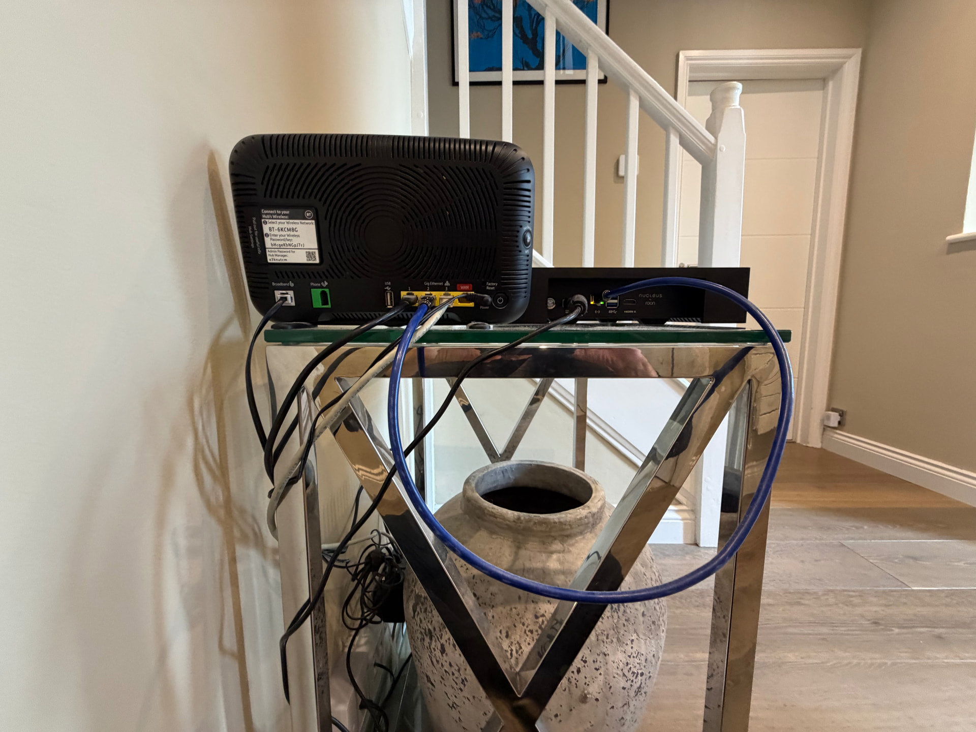

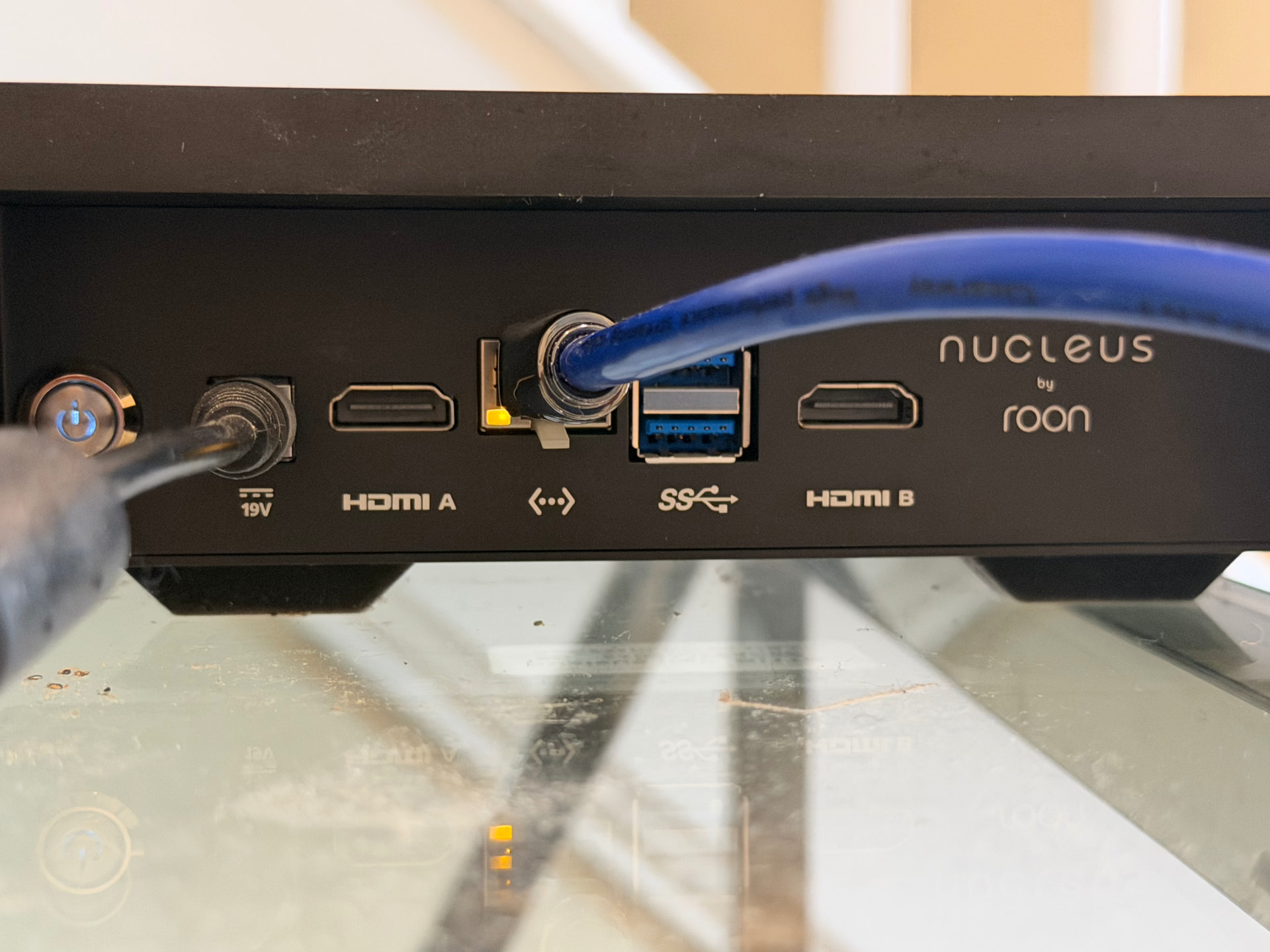

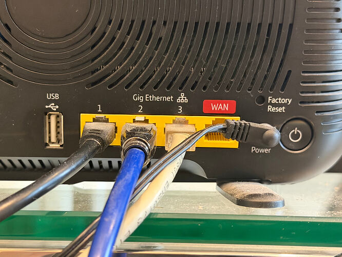

The most likely reason for this is that little booster disc you mentioned. If your Nucleus’s network cable runs into the booster (or into anything other than your main BT Home Hub), the booster can put the Nucleus onto its own separate subnet, which is what we’re seeing.
So before we change any settings, could you help me with one simple check? Follow the network cable plugged into the back of your Nucleus and tell me exactly what the other end plugs into, the main BT Home Hub, the booster disc, or something else.
A quick photo of both ends is perfect if that’s easier. That single answer will tell us whether this is a two-minute cable move.
The likely fix will be to plug the Nucleus straight into your main BT Home Hub (the same one your Naim streamer uses), so everything is back on the same subnet. I’ll walk you through it step by step once you’ve confirmed what it’s currently connected to.
We’re close on this one. Talk soon. :folded_hands:
Hello - thanks for getting back to me. I’m both encouraged and a little puzzled by your latest findings.
Just to ground things initially, my issues with connectivity remain the same albeit there has been a slight improvement since the lates release of the roon/roonarc apps. I find it odd that I can be at home and 80% of the time I can connect to roon arc instantly when I cannot connect to roon. 20% of the time however even roon arc requires a nucleus reboot.
I’m a little confused by your references to my booster disc. At your request over a week ago I removed it from my domestic system ( it was connected via ethernet to my sky Q box). Nothing detrimental seems to have happened elsewhere.
My nucleus has always been directly connected to my router ever since I first got my nucleus and my naim streamer has also been directly connected to my router since I acquired it about 5 years ago. I attach some photos to show my connections.
It seems therefore that I have always has the connectivity that you are suggesting as a solution and that since last week I do not have any interference from a booster disc. Am I missing something obvious ?
