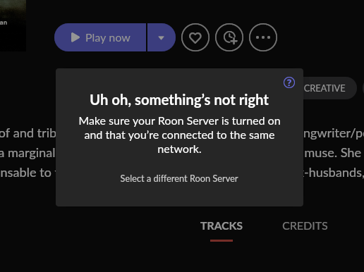

Frequent Roon Server Connection Drops on Home Network (ref#KVYDNM)
· Roon server frequently drops connection on home network
· Verizon FIOS Gateway router. All connections are wifi. Roon Server is running on a Geekom NUC running Windows 11; there is no other software installed on this device. Control devices: Windows 11 laptop & Android 16 (Samsung) phone.

Wifi connection to each machine (roon server, laptop, & cell phone) is stable and consistent, the problem seems to be that they just stop talking to each other. The connection usually comes back after a few seconds, or at worst a restart of the remote device.
The drops most often occur when playback is paused or idle, but when they happen during playback Roon does stop playing.

Actually, in the course of troubleshooting I think I answered my own question. I adjusted Windows power settings on the roon server so it would stay awake for your diagnostics, and upon turning off power saving mode and switching power settings to “balanced” it hasn’t happened in several days. I think perhaps Windows was droppping the connection to save power, or something like that. Thank you for your replies. :slight_smile:
