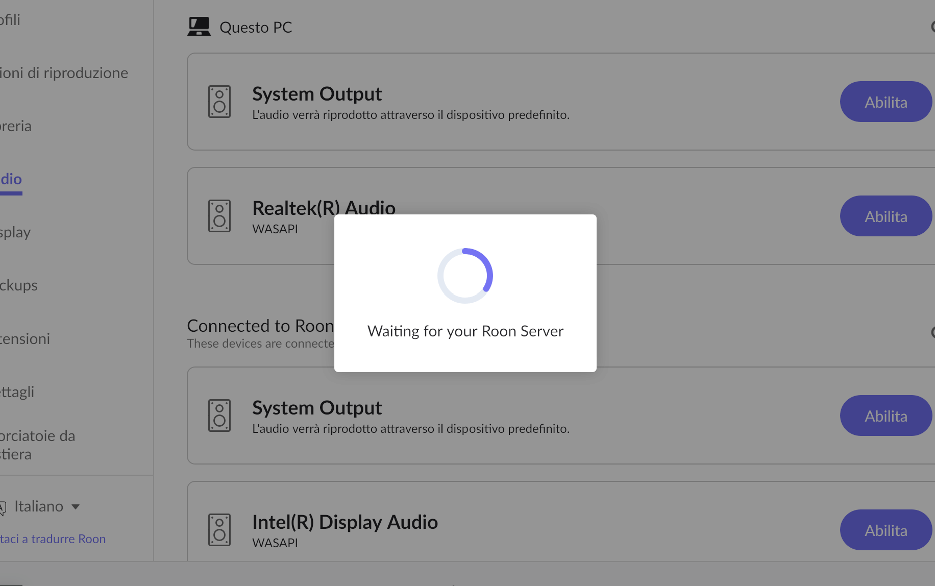

Hi there! My Naim Uniti Nova and Atom are both on the same subnet network, connected to a Windows 11 PC with Roon server. Since over 6 months the Roon app (Android phone or PC) is getting lags and when restarting (Roon server not found is often the error msg I get) the audio zones are lost, particulary the 'roon ready' but also less frequently the Chromecast one. When the Audio Zones are back again, I'm very often getting a msg with 'waiting for your Roon server' or simply the music selected via one audiozone is stopping. That's quite ennoyng and I'm really not more able to use Roon as I was used to do...
I have a home network, partially cabled with Google Nest pro as router, both Naim and one Sonos are all wifi 6 connected. I've suspended the Roon server PC windows firewall and also the NordVPN, without any result
Hello @Marco_Piattelli ,
Thanks for reaching out. Can you please let us know the exact local time + date when you next observe this issue occur on your end?
Can you confirm where your Roon Server is connected in this setup? I noticed that your Roon Server appears to be getting multiple IP addresses, including a “NordLynx” interface. When you disable your VPN, do you also make sure to disable NordLynx?
