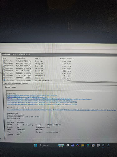

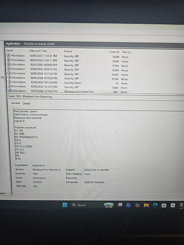

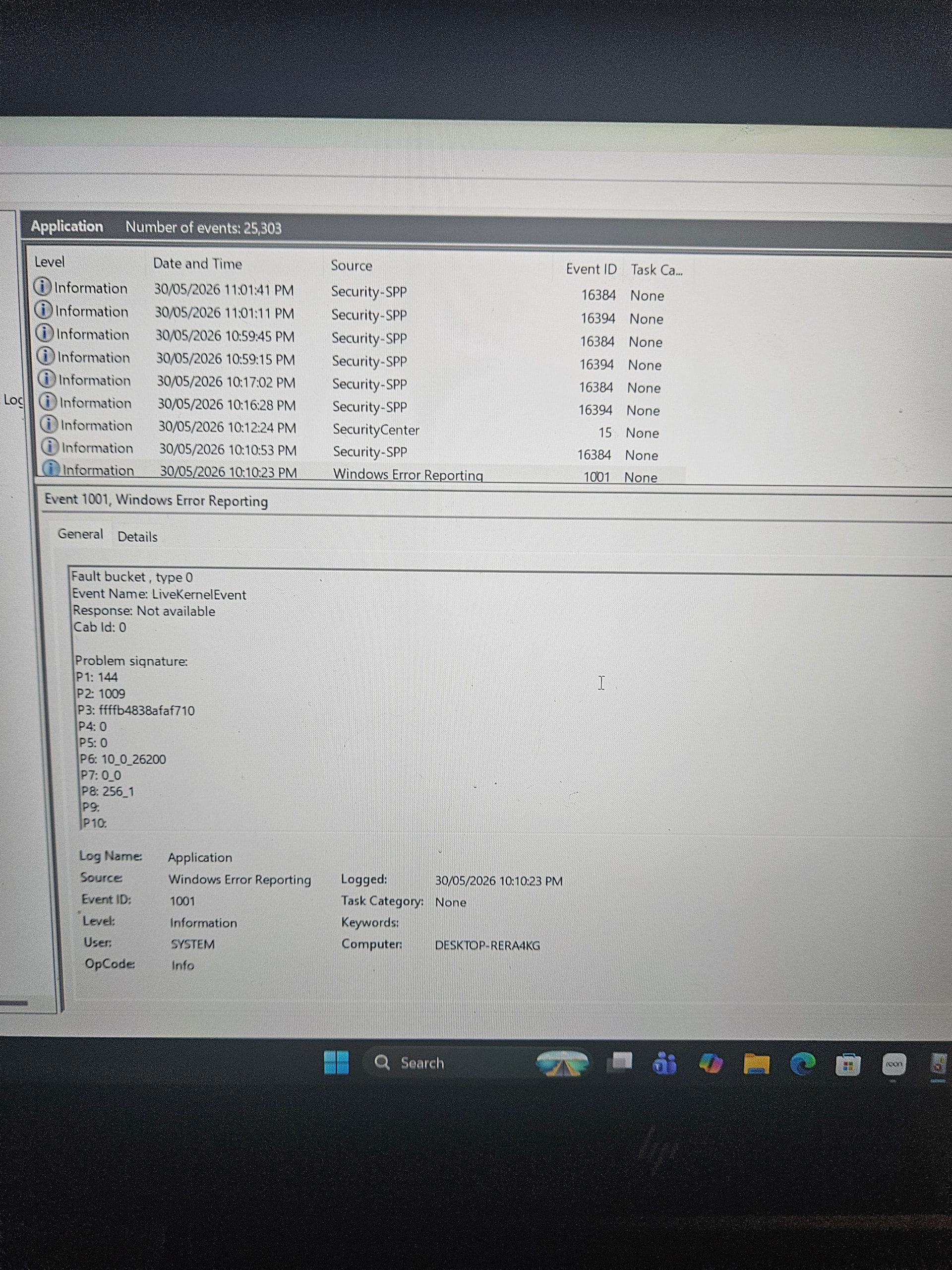

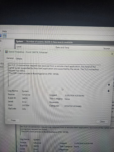

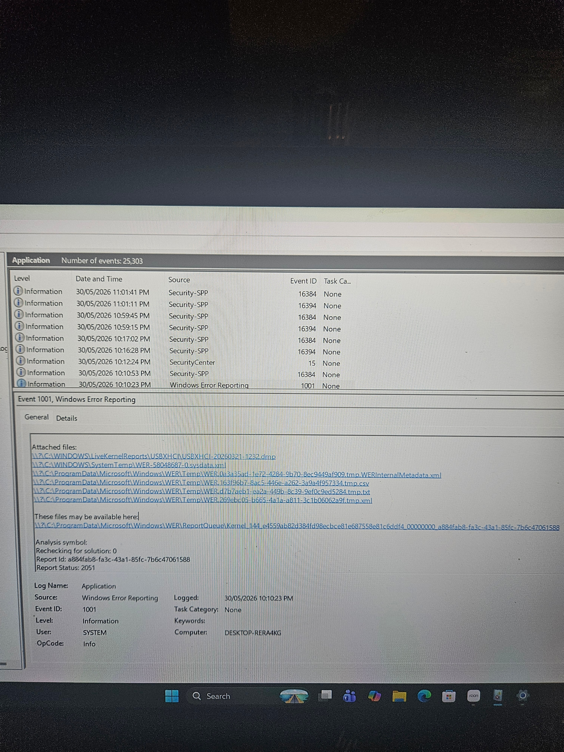

Hi have followed advice for firewall exceptions and anti-virus exclusions.
There are lots of errors in events viewer. The most relevant(?) seem to be:
These are two photos of the same error (scrolled to allow viewing all the files attached, I have tried to click These but do not have permission to see them), and then a roon specific error. Thanks for your advice

Hey @john_smith3,
Thanks for sending over a few screenshots! From them, we can see a few things:
  • Event Name: LiveKernelEvent: this means Windows detected a kernel-level problem while the system was still running (not a full crash/BSOD). It's a "live dump" captured because something went seriously wrong.
  • P1: 144: this is the bug check code. Code 144 corresponds to BUGCODE_USB_DRIVER, which points to a USB driver fault.
  • P2: 1009: a secondary parameter associated with the USB error type.
  • P3: ffffb4838afaf710: a kernel address, pointing to the specific driver object that faulted.
  • P6: 10_0_26200: confirms Windows 11 build 26200.
What this means for you: The LiveKernelEvent with USBXHCI strongly suggests your USB host controller or USB driver is faulting, likely triggered when Roon/RAAT is actively streaming audio over USB to your Astell & Kern CA1000T DAC.
This kernel fault would forcibly kill any active connections, including the RAAT server’s
http://localhost
socket, which matches exactly the “connection forcibly closed by remote host” error.

With that, I’d also ensure Roon and RoonAppliance are excluded from any SSL inspection done by security software (some antivirus products intercept TLS traffic, which would cause exactly the Event 36874, Schannel: TLS 1.3 cipher suite mismatch.)
