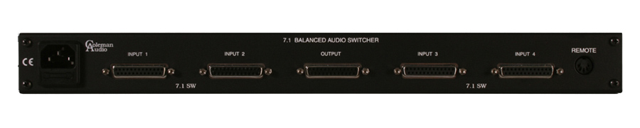

In early PC times, modems were connected via this DB25 connector. It reduced later to 9 pins as DB9, of course nobody uses that anymore today. You could buy a switch for selecting multiple DB25 source, that could be used as an (unbuffered), MCh input switch. I once retired one of those DB25 cables with cinch plugs on the other side to save money.

Yes. I use this Coleman 7.1SW Switch:

That one was 20€
I’ve seen those but those inexpensive mechanical switches are, or quickly become, noisy. The relay-based Coleman is silent.
… I have a 500€ silent one too, just wanted to make the point that sometimes simple unexpected things work too. A bit like a simple surround software that I am searching…
Indeed, I resisted buying the Coleman and started building my own relay-based switcher. However, I was able to find a barely-used one on Reverb.com, so I figured it was the easy way out.
