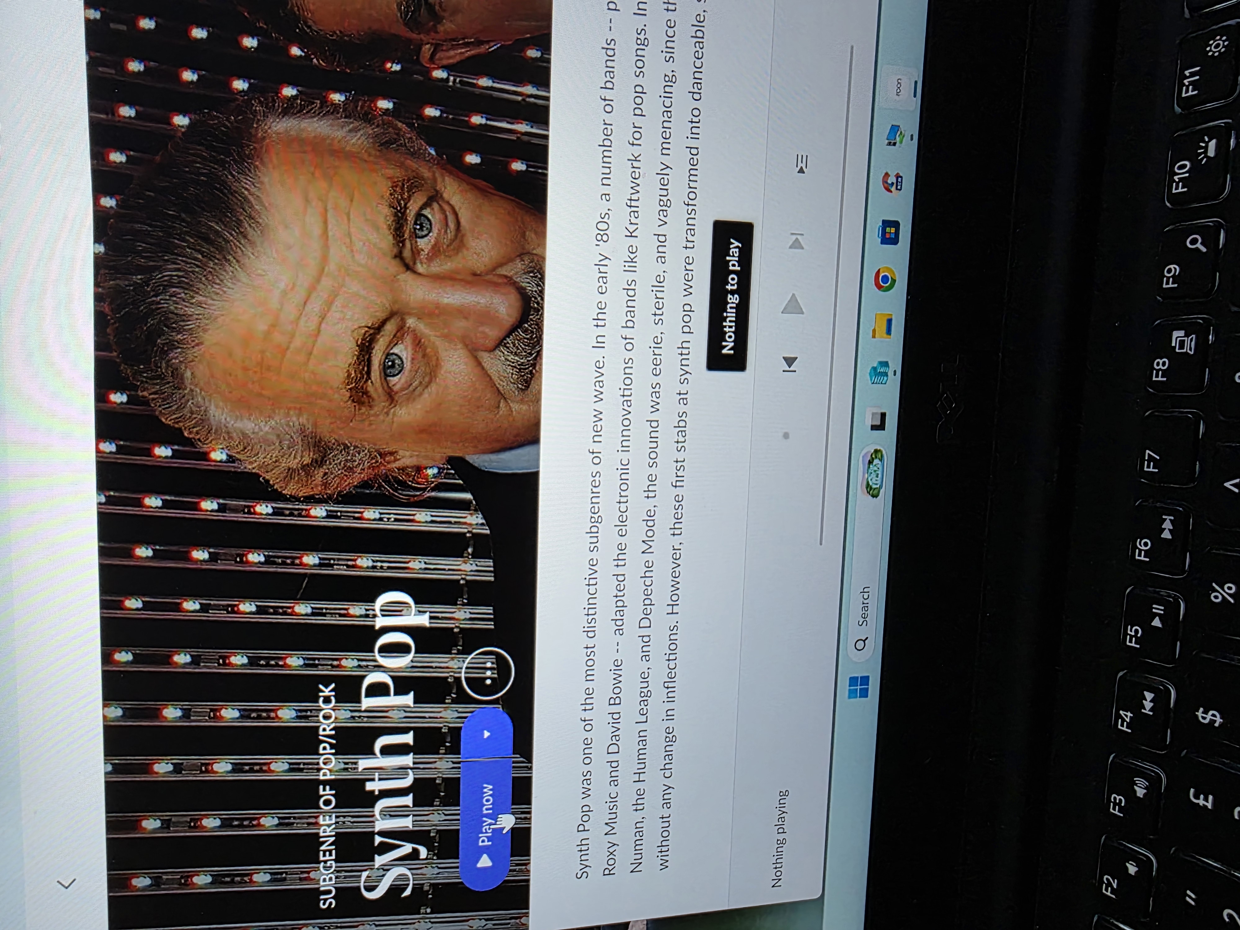

Guys I have an issue because I've come back from holiday and I'm trying to actually play the genres on my roon server via my Android app en via my Dell PC and none of the genres actually work.. so when I go into genre or sub genre of a pop/rock for example I get nothing it just says basically it comes up with "nothing to play".. I can play normal albums I can play liked tracks it's only being affected with the genres and it never used to be because I used to be able to play the genres easily. Something is happened. I also have restarted the server and I've also checked the hard drive which is external and connected to my small mini PC by my television. Other than that I have no other issues -- everything seems to work and arc also works. This is purely a genre issue
It's a very simple setup I have a mini PC with the rune server on the PC and I basically have an external USB SSD drive sandisks two terabyte drive which is connected to the mini PC which is whereas all my music is stored. So technically I play all the songs from my hard drive which is an SSD fast drive. Use my phone and my iPad to play songs via the Roo server that's connected to the mini PC via the local network in the flat

We were able to review a fresh diagnostic report from your Roon Server, and saw the issues you’re describing here.
When you hit Play on a genre, Roon tries to find seed tracks in that genre that have these tags (tagcount=0 means none were found), so it returns “nothing to play.”
And with that, from your logs, Roons’ swim engine finds no tagged tracks (tagcount=0). Every single attempt to play a genre shows:
swim_type=genre limittoseed=True tagcount=0
Swim failed to start (Result[Status=NotFound]). bailing
Even when Roon falls back to limittoseed=False (a broader search), tagcount=0 persists, meaning none of your 39,000+ tracks currently have the acoustic tags Roon Radio needs to function.

Hi guys it didn’t make any difference it just keeps coming up nothing to play so I did two things I forced the rescan of the library folder which is on the SSD drive and I also cleaned up the library which was about 40 entries
At the moment there’s no change sadly

So in the end I decided to use a previous backup and I use the backup that was just before the software update on and it seems to now work. I haven’t tried it this morning but I suspect it was the software update possibly or the indexing that caused the problem
