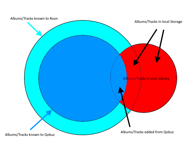

I’ve tried to illustrate the situation using a Venn diagram. Hopefully I’ve got it right, and this reflects the actual situation.
  • “Known to Roon” means that Roon has identified the album or track, and has metadata for it in its metadata service (the Roon database in the cloud).
  • “Known to Qobuz” means these are albums and tracks in the Qobuz streaming service, with Qobuz metadata. Because Qobuz is integrated into Roon, then by definition, all the Qobuz albums and tracks are known to Roon. Because Roon uses metadata from a number of sources, Roon’s metadata for the Qobuz albums and tracks could, in theory, be different, but I suspect that for the majority of cases it will be the same - Roon will simply re-use the Qobuz metadata. However, only the Roon Labs team can give the definitive answer here.
  • “In your library” means the collection of albums and tracks that goes to make up your Library. Some of these will be local files (Albums/Tracks in local Storage); others will have been added from Qobuz. Some (most) of this material will also be known to Qobuz and/or Roon, so there are overlaps.
Because of these overlaps, it is not possible to “use genres only from files and Qobuz” - the Genre settings are additive (the purple area), and not exclusive. If they were exclusive, then the Venn diagram would look like this:
Only, if you can live with Roon genres added to your local files as well – which may not always be the preferred way, like when one maintains a genre system which differs from the one Roon uses.
A setting to use Roon genres only if there are none present (like for streaming services) could help, but as mentioned, that’s not part of the current feature set.
I’m not sure it would, because surely the end result will be the mixing of genres (Roon’s and your own) in any case. The best that can be done is to edit the hierarchy to reflect your preferred genre hierarchy and list.as far as possible.
