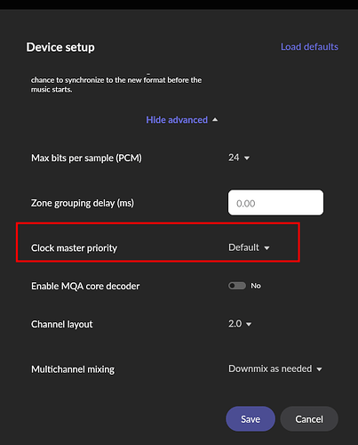

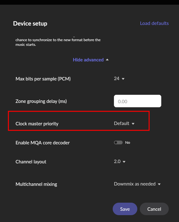

Select the Trinnov audio device in the Roon app, then click on the Speaker icon (bottom right of the display.) Now, click the Gear icon, and Device Setup in the pop-up (another Gear icon.)
Rsync Delay is shown on this pop-up. Experiment by increasing the delay in small increments.
Clock Master Priority is found under Advanced settings. To view these, scroll down in the pop-up, and click on Show advanced. Continue to scroll until you see Clock master priority. Again, experiment with the values.
