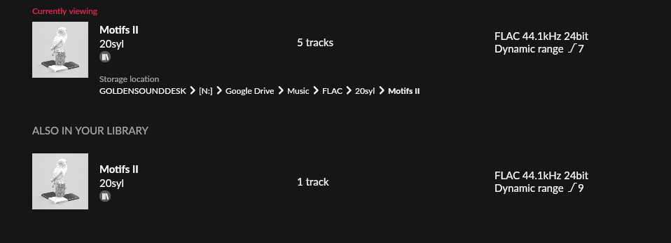

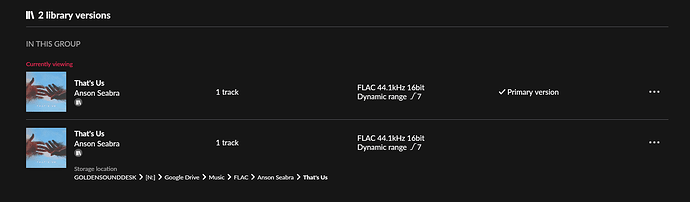

Tracks appearing as "ghost" listings after resetting NAS
Synology DS1821+ connected directly via 10GBe
To describe the issue in more detail:
  • Previously I had all my local music on my NAS, and everything was fine.
  • I recently rebuilt my NAS, I’ve not changed the drive letter or folder structure at all. But since doing so, a large portion of my music when I click play it just immediately says “too many failures, stopping playback”.
  • I can get the song to play if I manually search for that song and specifically browse to the version on my NAS.
  • Even after removing all local storage folders in roon, tracks are still showing as a FLAC version in my library with no directory. See this screenshot where I have two copies of the same track, one of which it gives the path for my NAS and plays fine. The other lists no file directory at all and does not play.
Do I need to clear some sort of cache to fix this? It’s pretty irritating as currently I cannot use any of the album browsing features, or playing from my history, I have to manually search for a track, go to the album, manually change to the version that displays a file directory, THEN play…
