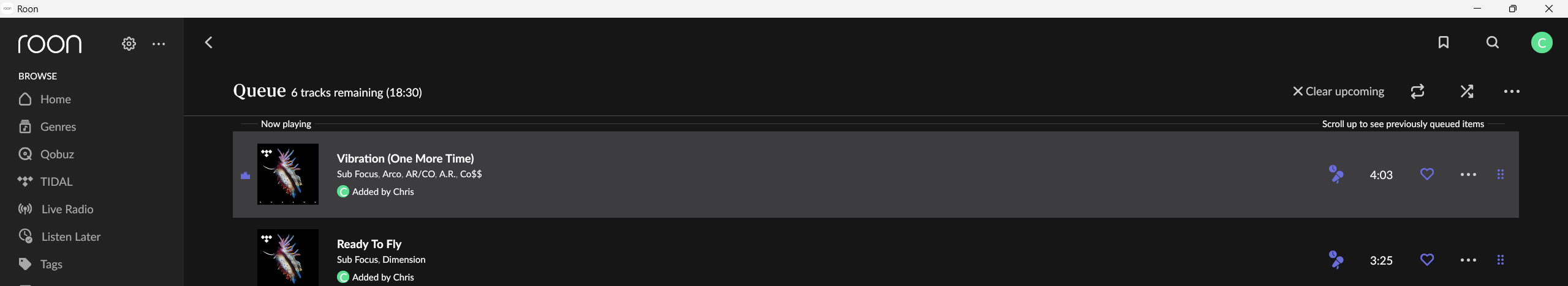

When Minimizing / Maximizing Roon Window GPU Usage Spikes to 90%, Window Briefly hangs and causes audio to glitch out
Asus Wifi 6 Router, Ziply Gig Fiber
This issue only happens when the Roon Window is Maximized / Minimized. If the window is not full size and it is minimized / restored the issue does not occur. To fix the audio glitch issue I have to close the Roon app completely and reopen it. Sometimes it requires a restart of the RoonServer to work again too.
I do not have Windows HDR turned on as my monitors do not support it.
I have an ASUS NUC 15 Pro with Intel 225H Ultra CPU
Focusrite Scarlett 2i2 audio interface
Intel 130T GPU with 2 monitors connected. Main monitor is 2560x1440 and second monitor is 1980x1080.
Issue occurs on both monitors but seems to happen less on the 1980x1080 monitor.

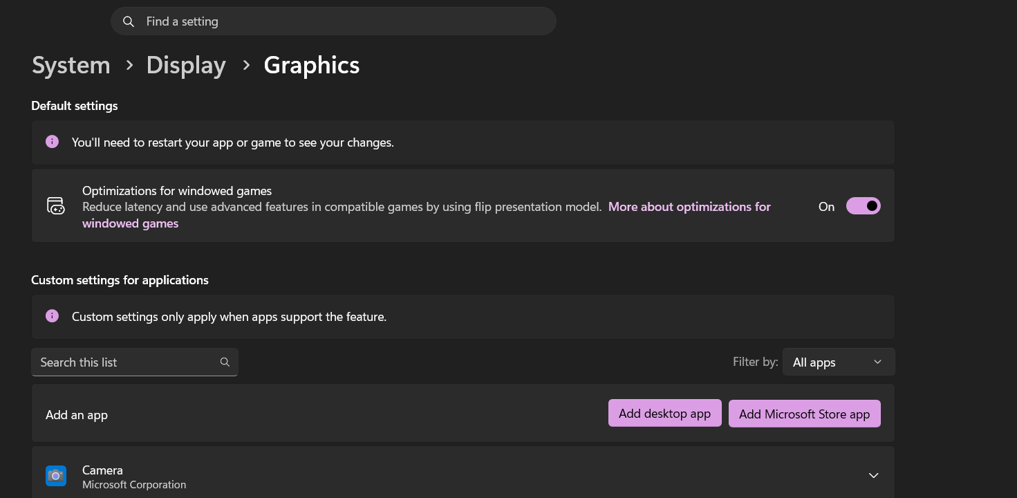

  2. Disable Hardware-accelerated GPU scheduling in Windows Settings → System → Display → Graphics → Change default graphics settings - there are specific reports of 100% GPU spikes on Arc cards with this setting enabled
  3. In Windows Settings → System → Display → Graphics, find Roon.exe and try setting it to Power saving mode
Could you let us know which Intel Arc driver version you are currently running? You can check in Device Manager → Display Adapters → Intel Arc Graphics → Driver tab.
Driver version: 32.0.101.8860

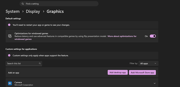

I don’t see the “Change Default Graphics” option you mentioned on that graphics page.
The only item under “Default Settings” at the top of the page is “Optimizations for windowed games”. I tried that setting on and off and the behavior is still the same.
I also tried adding Roon and changing the type to Power Saver as well, no change.

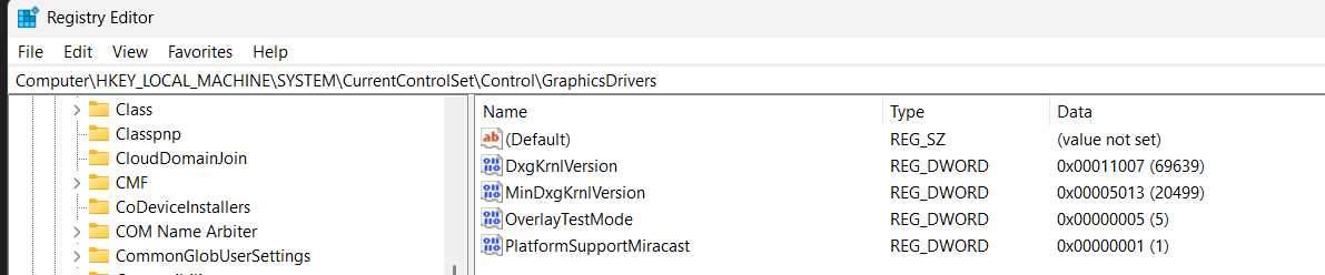

Disable Multi-Plane Overlay (MPO). This exact symptom cluster (GPU spike, brief hang, audio glitch on resize/minimize with Intel Arc) is a well-documented MPO/compositor bug, not just a generic “update your driver” issue, it’s the same category as the GitHub issue Vadim linked.
The fix: add a DWORD value OverlayTestMode set to 5 under HKLM\SYSTEM\CurrentControlSet\Control\GraphicsDrivers, then reboot. This disables MPO system-wide and is the standard workaround for exactly this Intel Arc flip-model hitch. Worth trying before anything else, since it targets the specific mechanism the logs point to.
Re-check Hardware-accelerated GPU Scheduling. You said you couldn’t find “Change default graphics settings,” but on Windows 11 the HAGS toggle lives at the top of Settings → System → Display → Graphics (a standalone switch, not under the per-app default-settings link he found). Worth confirming you’re looking at the right control and toggling it off if currently on.

I definitely don’t see the toggle you are speaking of in the graphics settings, unless I am looking in the wrong place? Here is what I see:
I made the registry key change seen below and rebooted.
Unfortunately,the issue reproduced almost immediately at 12:29PM PST.

  1. You can revert the OverlayTestMode registry key. That setting disables Multi-Plane Overlay, which only affects Direct3D's present path, but Roon renders in OpenGL, so it was never going to touch this. That's on me; the earlier compositor/MPO angle was aimed at the wrong graphics API. No harm done, but you can undo it.
