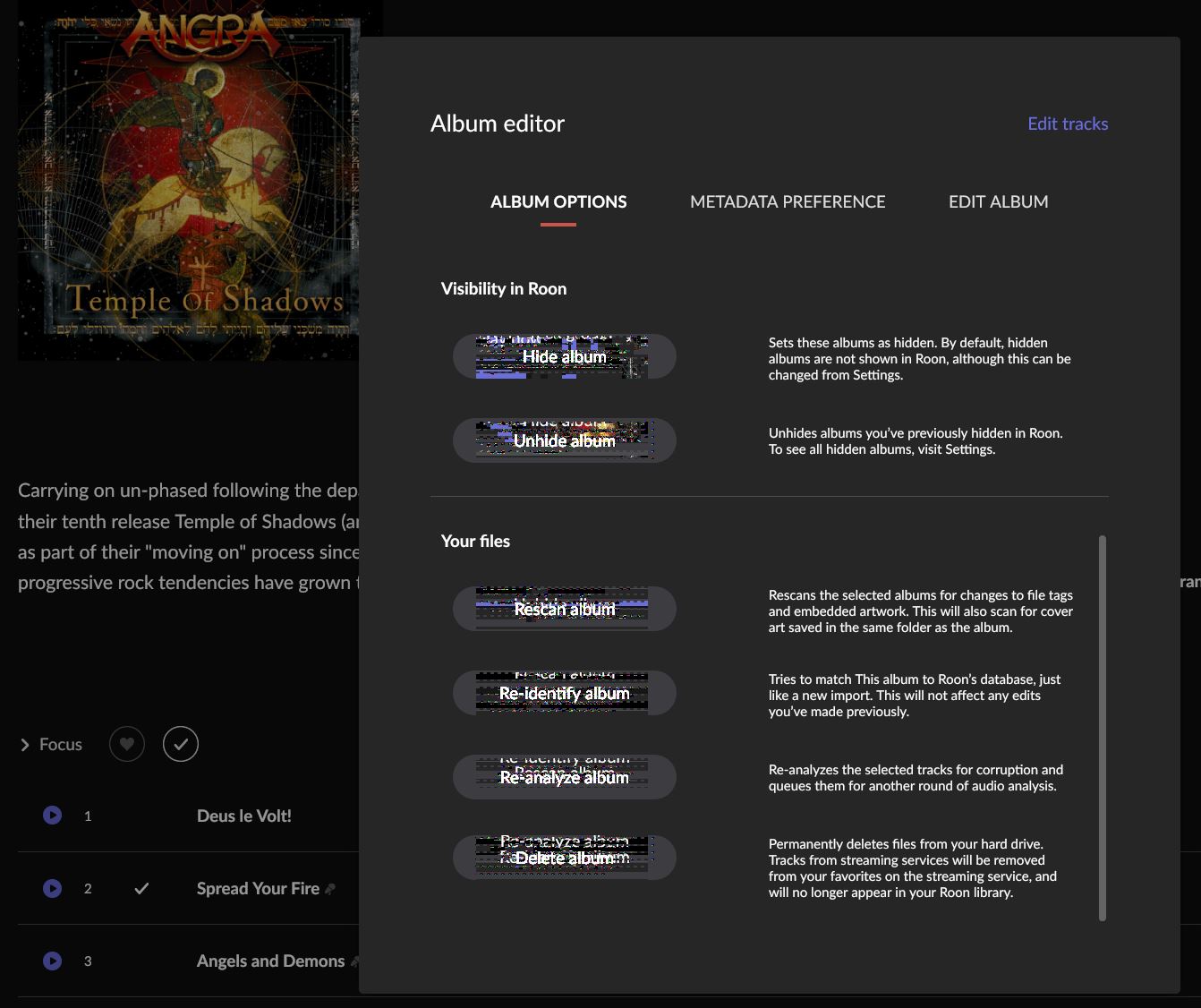

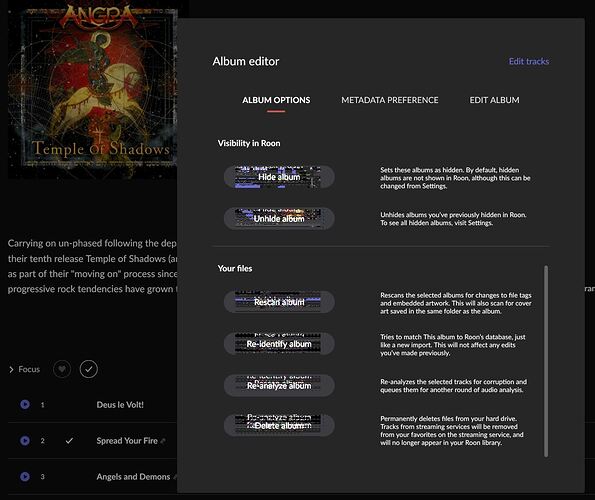

The broken menu graphics seem to happen from 1.6 but the problem remains on 1.8. So I don’t think it is related to my PC’s graphics driver.
rr|690x305
Hi @JENGHUNG_LUO
Do you see this in other areas of the app?
Is there any change if you uninstall and reinstall the GPU drivers?
All menu items could have such artifact. I guess it is related to desktop resolution (wrong buffer pitch or something like that). The PC is with a 3440x1440 21:9 wide screen. I have another PC with 1920x1080 resolution and it works fine.

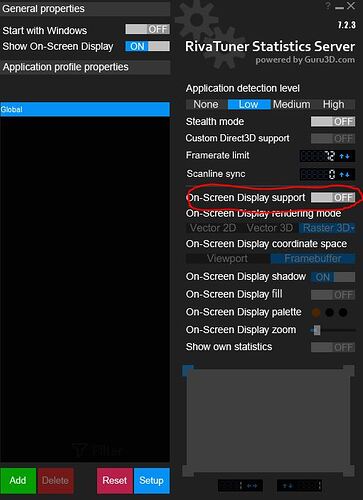

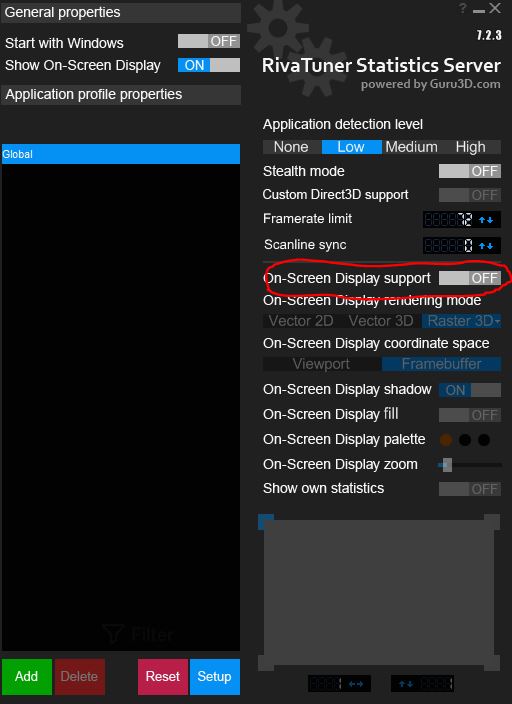

I am running 2560X1440 at 144 Mhz with a EVGA 1070ti and I am not seeing an issue. (Yes, I know different generation of gpu). But, I also do not run any other vid cap or overlay for gaming. So, no twitch etc. I know that sometimes programs like Afterburner have caused conflicts.
If you have any of those other programs running, like GeForce Experience, etc, you might try turning them off and seeing if that makes a difference.
Thanks. The problem is gone after disabling RivaTuner’s OSD support.
PS: GeForce Experience’s OSD overlay works fine with Roon.
