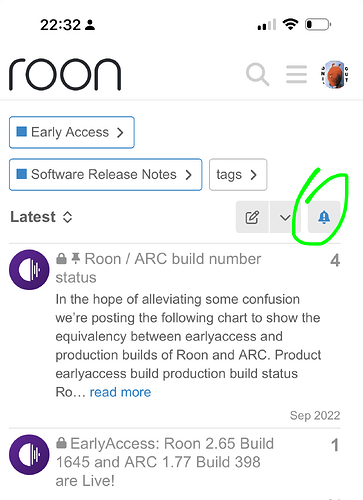

It will be announced in Early Access when available:
You can click here to subscribe to new announcements:

Yes, in your case we’d recommend you to wait until Apr 20, make backup and apply for Early Access program to test out the Docker support we are going to implement soon.
For more details on how to apply for Early access please find here:
Thanks for your cooperation.
