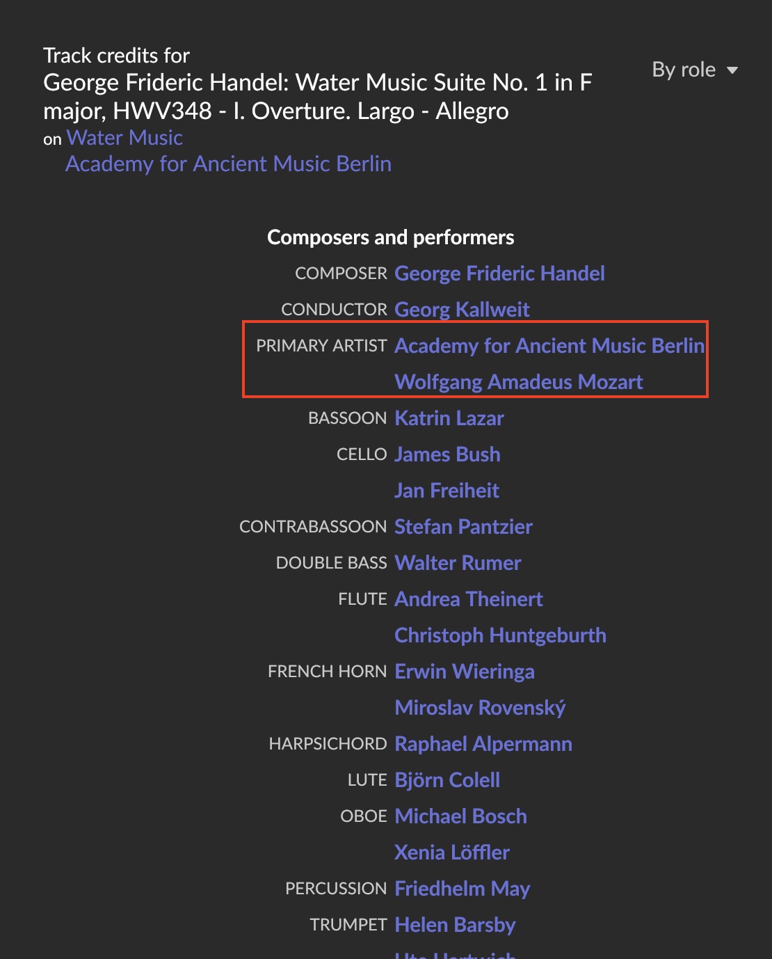

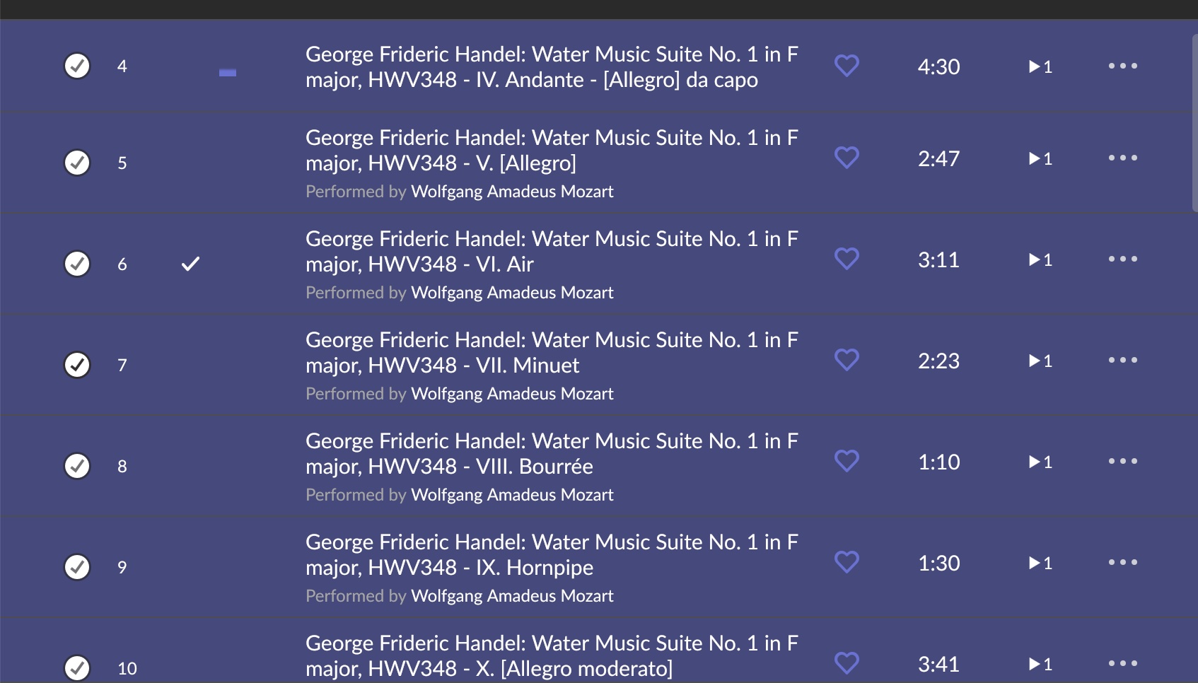

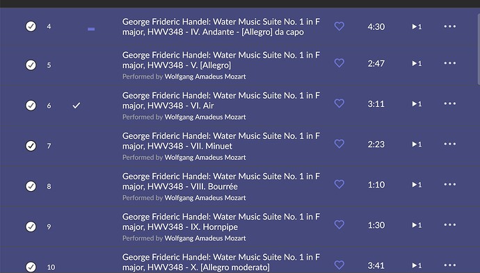

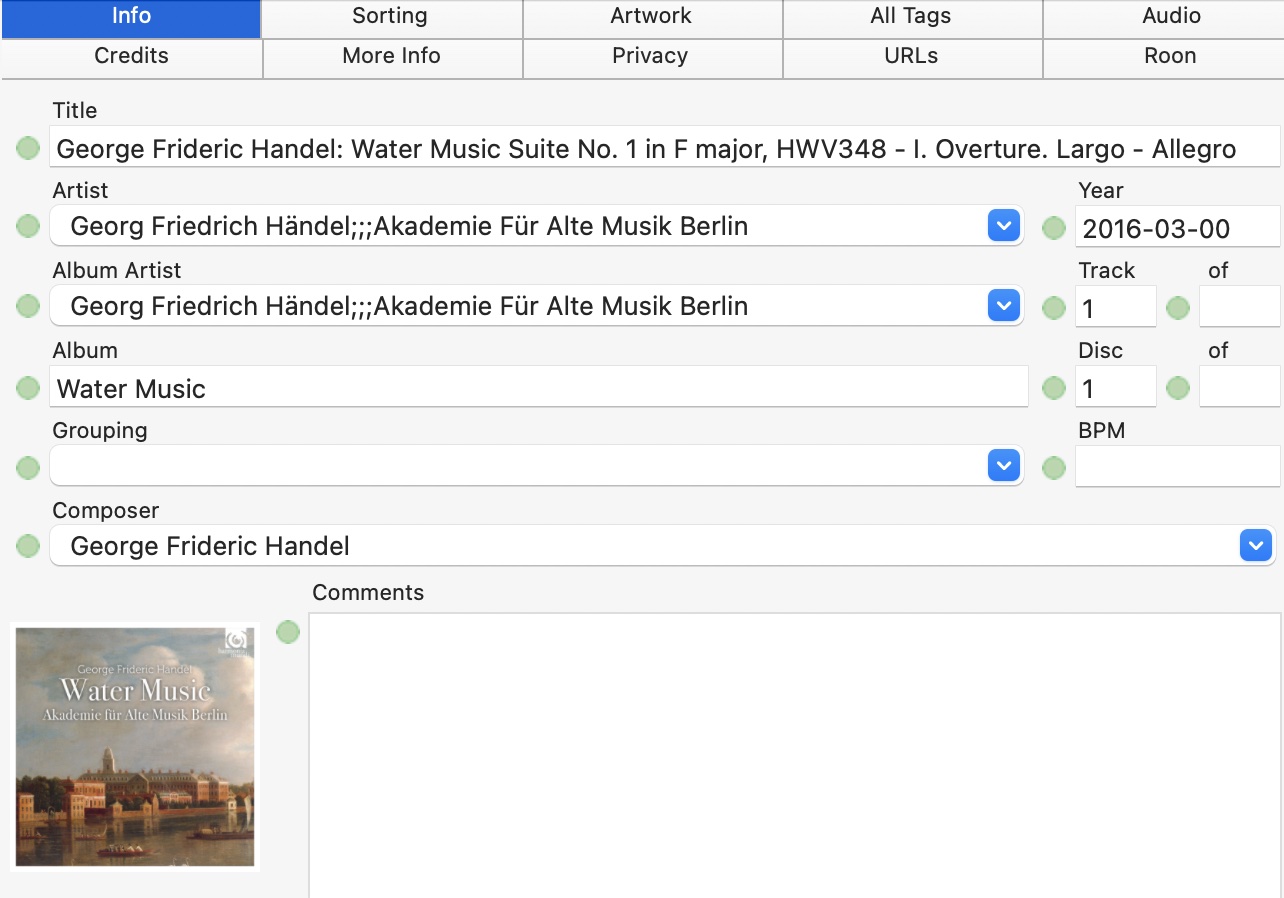

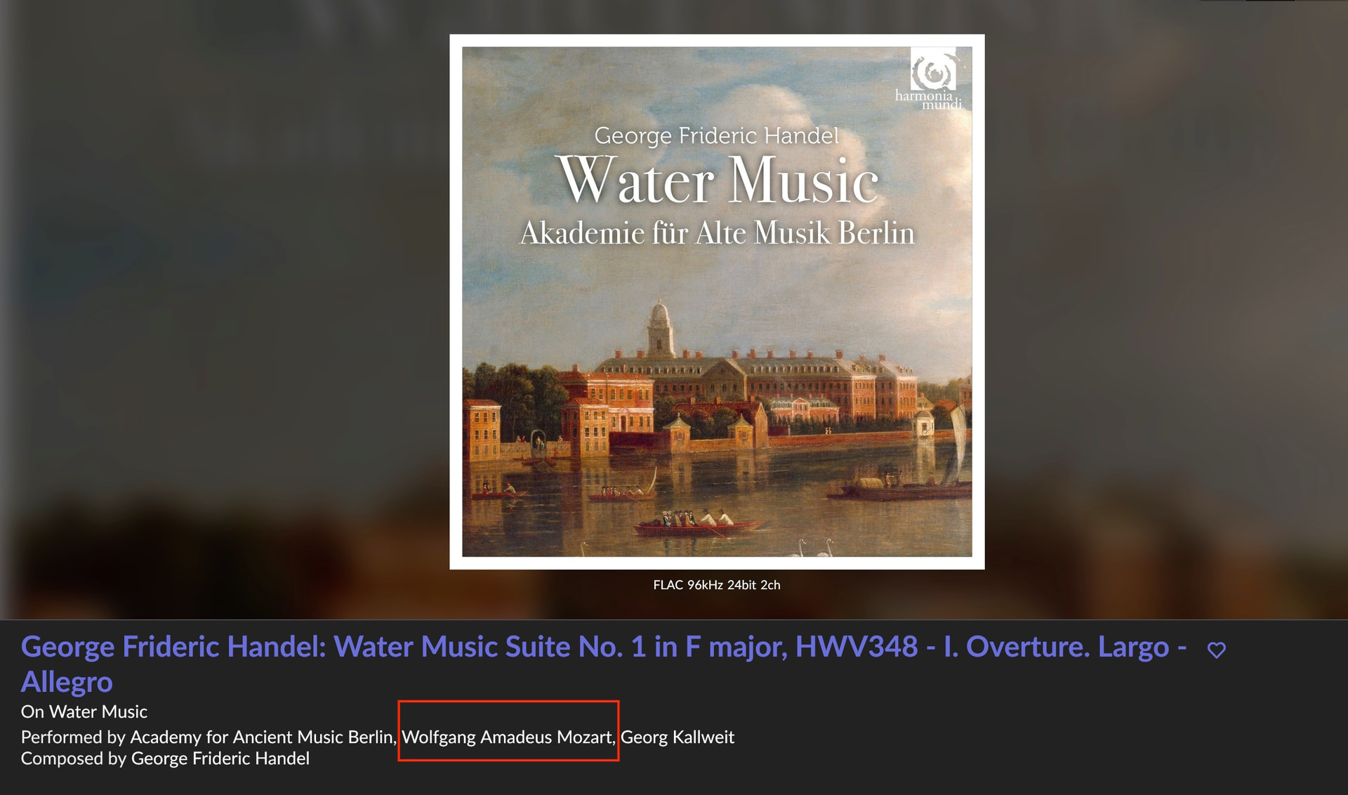

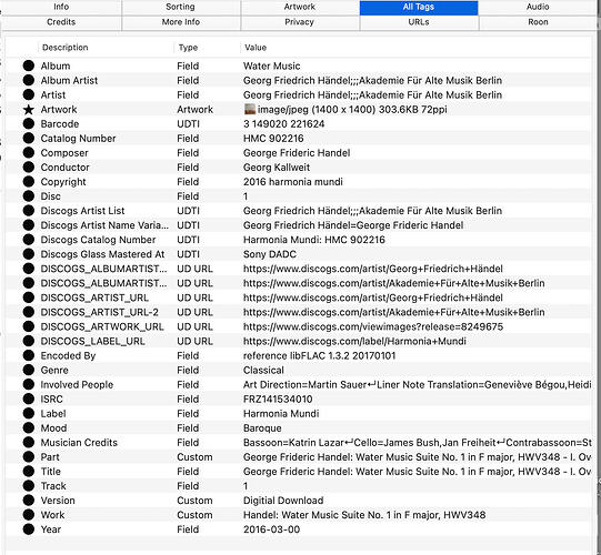

I downloaded Händel’s Water Music Suites Nos. 1-3, HWV348-350 from Presto Music, did some tag editing in Yate and uploaded it to my library that syncs with Roon. While listening to the album last night, I kept seeing (and still see) Mozart as a performer. I went back and checked my tag edits and everything looks in order:

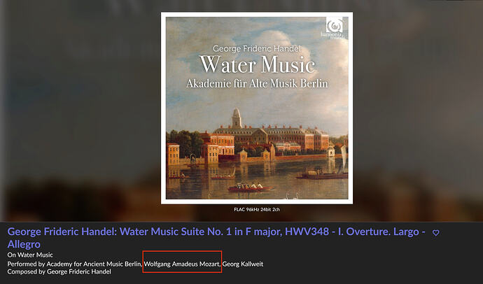

But here is how it is displayed in Roon:
I can still thoroughly enjoy the album with Mozart getting near top billing, but I would like to understand why this happened and what I can do to clean it up. Any thoughts?

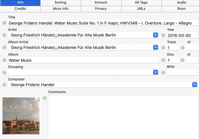

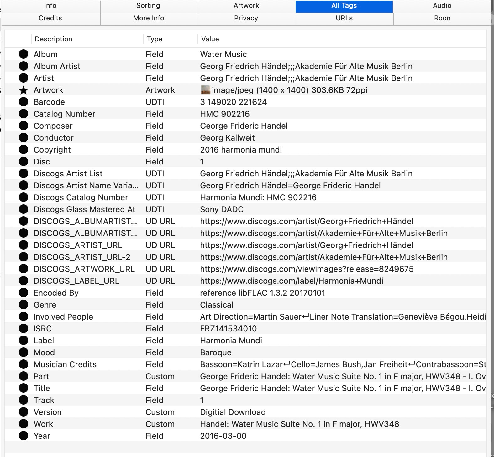

In Yate, what happens when you click on “All Tags”?
I’ve checked our cloud metadata – we appear to have only one instance of the album – and there’s no Mozart on it. As per @DDPS‘s suggestion, you might want to look for some hidden tag metadata.

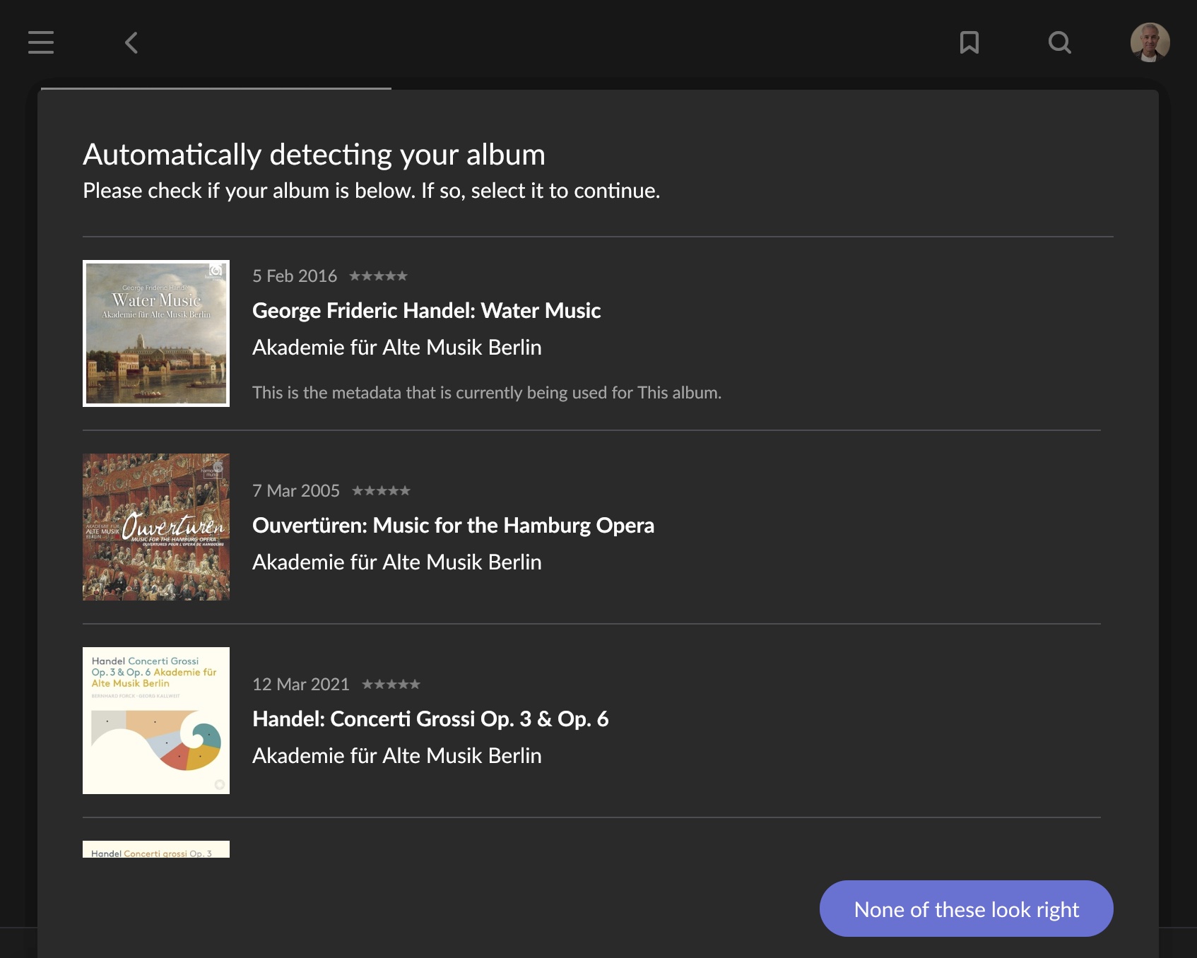

Can you confirm that the album is identified in Roon?

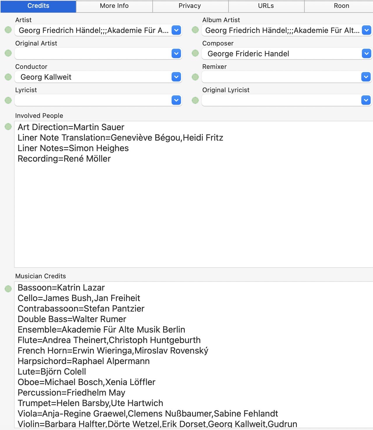

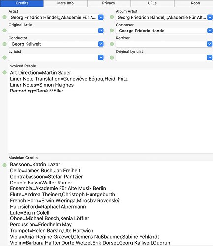

@DDPS - Here is the Yate “All Tags” screenshot for the first track:

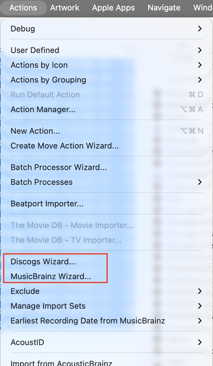

One of the things I recently learned, and now use extensively, is to pull in the metadata from either Discogs or MusicBrainz using the Yate-supplied wizard:
It’s really a nice feature that auto-populates most of the tags. I sometimes have a hard time finding an album in MusicBrainz (as I did with this album- but you found it!) so I used the Discogs wizard. Regardless, the Discogs version appears clean with no signs of Mozart.

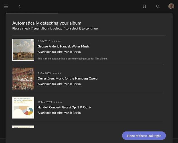

@joel - By “identified in Roon” do you mean this:
If so, the album is not there beyond what I added. I checked the above and then manually searched under a variety of search strategies.

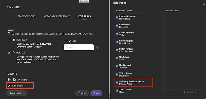

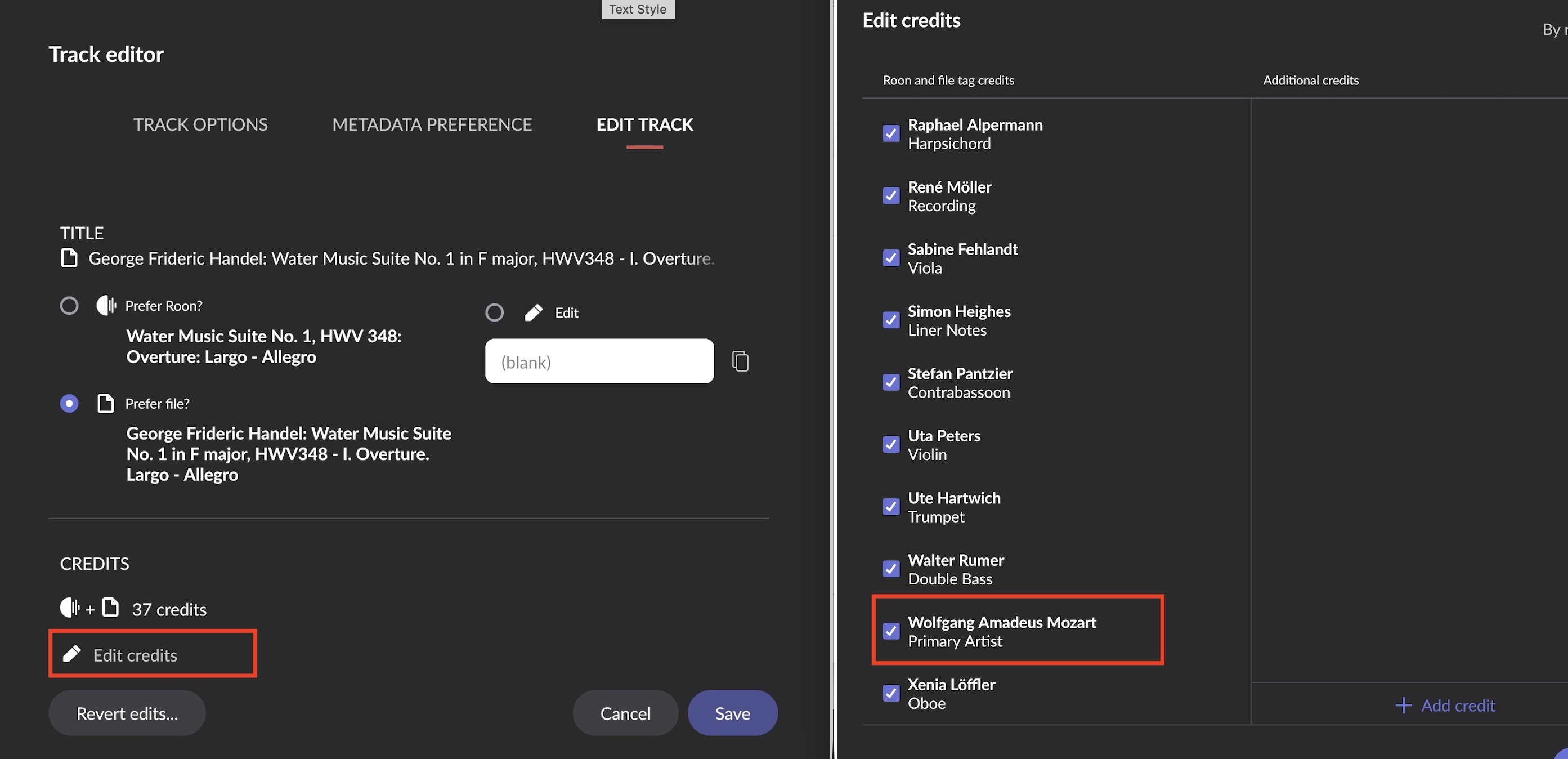

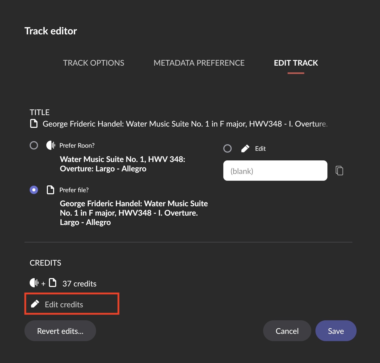

Anyway, I wanted to share two other screenshots from what I’ve uncovered. I went into Track editor:
and then to Edit credits:

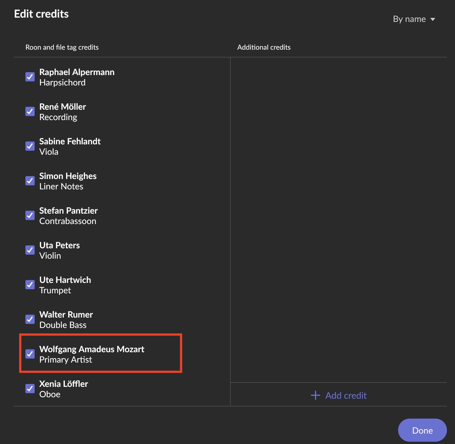

And there is Mozart as a primary artist. So I could clean the album by deselecting Mozart for each track. However, before I declare this solved, might there be other solutions that explains why Mozart is showing up?

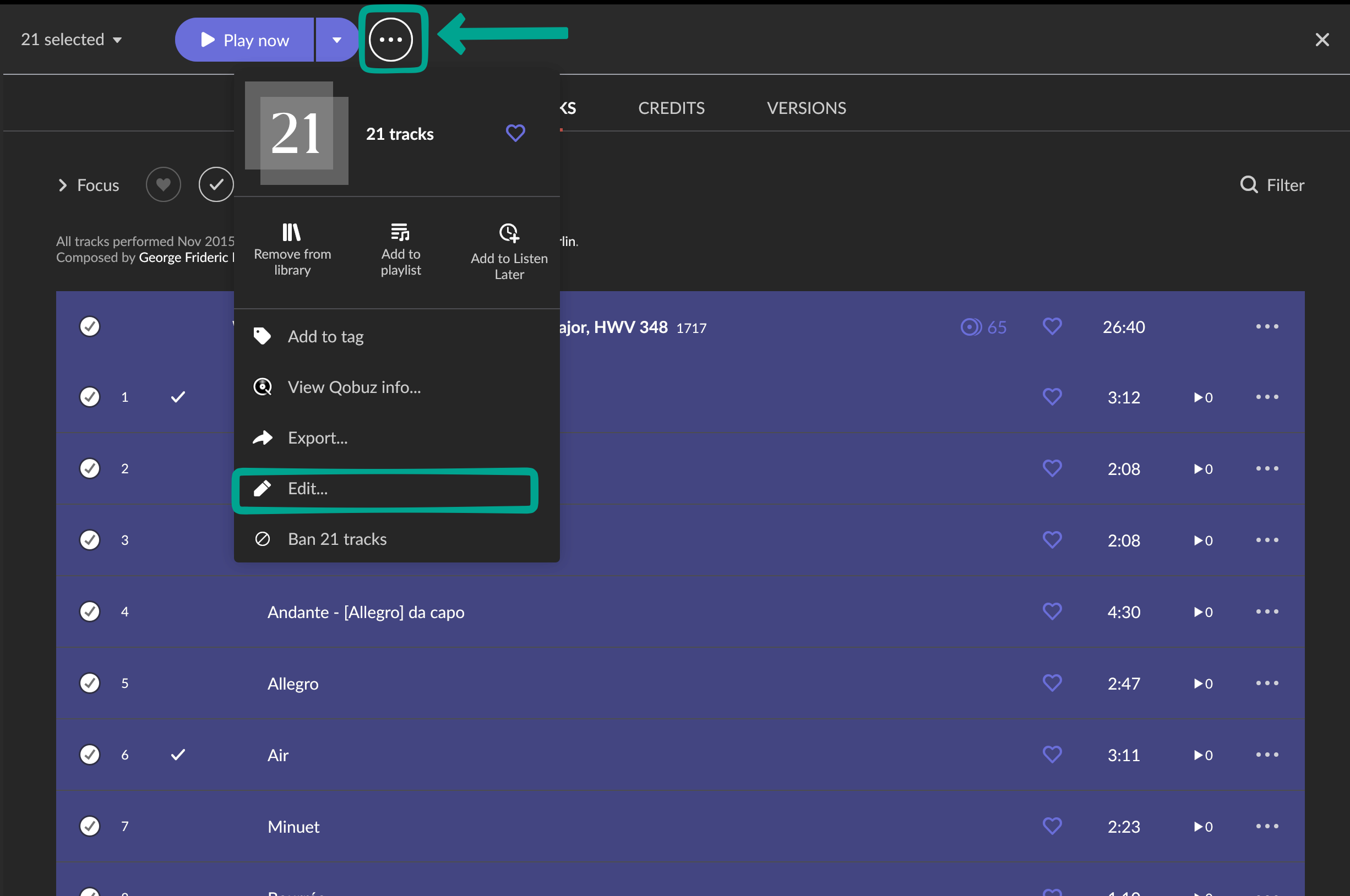

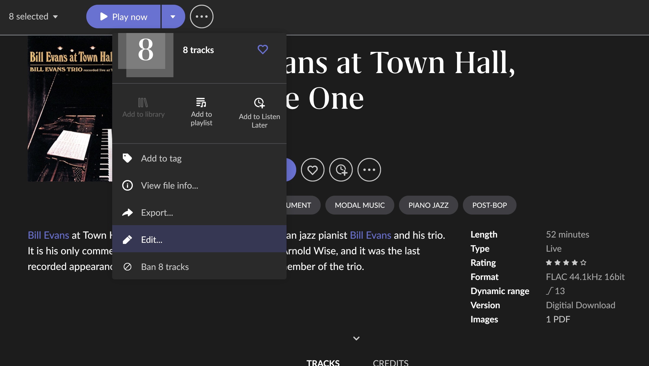

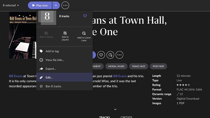

Don’t click the three dots next to the track. These three dots always apply just to the track they appear on. What you have to do it is select multiple tracks and then click the (…) button at the top, to the right of the “xx selected” menu, then click Edit…:
Then you can make edits for all that’s selected at once.

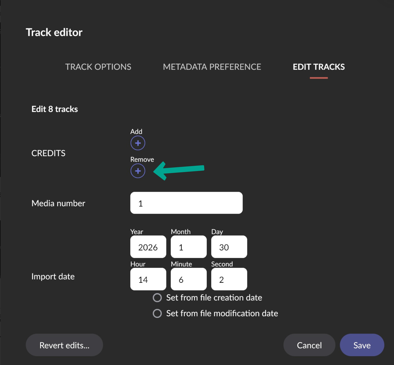

So I tried that (as well as trying that earlier with the Water Music album). Here are the screenshots. First I followed your steps, all cool:
but then I saw this:
I didn’t see a way in the above screenshot to edit the tracks as I was able to do with the manual method:
Am I missing something?

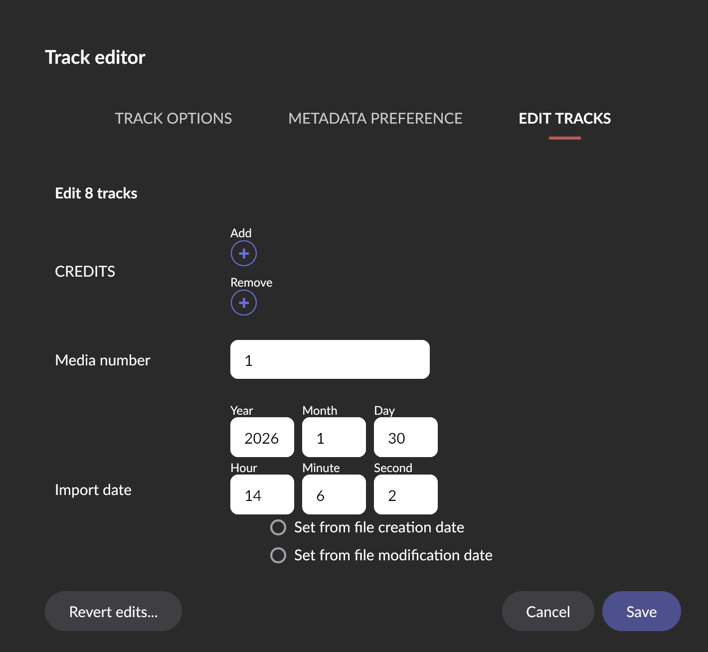

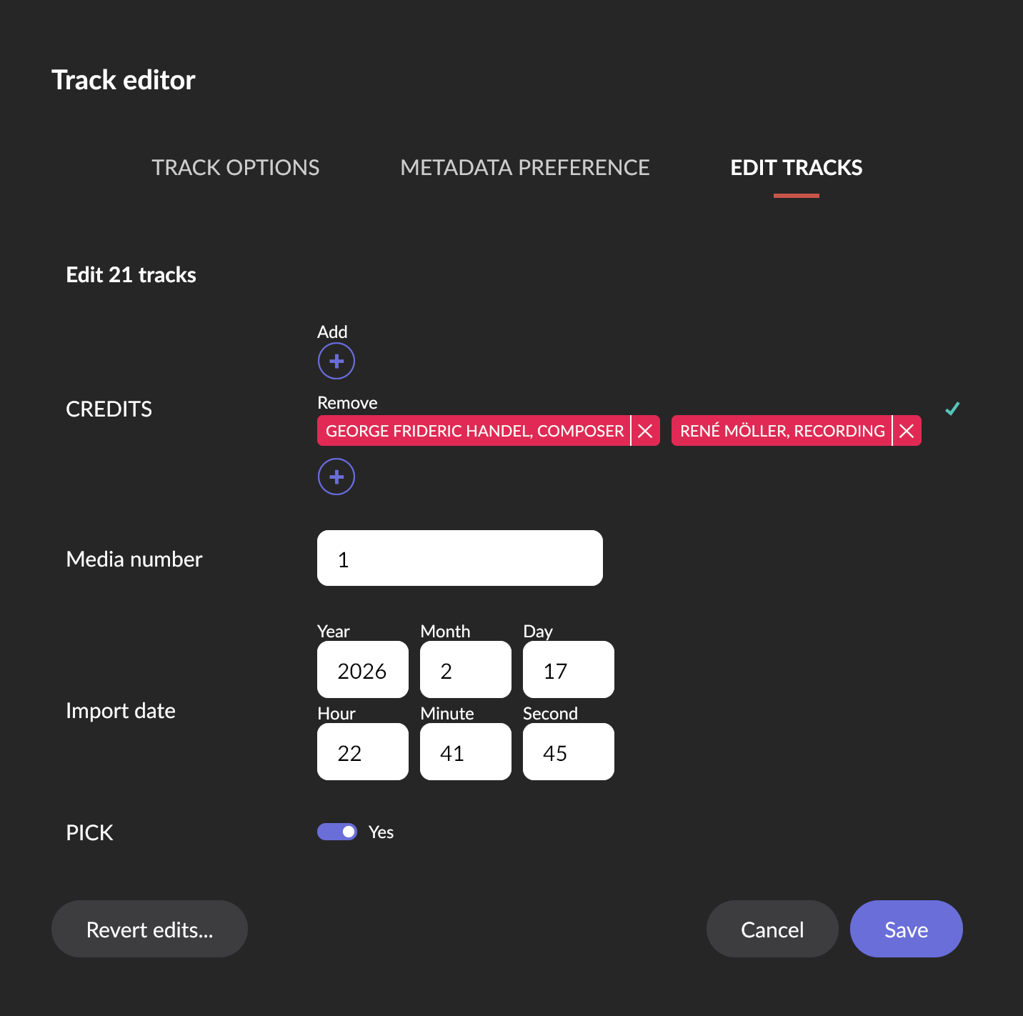

It looks a little different because it has to combine credits from multiple tracks. So click the (+) button below Remove:
(Using a (+) for remove is admittedly maybe a bit misleading. Anyway, that’s how it is - read it as meaning “add credits to the remove list”. And if you click the (+) button below Add, you can instead add credits to all the selected tracks at once. By the way, you can also scroll through this window to see more options, such as recording place and date to make them the same for all tracks.)

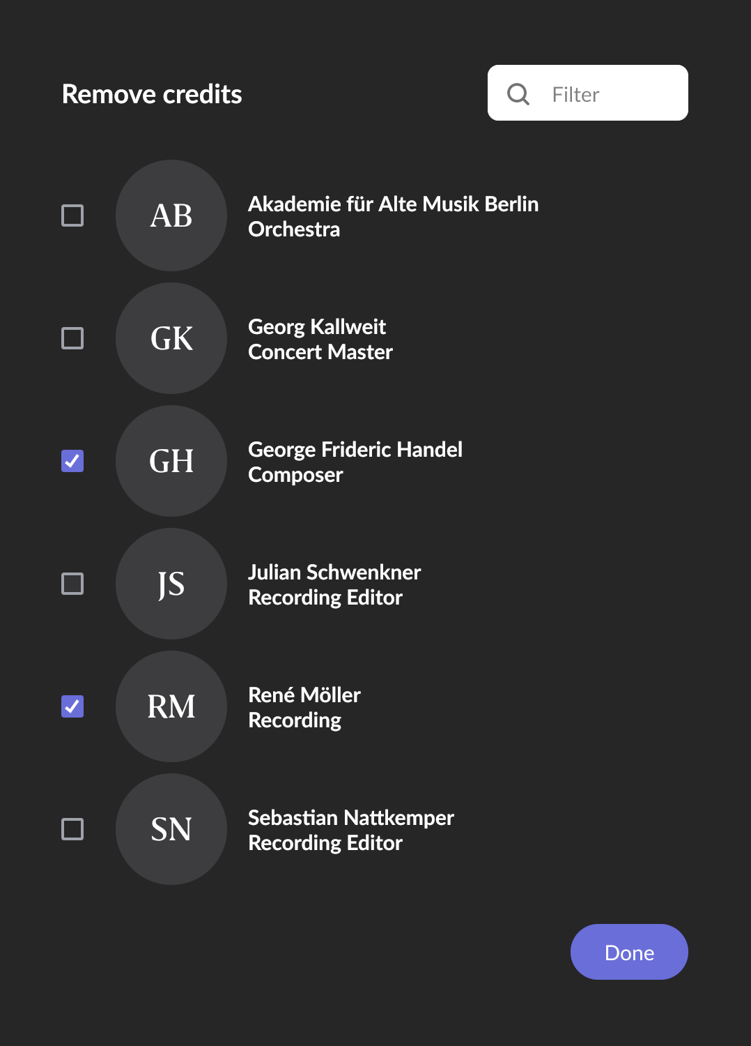

Then you get a combined list from all the credits on all of the selected tracks. You can scroll through them (or filter, top right) and check those that you want removed. (I don’t have Mozart here so I am selecting arbitrary ones):
Then click Done and you will be back in the main track editor window. The ones you are about to remove will be listed in red. (You can still click the X to remove them from this list if you change your mind for one or more of them). Finally, click Save to confirm and really remove them:
And by the way, you can also do the adding and removing (plus any other edits) at the same time. Just click the (+) for Add to add some, click the (+) for Remove to remove others, and apply it all at once.
