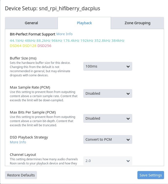

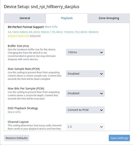

The correctly working bridge settings look like this:

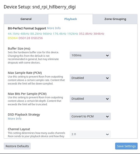

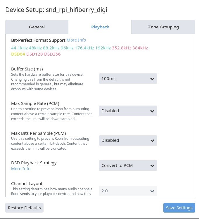

On the two that don’t work correctly, 352.8khz, 384khz and DSD128 are red and they will not down sample any DSD file or playback any file other than 44.1khz.

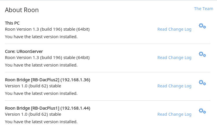

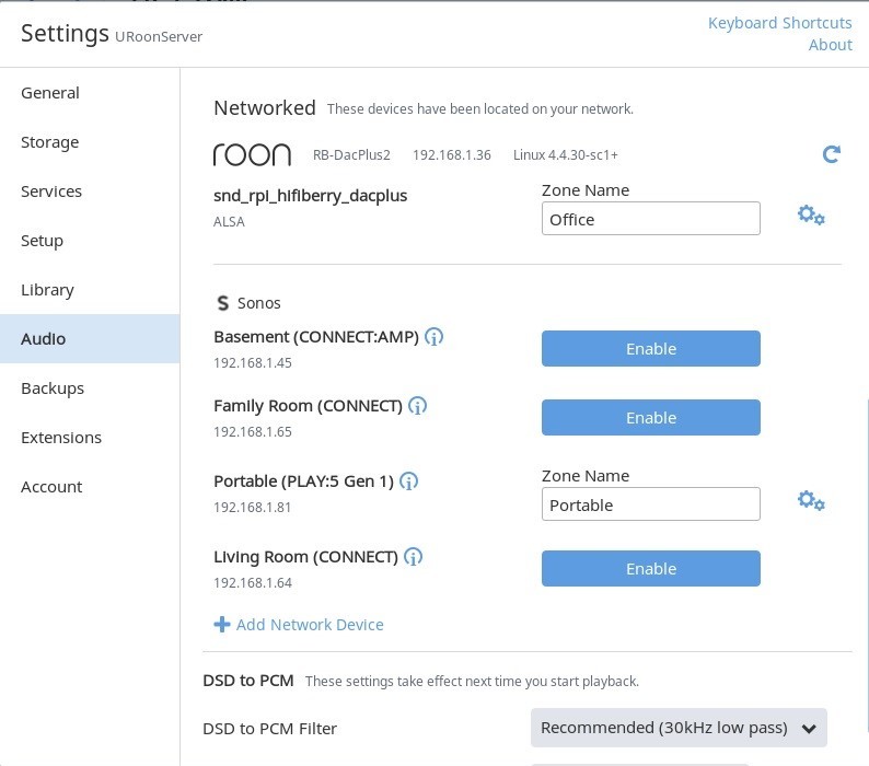

I can’t provide screen shots of the non-working bridges because after the last try at rebuilding they no longer show up under available network devices (one does show up under About).

Well the fourth retry worked on the Dac Plus. Unfortunately that wasn’t the case on the Digi Plus. I thought these boards were identical capability wise (Digi+ vs Dac+), but apparently not.
Please let me know if anyone is able to get 384khz support out of a HifiBerry Digi+ (I am not)…
Thanks for your Help Steve and Rene.
You can’t, I’m afraid: S/PDIF out (optical and coaxial) is limited to PCM192.
