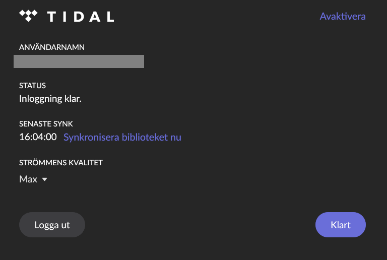

Make sure in Roon’s settings you have Tidal set to ‘Max’ Streaming Quality.

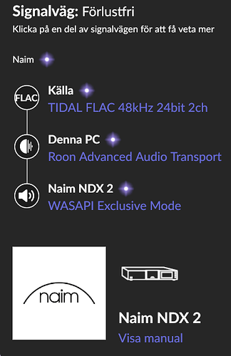

If that doesn’t resolve, post a screenshot of Roon’s Signal Path information whilst your playing this track.
Hi! That is not the problem. My Tidal is streaming MAX.
Ok so that’s one possibility ruled out (which is good) … then the next step is …

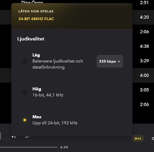

And here is the exact same song on Tidal directly and now the hd lamp is lit on my Naim DAC.
So in Roon–>Settings->Services->Tidal the quality is set to max?

The signal path is confusing - it seems to be routing via ‘This PC’ and ‘WASAPI Exclusive Mode’, which implies you are somehow using the PC’s sound card.
The NDX2 is Roon Ready, so you should be able to connect to it using your local network…
That signal path is odd NDX2 is a Roon Ready Streamer which means it should receive its stream over the network from the main Roon server. Here you are sending to a PC then its going to NDX2 via WASAPI which is windows, That makes no sense as the NDX2 has no USB in. Is the NAIM DAC still connected and have you just misidentied it in Roon, which model is it?

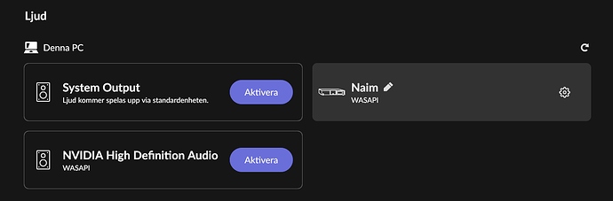

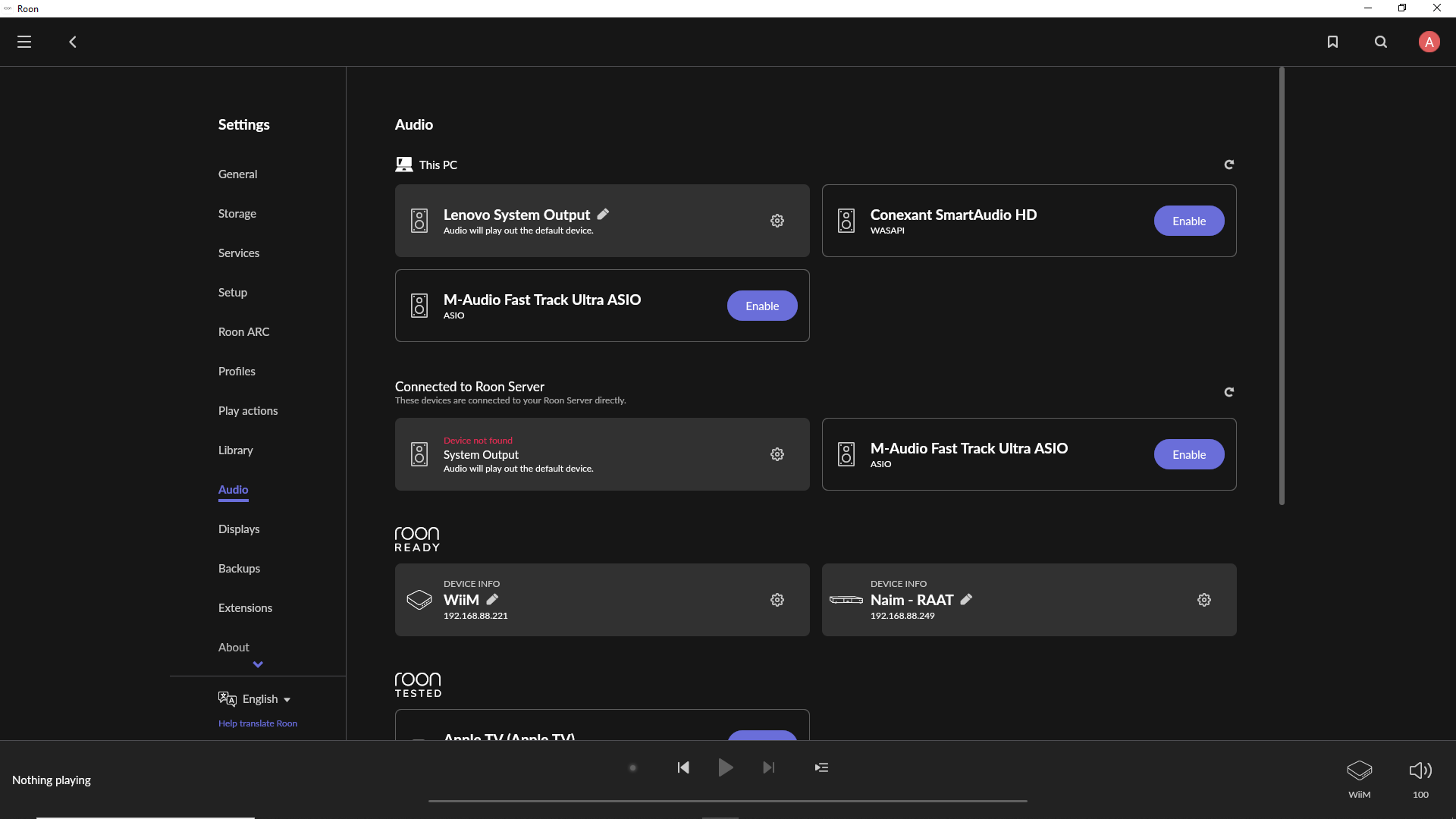

Please show a screen grab of your audio devices from settings/Audio

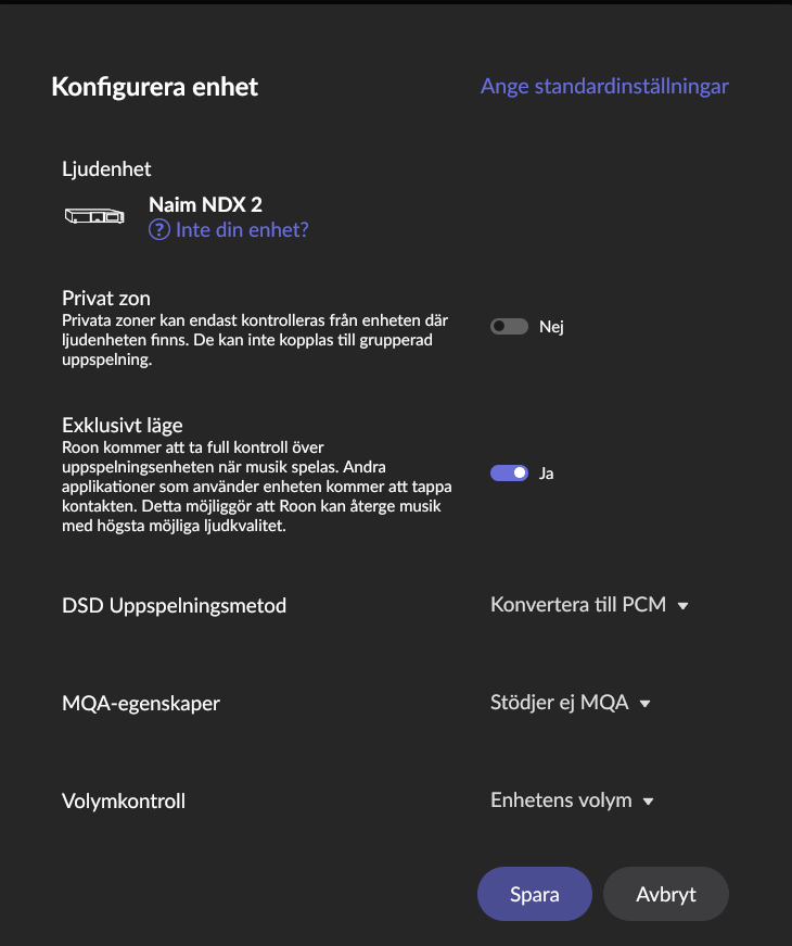

Hi again, I have tried almost every Naim gear available in Roon, I have also tried different Ifi gear as I have a Ifi ilink between the PC and my Naim DAC. If you know what I should choose instead I would be very grateful.
The Naim DAC is connected, I do not have a Naim NDX 2.
But there is no Naim DAC to choose. So I try to choose gear as close as possible.
The Ifi iLink between my PC and Naim DAC is for spdif as the Naim DAC does not have a USB in either.
My Naim DAC is connected to Naim Nait XS2 as stated in the beginning.

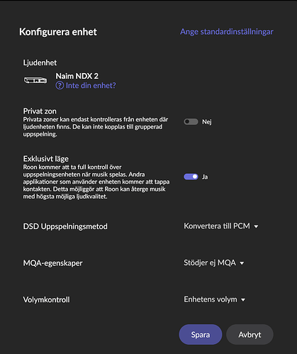

In Roon I have tried many different Naim and Ifi options. In the pictures above I have chosen NDX 2.
I do not have a NDX, just to be clear.

What does your settings/audio screen look like?
(This is mine - yours will be different… )
The one I’ve named Naim is active, there are nothing else here

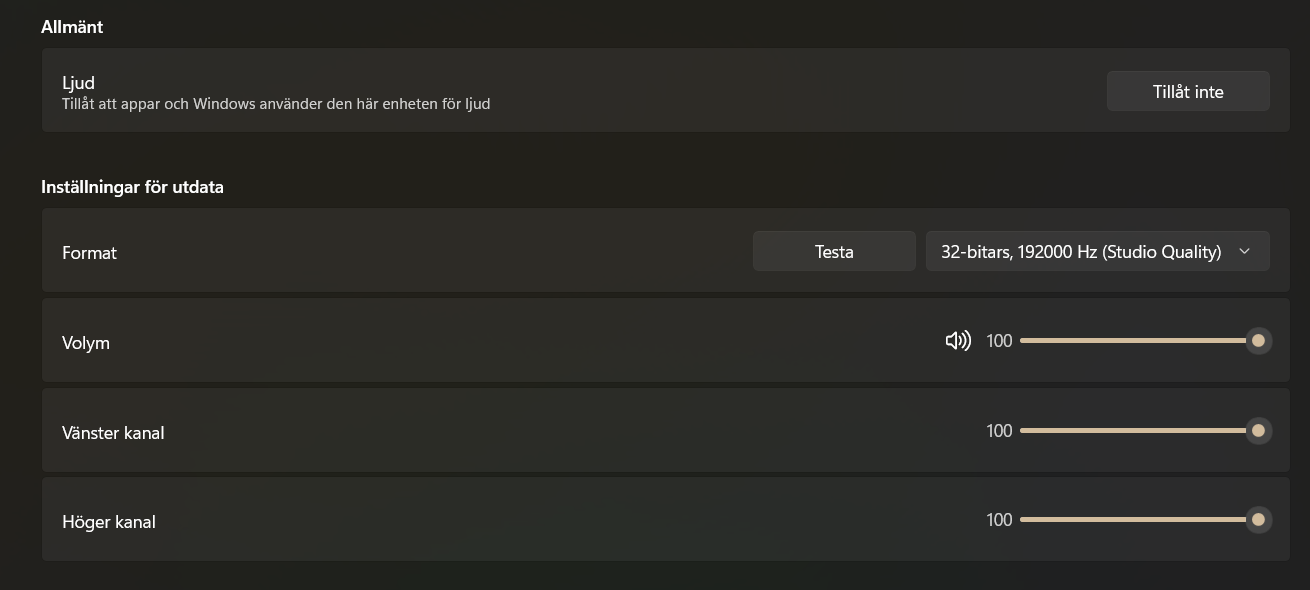

And here are the PC Settings
