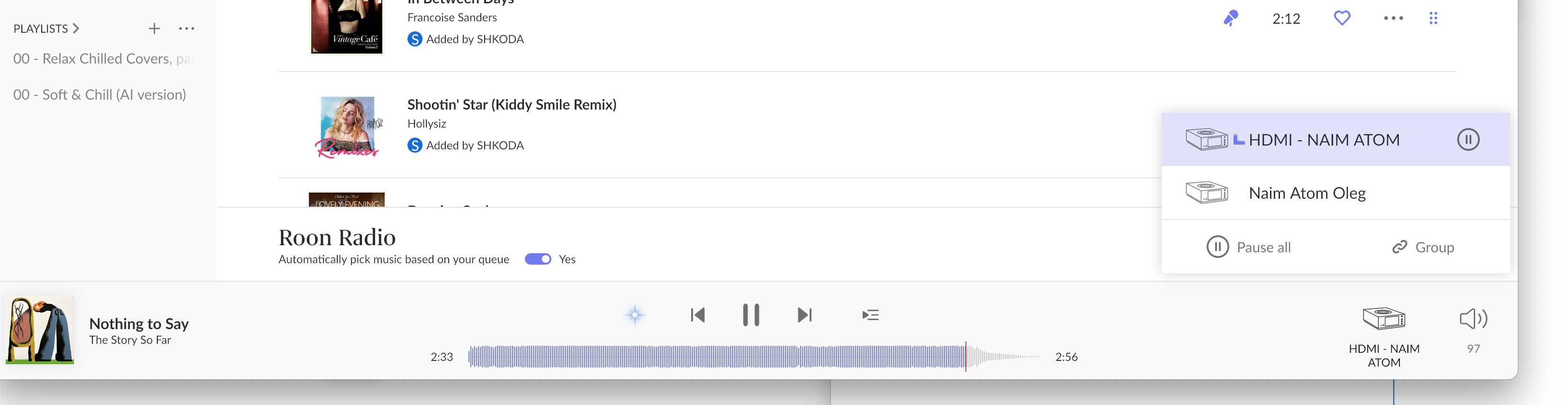

When selecting an audio device in the ROON application settings I select the Nucleus One HDMI Output from the available list, then identify the device from the list as a Naim Unti Atom. This device becomes available when I select the audio output of the ROON App player, I select it and press the PLAY icon. The process of music playback starts, but there is NO sound on the NAIM UNITI ATOM output device.

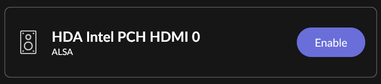

Are you using this:
If not, try it.
Torben
I have MAC OS. Yes, I have this option activated. And in the list of available audio devices this output is renamed, now it is called HDMI - NAIM ATOM. I forgot to write that my media box is located on a SAMSUNG 8 TB SSD, which is mounted in the NUCLEUS ONE.
