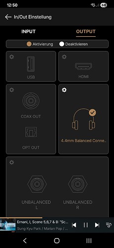

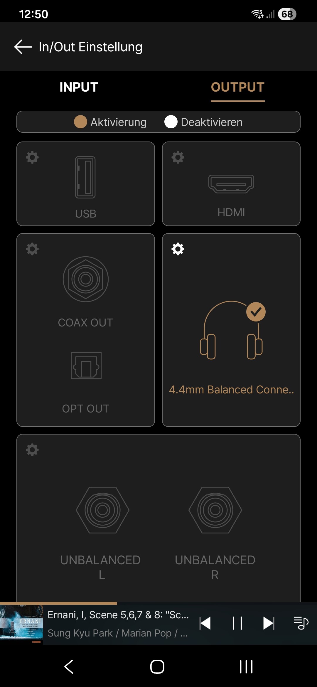

Surely also the RS250A is Roon ready, but the HDMI out on all Rose devices (I’m using two RS250, one RS150 and a RS451) is a very special thing and should IMHO only used for video out (Rosetube or showing metadata).
What are your settings for the HDMI out on the device?
Yes, I was surprised when I was told the RS250a was not Roon Ready.
Settings for HDMI Out:
PCM Max Sample: Auto
PCM Resampling Frequency: Original
DSD Mode. Not selectable, but set on Native
Low 8 bits: Off
