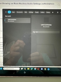

I am trying very hard here to do what you asked me to do. When I enter \\NUCLEUS\Data in the File Explorer it just spins around saying “working on it” but nothing appears after several minutes. When I tried entering it into my general search bar at the bottom of my home screen it shows up but will not open. I took pictures of both situations and attached same. I was on the WebUI a few days ago where I tried reloading and restarting those things as described in my initial message, all to no avail. I have also rebooted everything at least 1/2 dozen times, if not more, again to no avail. I also sent you the photo of my TV screen with it attached via the HDMI cable and was hoping that that would tell you something. While waiting for your response I even tried using a Dr. HDMI device to see if that would work but it did not. I am having a really difficult time understanding this and really need some help here. I am being overwhelmed with frustration and have already spent a huge amount of time on it that I really do not have to spare. So if you can tell me what to do I would very much appreciate that.
Unfortunately the image quality is very bad and impossible to read details. However, it sounds like you enter it into the search box of File Explorer instead of the address bar.
Maybe this helps to find where you should enter it:
Else please post a screenshot, not a photo of the screen

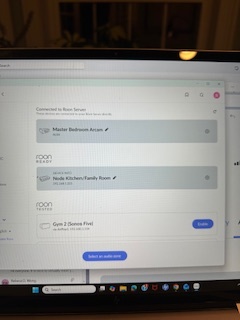

Here is a screenshot of where it says connected to Roon server. When I try and play music over
the HMDI input nothing happens. It plays fine on this avr over WiFi or Ethernet but nothing over HMDI. When I hit the Devise Setup button there are very few options and there are no Advanced setting options.

On my computer now and trying to send you that screenshot. But all I get is code. Trying now to take an actual phot of the Audio Setup screen.
I’m sorry, but that photo is too small to discern anything clearly. Please see this article of how to include a screenshot in a forum post:

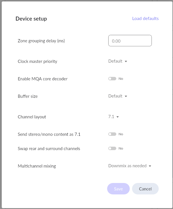

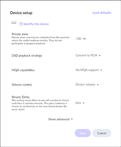

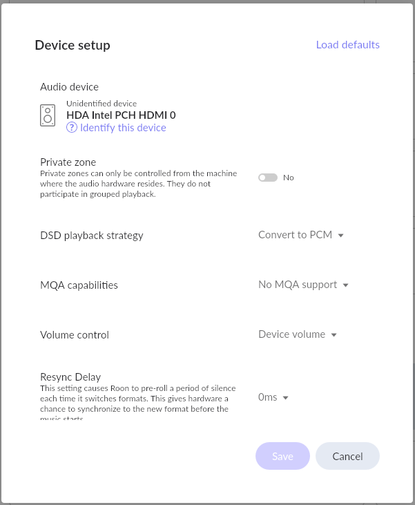

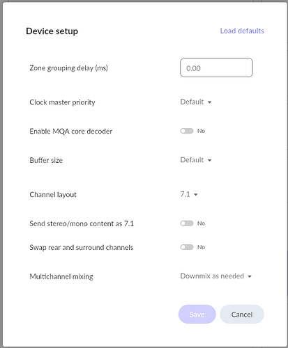

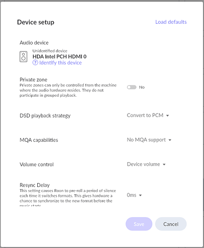

And screenshots of the Device Setup screen of the HDMI connection in Roon would be useful to see. For example, here’s what I have for the HDMI connection to my Denon AVR:

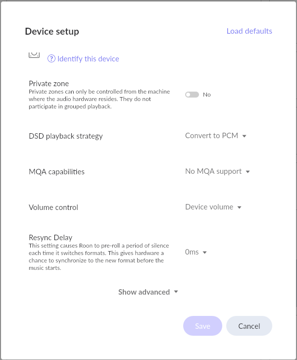

Please be aware that this Device setup screen is scrollable (even though no scrollbars are shown). So you may need to scroll down to see the “Show advanced” link:

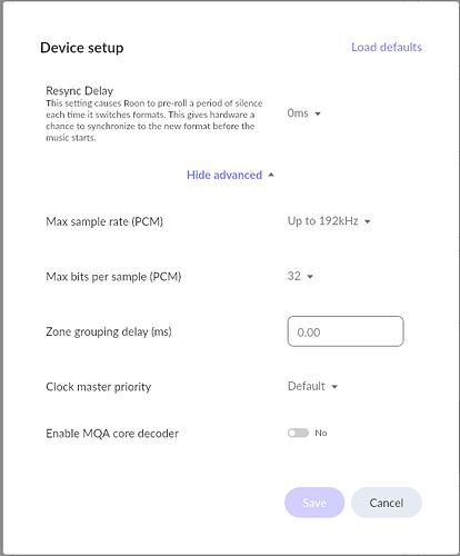

Then click on the ▽ there and scroll further to show the advanced settings (and provide screenshots of them as well):

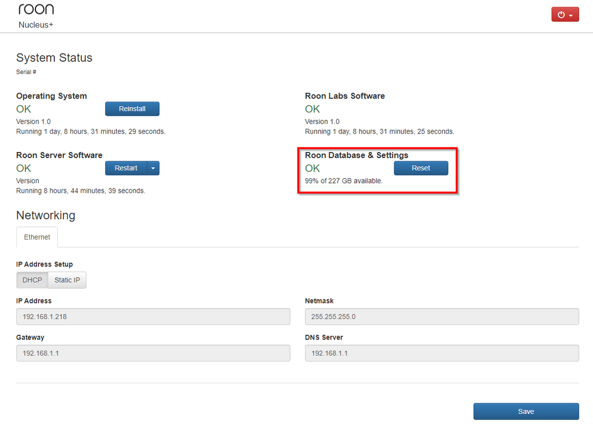

Thanks for sharing that screenshot, it does look odd that there is no HDMI zone there when there should be one. I would like to suggest we try to perform a factory reset on the Nucleus One to see if that helps. To do so, please first create a Backup of your current database. Then once you have made a backup, please navigate to the Nucleus Web UI and perform a factory reset, first starting with an operating system reinstall:
If that still does not restore functionality, please try to perform a database + settings reinstall:
Then set your Nucleus up as a fresh server and verify if the issue persists. If the issue is resolved, you can then restore from the backup made earlier. Let us know if this helps, thank you!
Finally success!! The reinstall of the Roon Database and Settings seems to have accomplished this. Thank you so much for that suggestion. My Arcam is playing 5.1 music flawlessly via the HMDI connection. As I would like to understand this issue better, if you could briefly explain why you think this worked that would be great. Roon is back on the very top of my favorite audio devices!
