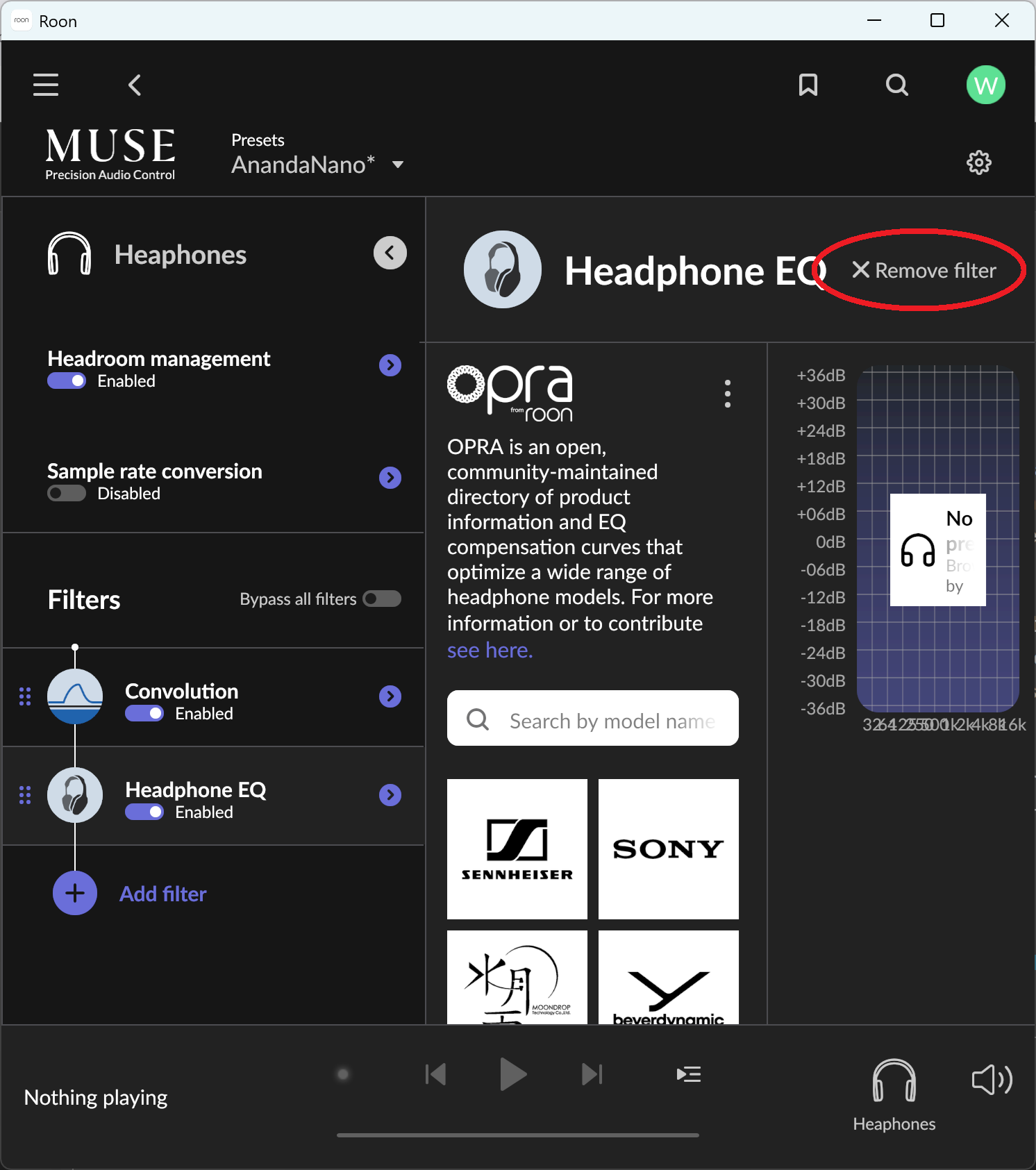

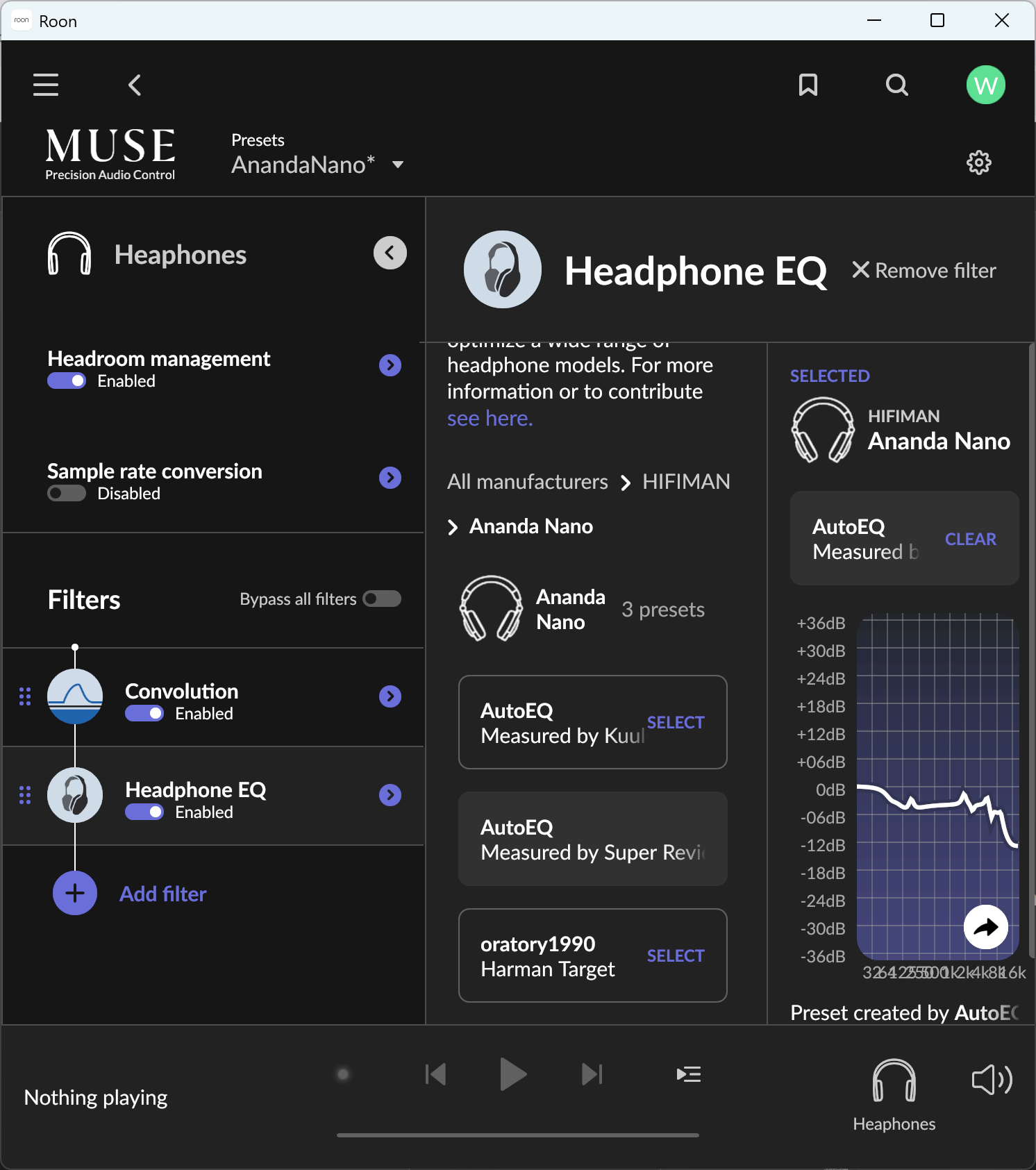

My headphone endpoint settings (with Headphone EQ temporarily added):

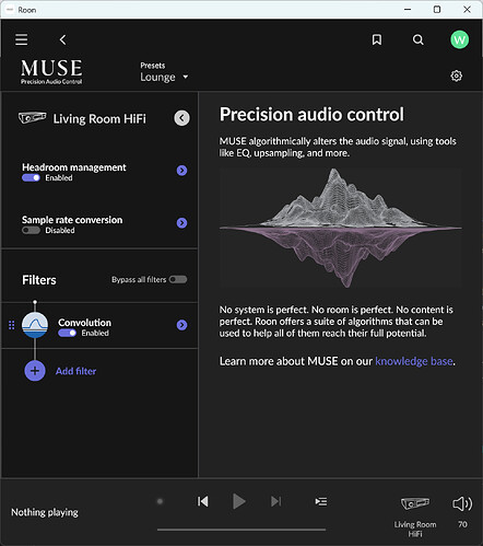

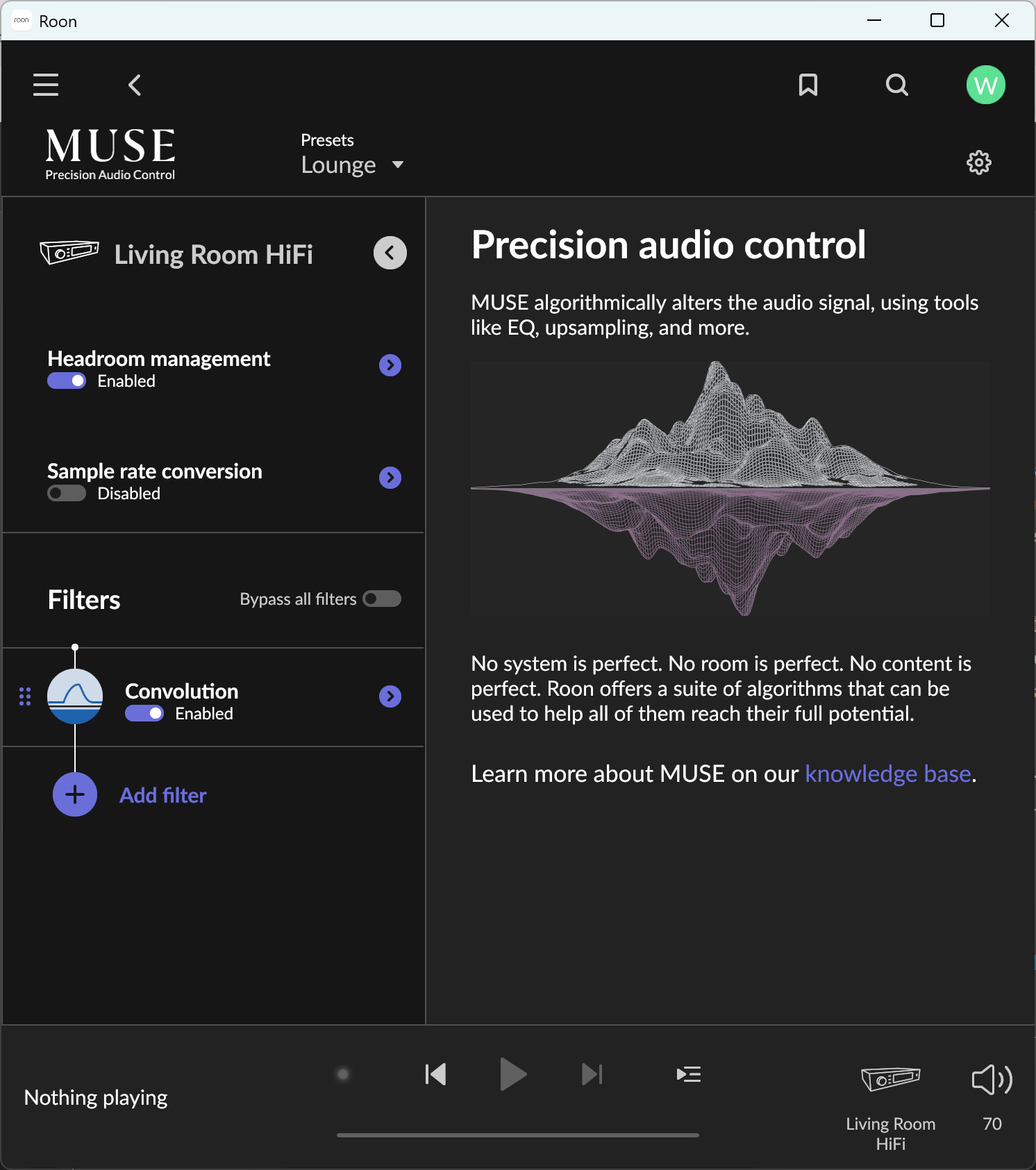

My main Speaker endpoint (with no headphone EQ added or enabled):
OPRA headphone EQ is a MUSE DSP function just like all of the other DSP functions and, as a consequence, it is configured on and endpoint by endpoint basis. For endpoints that don’t require headphone EQ, simply remove the filter (as I will now have to do after temporarily adding it to my headphone endpoint setup):
