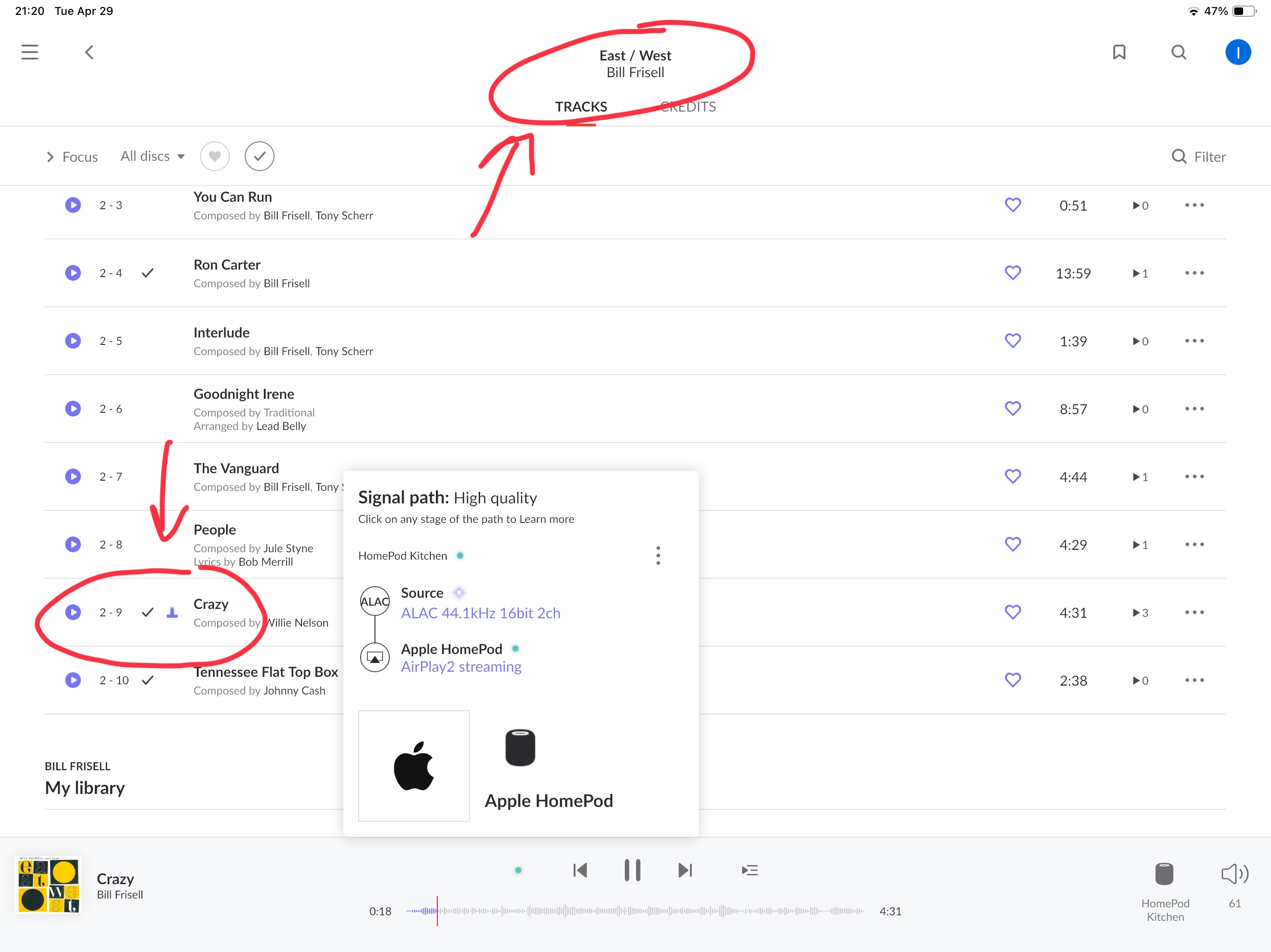

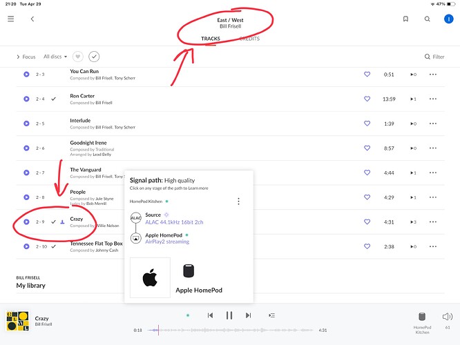

Could you please share a screenshot of the Signal Path when the clicks and pops occur? Sharing a specific track name would be helpful as well - we’ll attempt to enable diagnostic mode for Roon Server to take another closer look.
If you haven’t yet, can you set up a temporary hardwire connection to the endpoint and see if the same issue occurs?
Thank you! :raised_hands:
Hi @benjamin,
Just tried again, had to retry 3 times. Tip, if after 20 seconds you don’t hear anything, just rewind to the beginning of the track. See below the screenshot and track information…

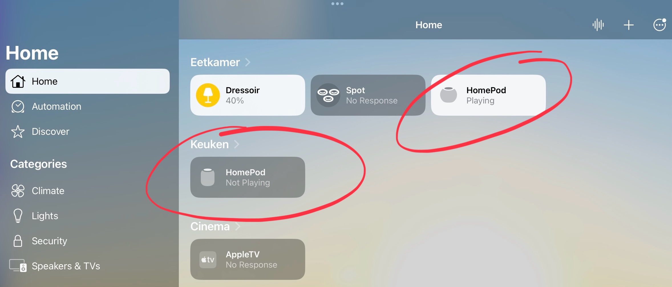

We see the device defaulting to AirPlay 1, which could be causing the clicks and pops you’re hearing. In the meantime, could you please test out adding the device to your Apple Home app to see if this helps? Here’s more info on how to do this (you can ignore the specific devices highlighted in the article and follow the steps on how to add a new device):
Let us know if you continue to experience the same behavior, and we should have some more information to share on our end as well. Thank you! :raised_hands:
Hey @benjamin,
Actually, both HomePods are added from day one to Apple Home; it’s basically the only way to get an HomePod up and running after the unboxing :wink: . So, nothing to hope for over there…
See below a screenshot, note that the names in Apple Home are in Dutch:
