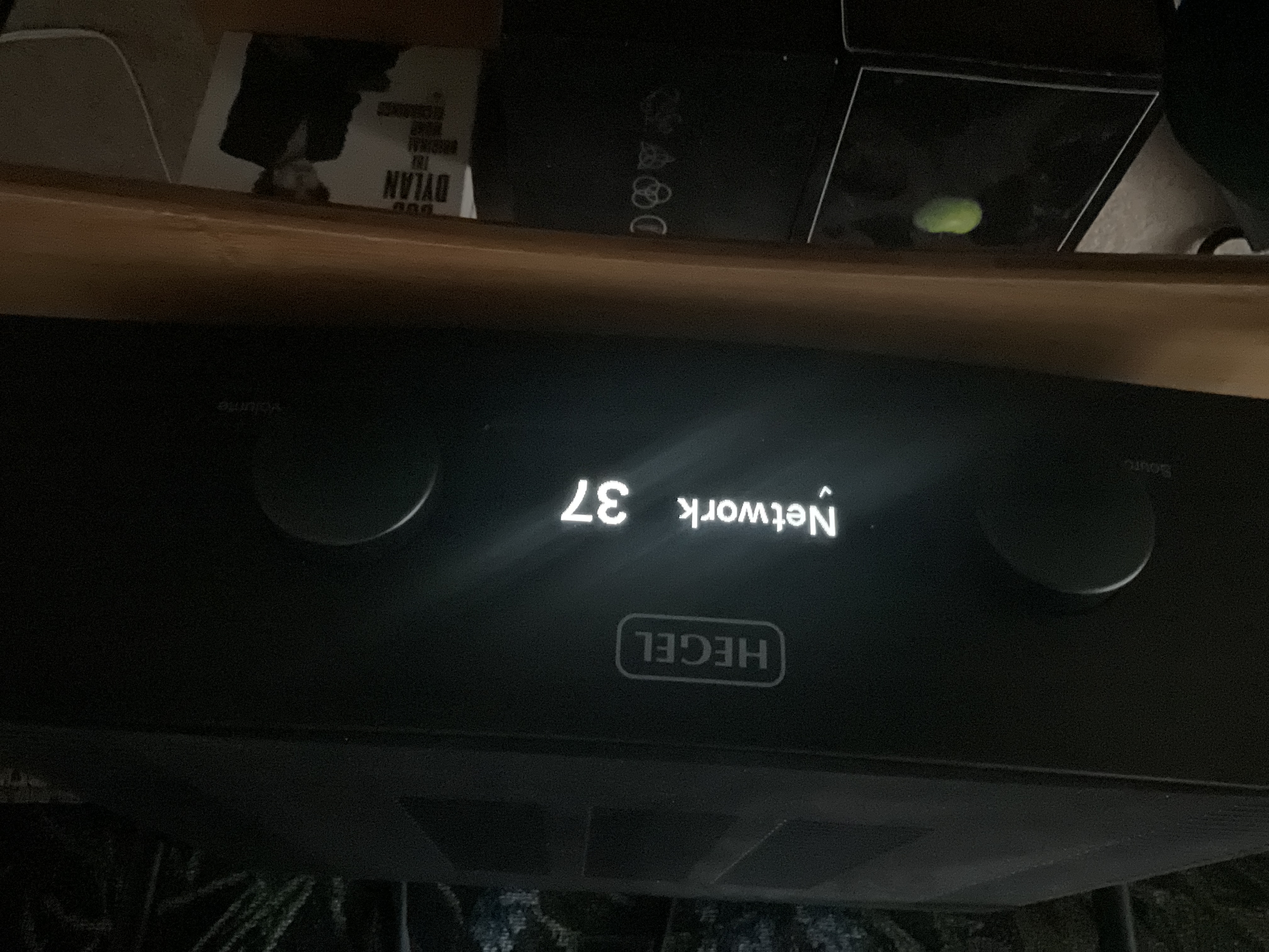

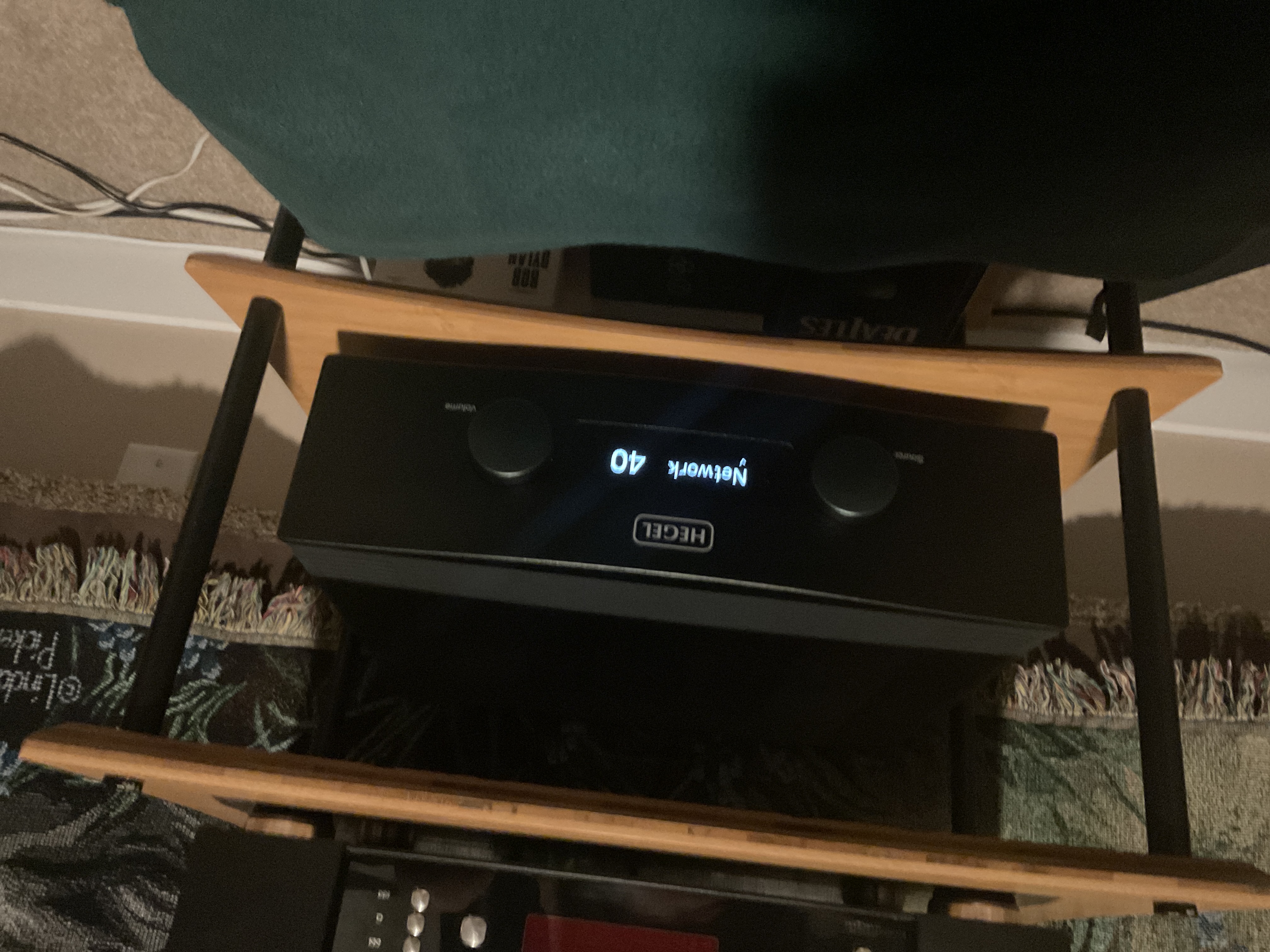

I have Roon app but can’t get Hegel 390 to show Roon on its display
I have iPad, Hegel 390 and use Telus.

I am getting frustrated with getting Roon on my Hegel 390. Too bad I can’t actually talk to someone. Pity.
Hegel 390, iPad and Telus.
You need to run the Roon app (Roon server) on a separate PC or Mac.
Hegel can only act as an endpoint (renderer).
The iPad serves as a remote control.
