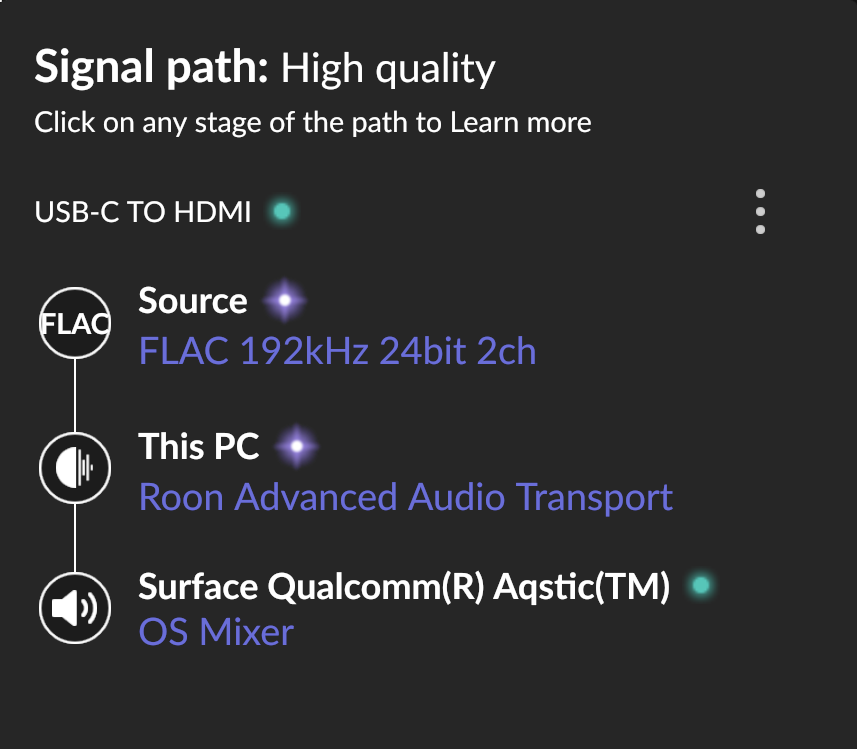

My signal path is green for the "USB-C to HDMI Adapter" and also "OS Mixer". How can I optimize my output signal path further to become lossless? Is it possible with a USB-C to HDMI adapter on a Surface Pro X? I am able to set 24-bit/192kHz audio in Windows Sound Settings as well as in Roon.
I am using a Netgear RAX43 (Nighthawk series) router with mostly default settings, minus a few minor tweaks such as disabling QoS and port forwarding the Roon Server ports.
I have a Microsoft Surface Pro X running my Roon server and client: this is CURRENTLY my primary PC. My main PC’s GPU died about half a year ago, and this Surface Pro X was a free gift…so it is now my main PC. I can get an “Enhanced” signal path at 24bit/96kHz audio with WIFI connection to my [Roon Ready] Samsung Q990F Soundbar, and I tested an HDMI output to the soundbar on my dad’s old laptop to get a “Lossless” signal path at 24bit/192kHz (which is the max supported by my soundbar), and I had the idea of using a decent quality USB-C to HDMI adapter to get the same “Lossless” signal path to the soundbar.
This is what Roon shows me:
I would like to avoid/bypass the OS Mixer if possible, and also the green dot shows for the connection by “USB-C to HDMI” at the top. Is this possible to improve or optimize toward a “Lossless” signal path?

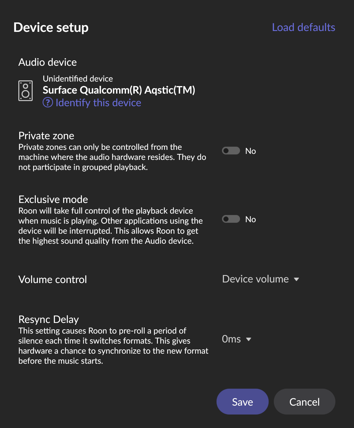

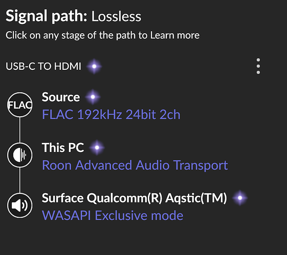

I FOUND IT: I had Exclusive Mode turned off. Now I have a Lossless signal:
Thanks anyways, and if it helps anyone else in the same situation: TURN ON EXCLUSIVE MODE IN DEVICE SETTINGS to bypass the OS Mixer.
EDIT: I jumped the gun on this being resolved: The signal path shows lossless, but in Exclusive mode there is no audio at the device :(.

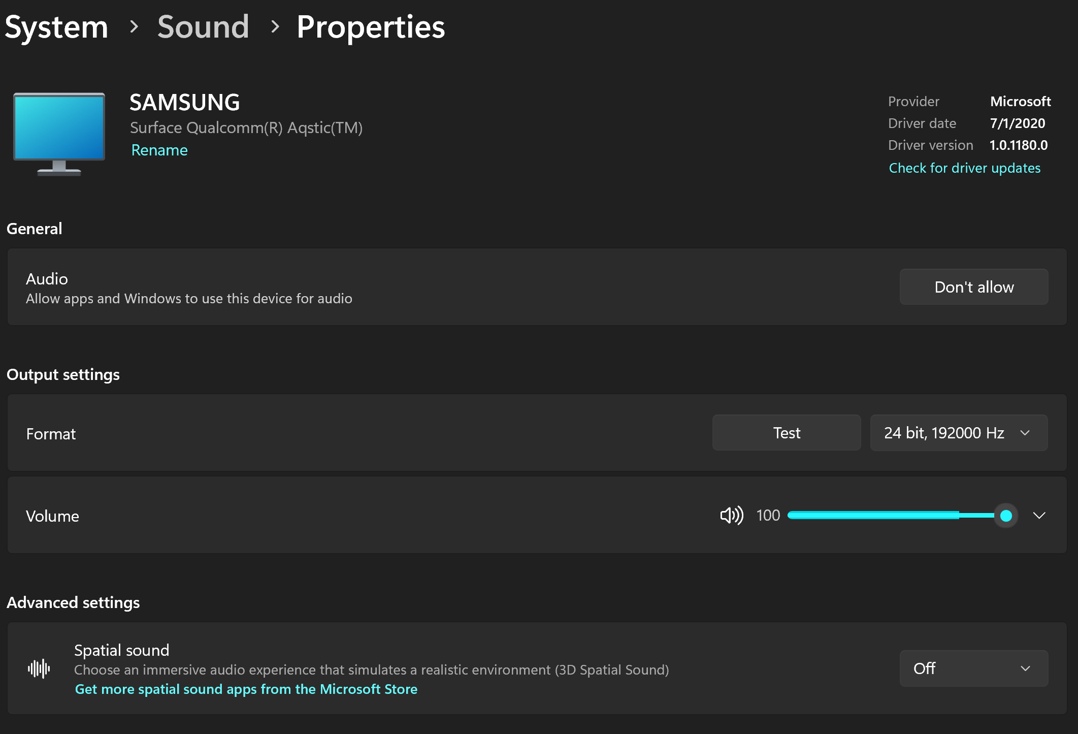

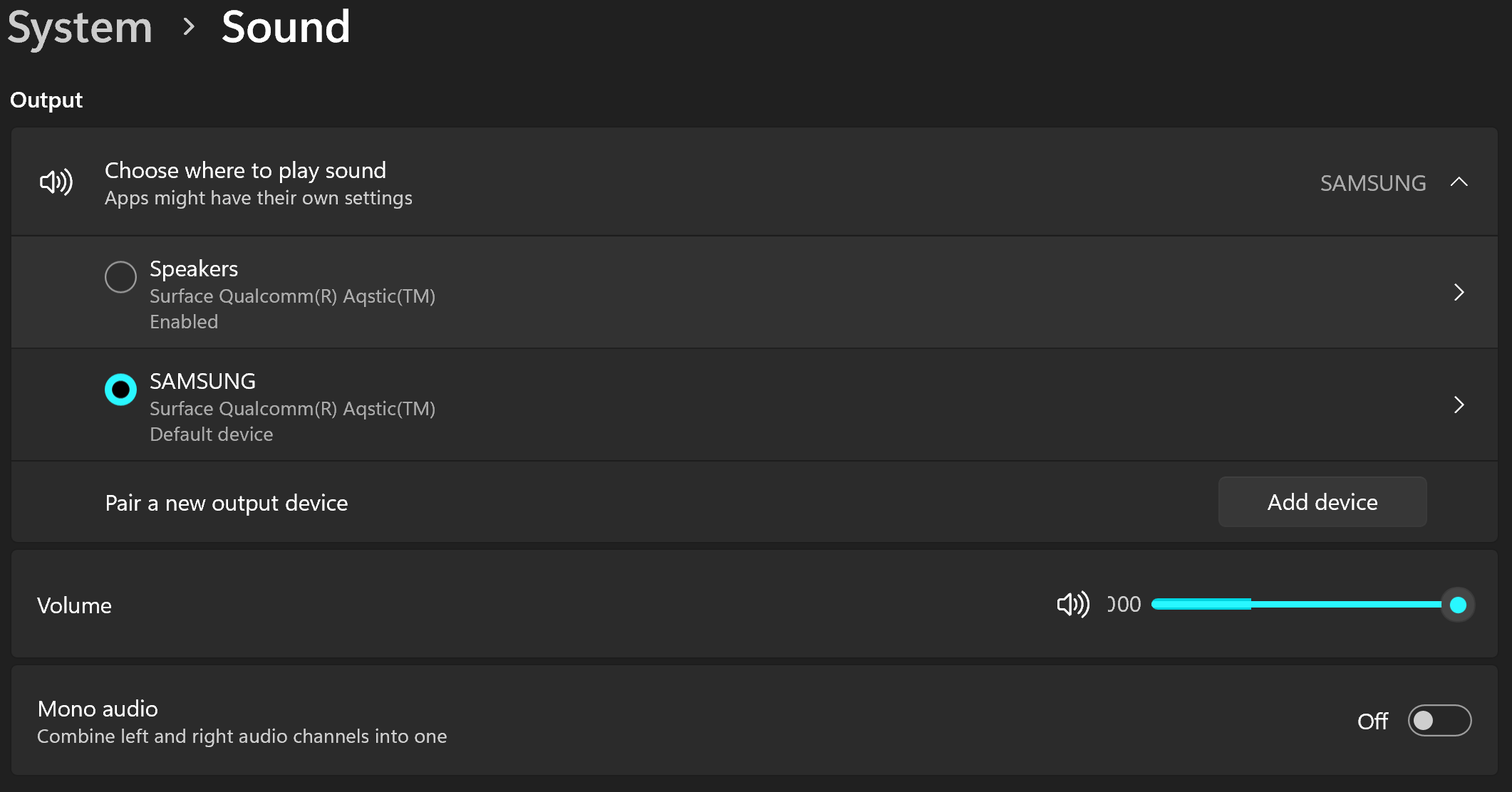

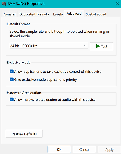

I googled and found some tips…Right clicked the speaker icon in taskbar, went to Sound Settings and then “More Sound Settings” further down the page. Then I selected the SAMSUNG audio device (Which shows correctly, the device is a Samsung soundbar (Q990F)), and then went to Advanced to disabled exclusive mode. I’m not sure if this disables ALL exclusive mode options, but I’m restarting the Windows Audio Service and also restarting the PC, then I’m going to try using Exclusive mode only in the Roon app. I’ll post results in a bit.

As I imagined would be probable, Roon was unable to output audio with Exclusive Mode ENABLED for Roon device settings AND DISABLED in Windows Sound device properties.
So far, I can only get audio at the Soundbar using NO Exclusive Mode. As such, the signal path shows “OS Mixer” and is green in signal path instead of blue/purple.

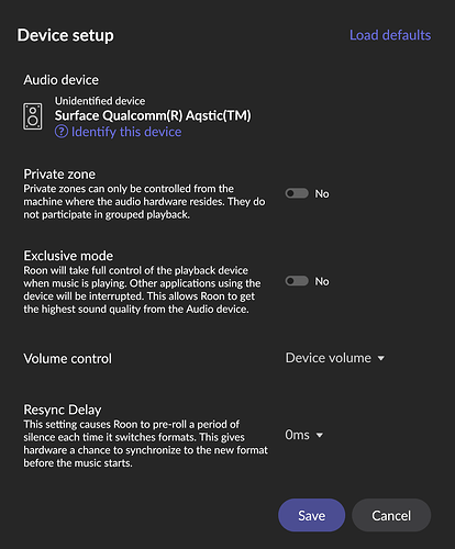

These are my current settings that WILL output audio, and show all lossless signal path except for the OS Mixer being used, which results in a green dot in the signal path.

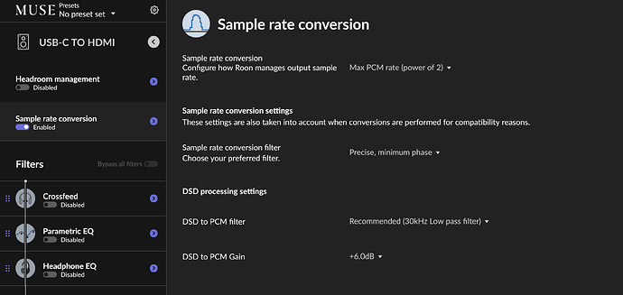

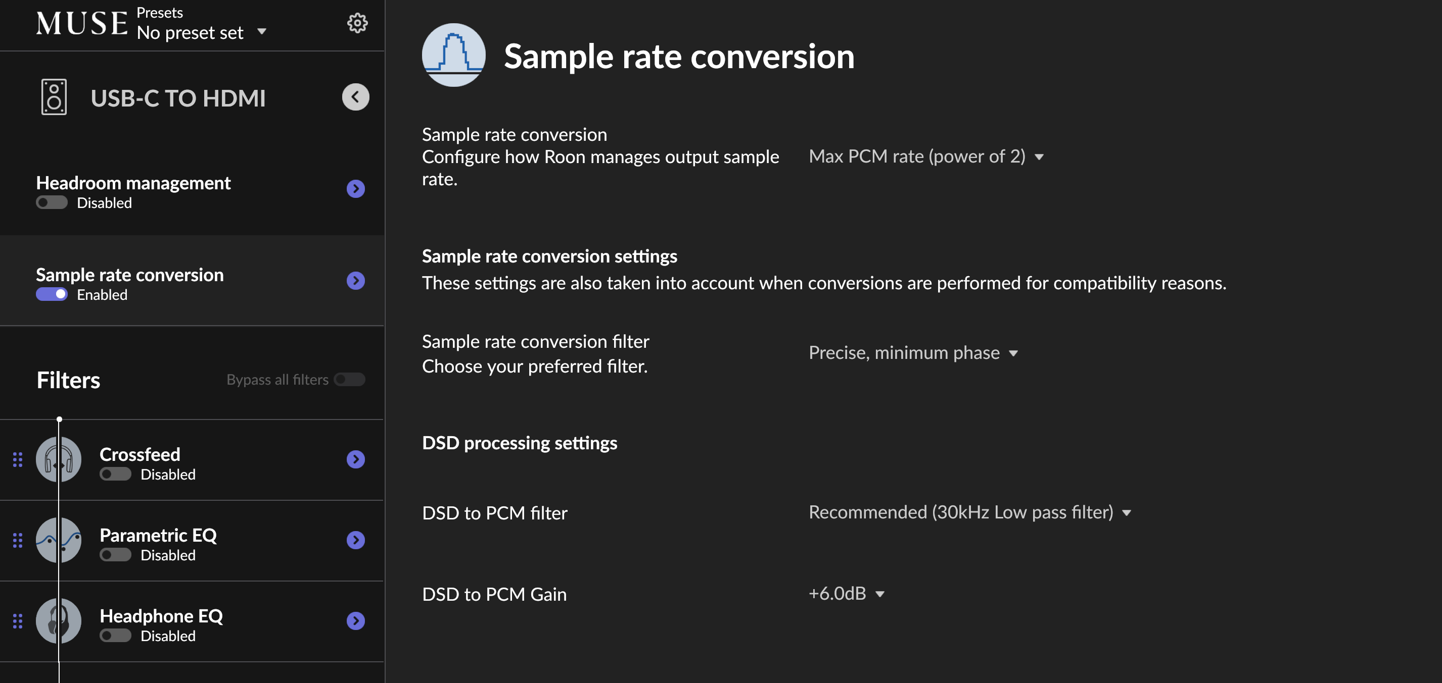

(Not sure if max PCM Sample Rate conversion is useful or necessary with a 192khz audio signal and output…maybe it upsamples lower bitrate sources?)

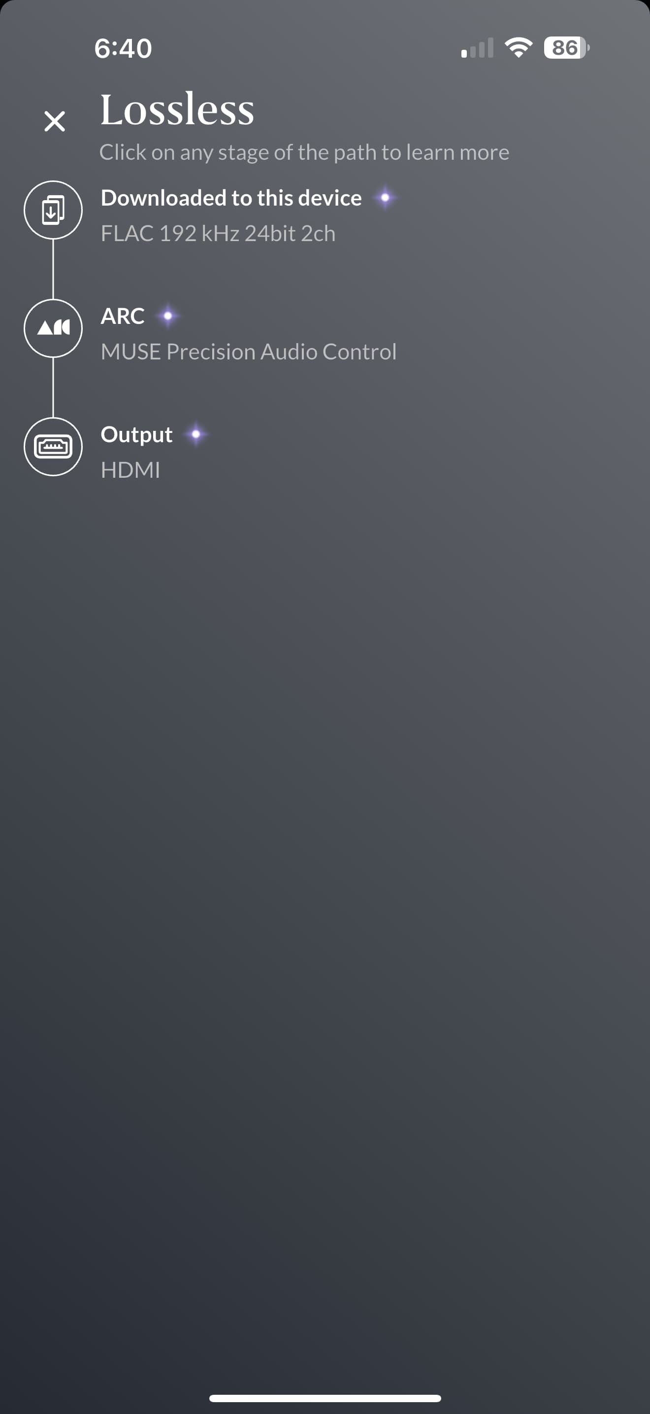

EDIT: Just out of curiosity, I’m going to try a 192khz signal from my iPhone 16 Pro Max usb-c output using Roon Arc. It may have better ability to process signal than my Surface Pro X’s “OS Mixer” being the generic Windows audio driver.
EDIT 2: Lossless signal works flawlessly outputting from my iPhone.
But, the low end is still missing a lot of depth and fullness. The mids/highs sounded great, but I didn’t get to a section of song with cymbals or any high frequency notes for testing high treble. Maybe if I get the 24bit/192khz rated adapter my setup will be optimized for HDMI signal pathing. My current assumption is that this adapter was made mainly for video output and only supports audio at a basic level.

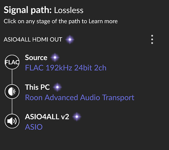

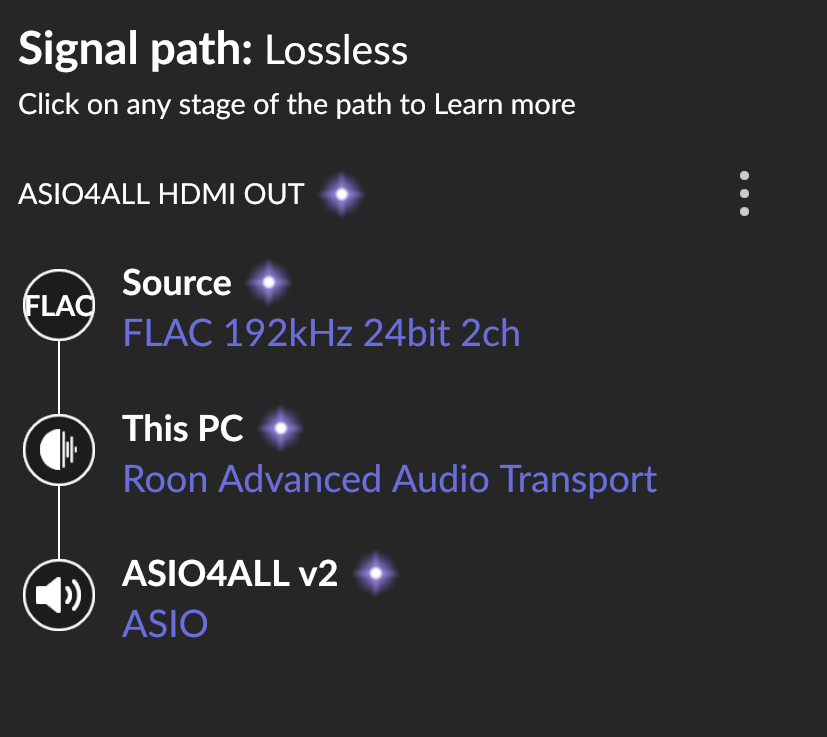

Just to update, I fixed the OS Mixer problem with ASIO4ALL. The output is lossless from Surface Pro X → USB-C to HDMI → Soundbar…just not a super high quality sound and missing some low frequency ranges.
I am still very interested in trying the other brand (Zestik) USB-C to HDMI adapter that specifically states having 24bit/192kHz audio bitrate support and maybe that will clear up the sound and fill in the lower frequency range…I’m assuming that if the adapter specifically notes support for 24bit/192kHz audio it will have better audio passing capabilities.
I do not know the technical aspects of how the adapter is handling and sending the signal to the HDMI cable…but at least I got it to function as a lossless signal path with this output method on a PC.
