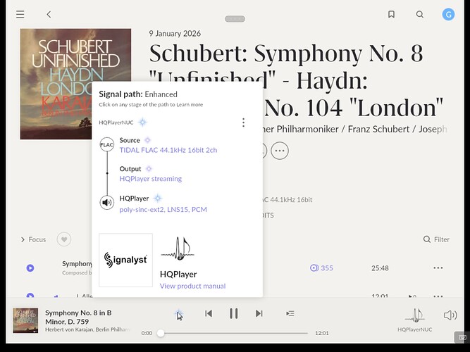

The error in topic happens when Roon is not providing data at sufficient speed. Please also check Roon signal path that it is not performing any DSP and providing HQPlayer just the bit-perfect data.

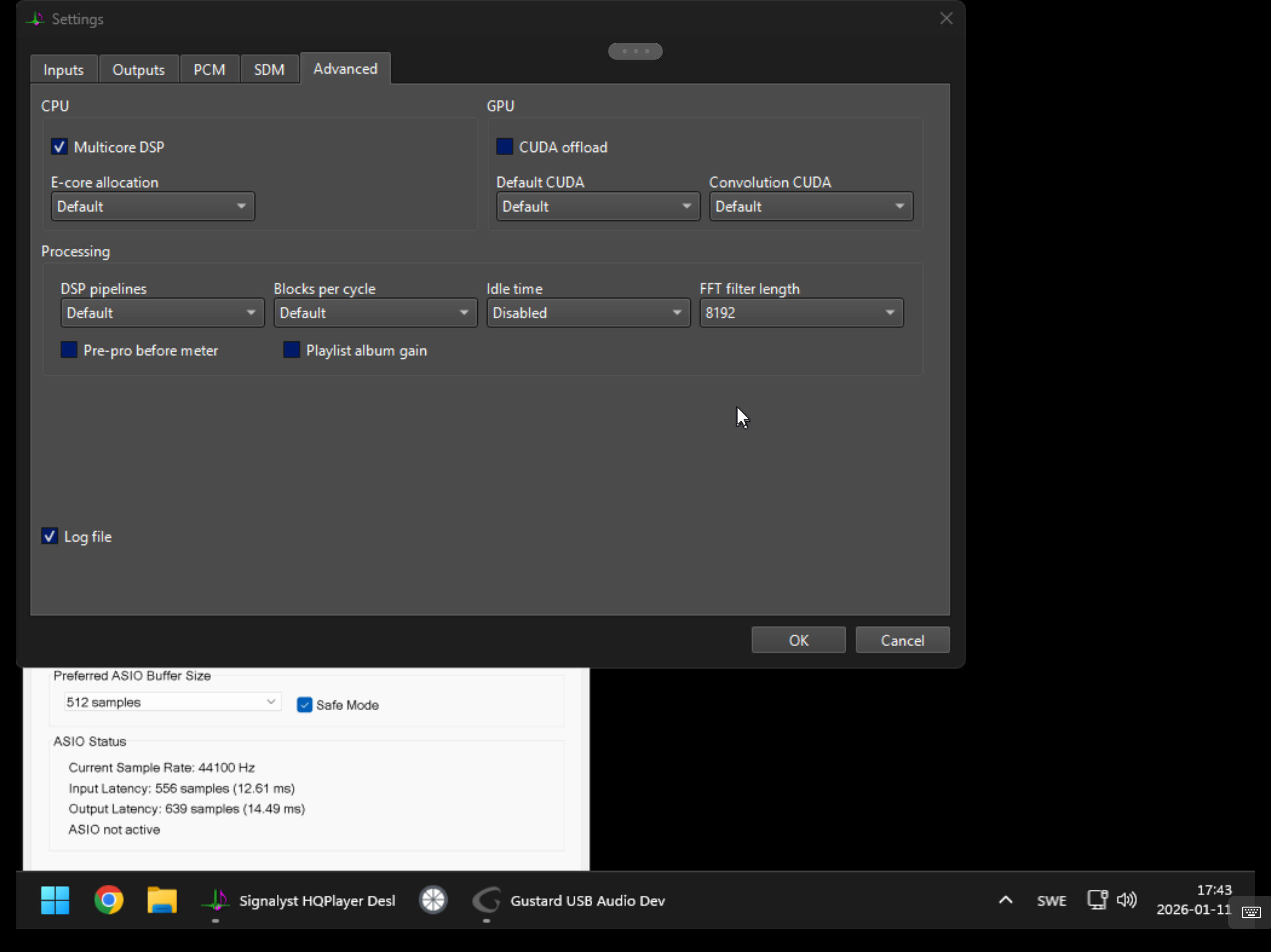

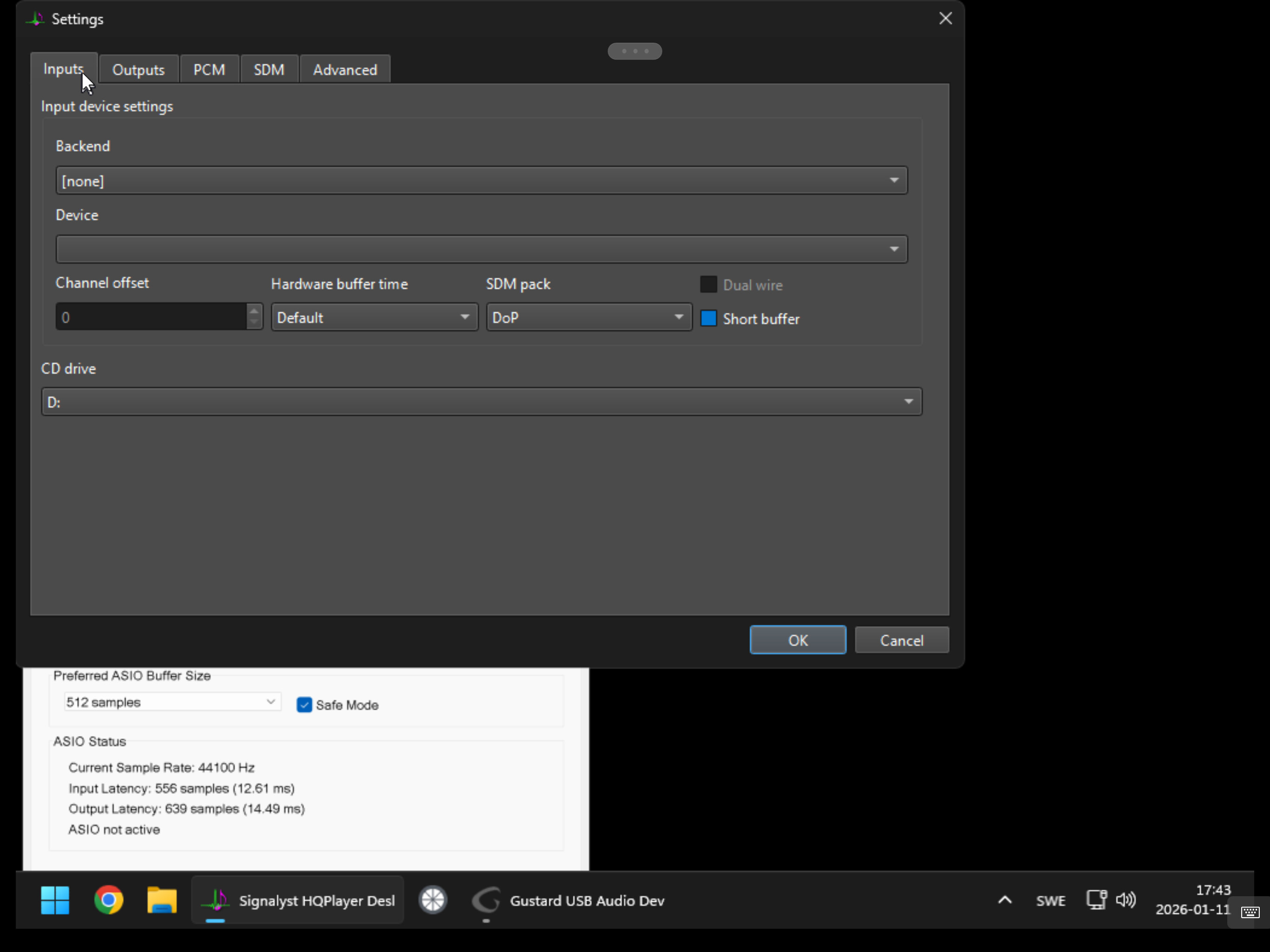

For now posting pics of my settings:
Changing to ”Localhost” seems to have helped, great tip!

One of the most important settings with Roon is “Idle time”. I recommend setting this to 10 or 30 seconds. I’m using 30 second myself. This prevents excessive HQPlayer engine starts/stops that otherwise Roon has bad habit of doing.
For output FIFO buffer side, you can use the “Short buffer” option to reduce the output side buffer. But of course especially the lowest setting risks getting dropouts again.

Any point in changing the value for ”hardware buffer time” under HQplayer - Output ?
Buffer time setting asks the device driver for certain buffer size. For WASAPI backend on Windows it is pretty straightforward and you can set the value for example to 100 ms which is my recommendation. However, with ASIO backend it is generally better to set the buffer size from the driver control panel. When set to “Default”, HQPlayer uses the size proposed by the ASIO driver. Not all ASIO drivers even allow application to set the buffer size, or the desired value may not be available.
