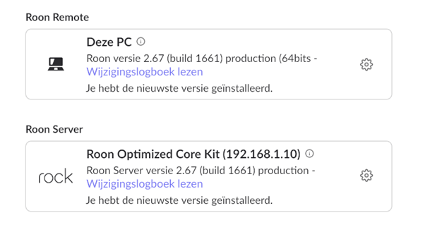

As an aside, we noticed your Roon Server instance hasn’t been updated in some time and is running an outdated Roon build. This might be influencing symptoms of poor connectivity you’ve had on this and other Roon Remotes. Please navigate to Settings within Roon and update your server as soon as possible.
We’ll watch for your response and we’re happy to clarify any details.
Hello &Connor
I surely think that my roon core is running the last available build. Dated: 2-7-2026.
