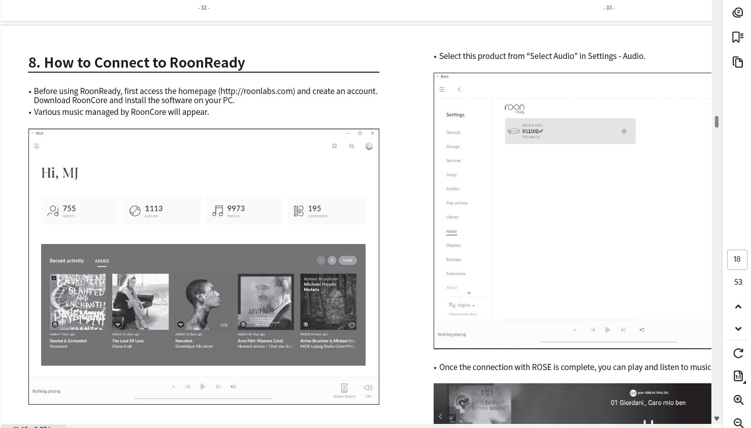

I have no experience with HifiRose, but there is no such thing mentioned in the online manual.

The dealer probably meant you switch on roon ready in the roon app not the Rose app. I assume you have done this? It’s standard operating procedure in the roon app to enable any device.

If you’ve configured the network in a correct way, the Rose devices should immediately shown in Roon as activatible Roon Ready devices.

There isn’t anything you should need to switch on the Rose unit itself apart from ensuring that it does have a network connection to the same network.
I would start with checking that a) Rose itself sees itself having a correct IP address, b) can access network resources (e.g. Rose Radio works) and c) you do not have any device isolation settings configured for it in your router.
Then go into Roon/Settings/Audio and check that Rose shows up there. If it does, activate it and it should all work If it does not there’s a problem somewhere.
