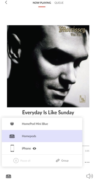

I have my Sony Bravia TV.
AppleTV connected to eARC (and setup within settings).
AppleTV set up HomePods as stereo speakers
via airplay, so all the sound is played through them.
In HomeKit, HomePods are setup as stereo.
Roon then detects the AppleTV as the airplay device and outputs into stereo on the HomePods Minis.
This is a seamless transition, so I can play music with AppleTV via Roon, and I can then stop the music and continue watching TV without issues.
Is that what you was saying in the above post?

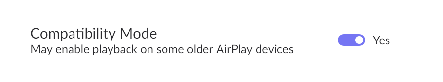

Can you please try to switch the homepods to 2.4Ghz network (it might improve the stability) and in Roon Audio settings make sure to enable the Compatibility Mode .
This might help you to improve stability and keep your speakers in sync.
Let us know please whether it is working for you.
Regards.
