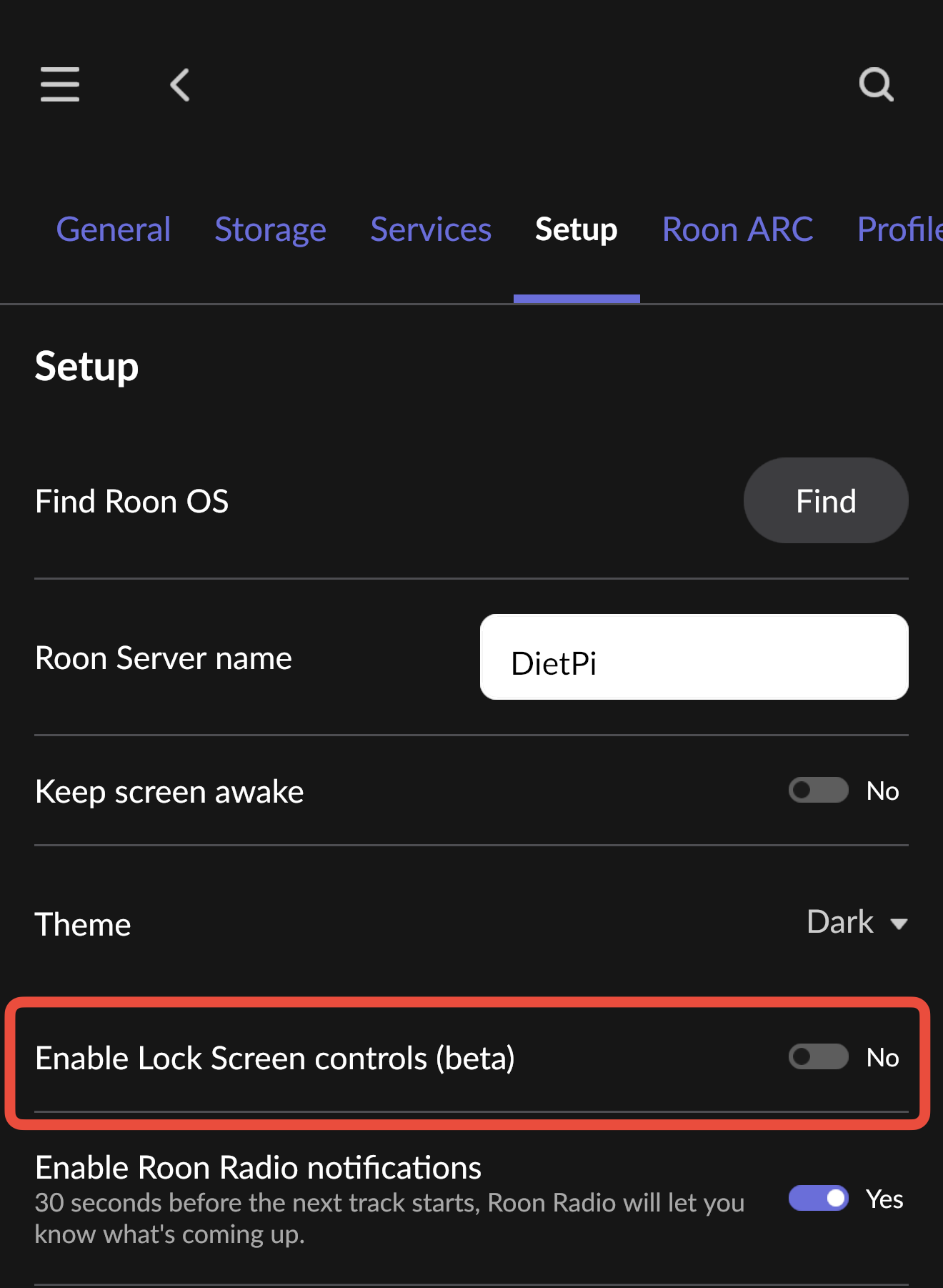

Also, just wondering if you have Lock Screen controls enabled. If so, try it disabled.

I do not have “Enable Lock Screen Controls” turned on. This is set to no.

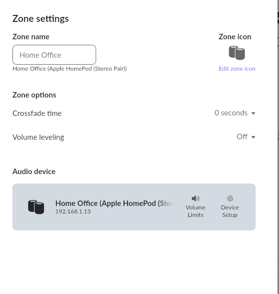

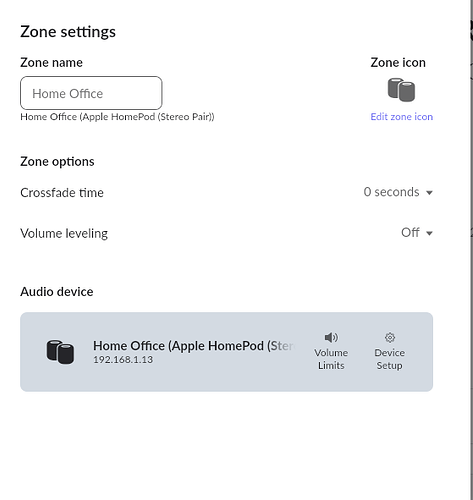

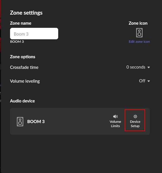

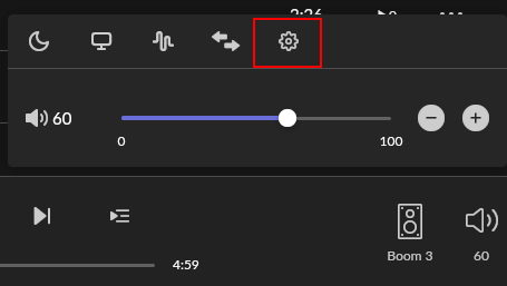

While you have the zone you want to use exclusive mode with active click on the volume button.
On the menu that opens click the gear icon
That will open your Zone Settings. From there click Device Setup.

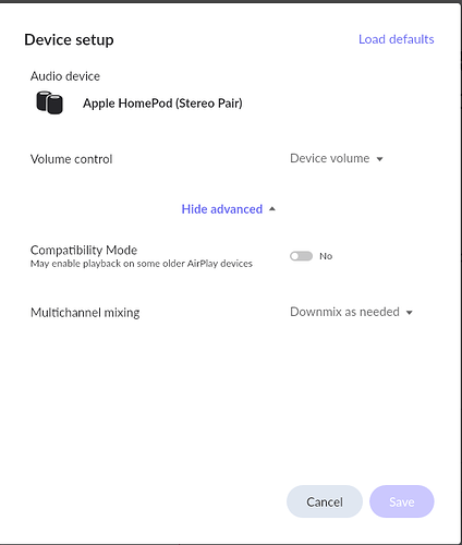

You should see the exclusive mode setting then. Please let us know if you have any trouble.

I opened my zone:

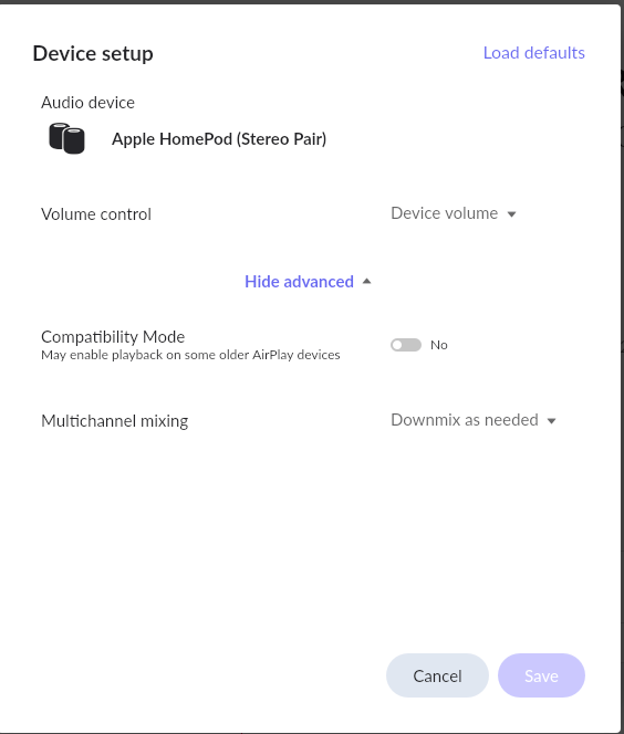

I then go to device setup:
I still do not see anything called exclusive mode setting:

Glad to hear the volume jumps have stopped—thanks for letting us know! I should have mentioned this earlier, but it’s expected that you won’t see the option for Exclusive Mode when using networked speakers like your HomePods.
