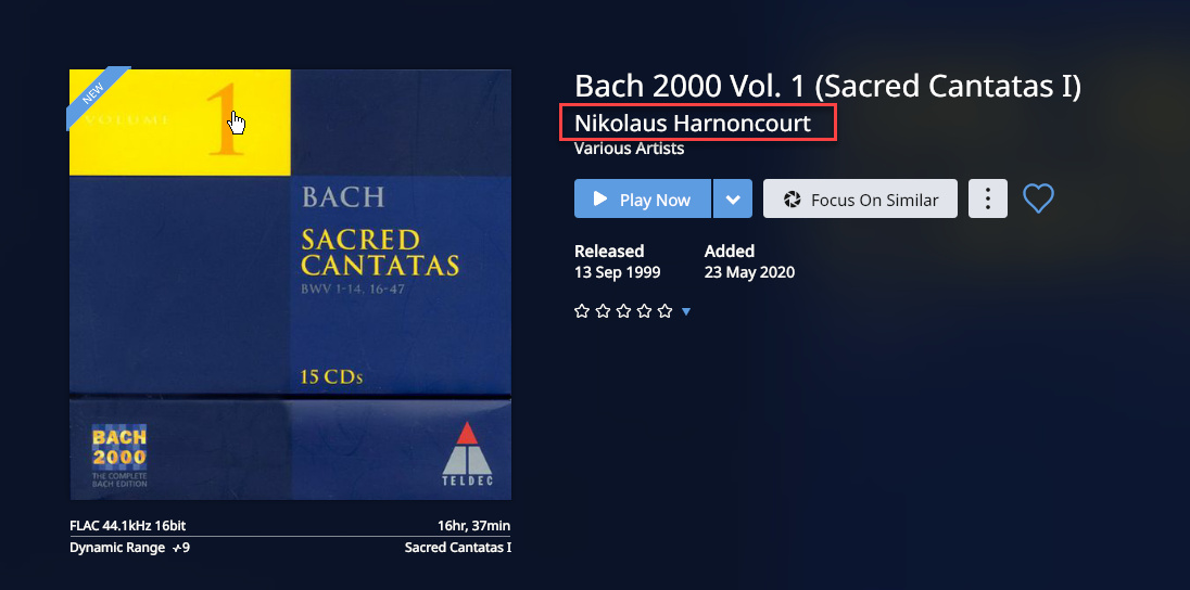

If you look at an album what does Roon show for the primary artist in these cases? Does it show unknown artist? If so, use the funnel filter on that.
it sometimes shows the name of my album artist but not as an artist link. Only as plain text.
The funnel filter will work whether plain text or linkable.
like this. I do have Eliahu Inbal as Artist in Roon and I use the same spelling throughout my file tags.

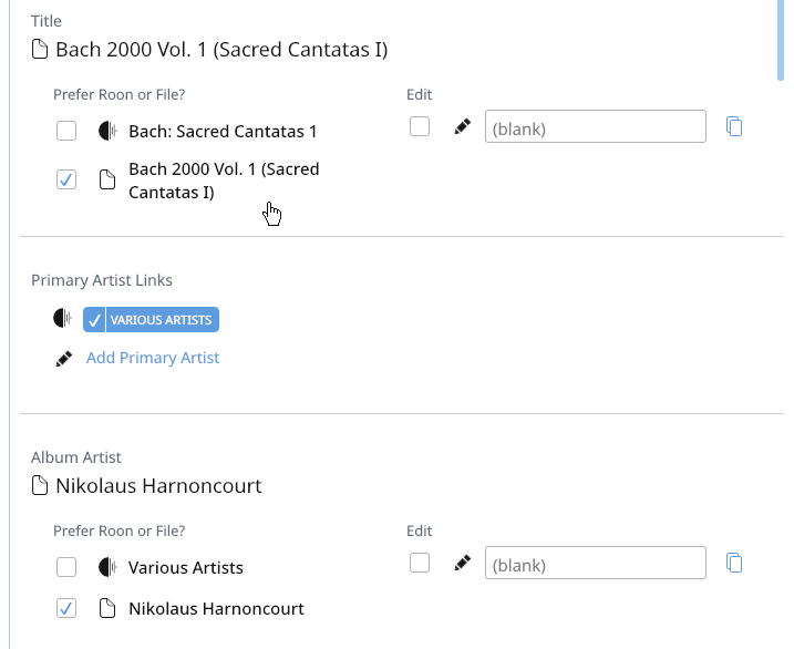

However, to tackle this from a different angle: How can I prevent this from happening? I understand that Roon uses the album artist tag as one of the input items for determining the primary artist. Why is this not always working properly?
Example:
I have set my library settings to “prefer file” for the album artist tag and I have tagged this album with the album artist Nikolaus Harnoncourt.
I already have the artist Nikolaus Harnoncourt in Roon. What could I have done in order to have Roon accept it from the tag as an primary artist link?
If the primary artist tag cannot be used to populate the primary artist, my question would be: what does the “prefer file” function for the album artist actually do?
[edit]: I have ignored the fact, that “prefer file” on album artist makes the tag content appear on the album page, even if there is no primary artist link established. Stupid me. But still, I’d be interested to understand how to trigger primary artist links being created.
I do not properly understand what is happening here.
This is an identified album and (rightly or wrongly) Roon has decided to use its own metadata for the primary artist link. (Note the Roon symbol next to the Various Artists)
I think Prefer file doesn’t stop Roon using something if it thinks it can add to your data.
If you unidentify it (use identify and refuse all offers) does it stick N.H. in as primary artist?
(Incidentally, as it’s identified, my work round above won’t find it)
when I unidentify the album I get Nikolaus Harnoncourt als only Artist on the album page and no Various Artists. That would have been my expectation.
However, what I find puzzling is that in the unidentified case, Nikolaus Harnonocurt is accepted as a “real” primary artist, i.e. shown with a link
If I identify again, I see both (what I would have hoped) but no link on Harnoncourt
