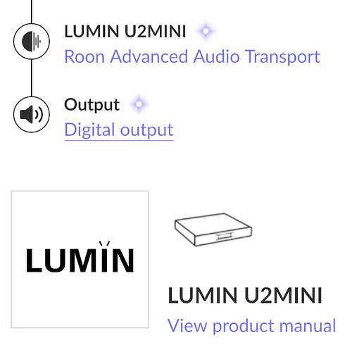

For instance, here’s what’s shown at the end of the signal path when playing to the device in question:
So… is this phantom Yggy there because I manually chose it as part of the earlier setup?
How do I remove it?

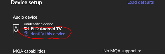

Under settings Audio do you have the “identify this device” option? If so, click on it to pick from a list:

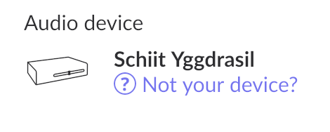

Or do you see "not your device? If so, click it and it should reset it to “identify this device”

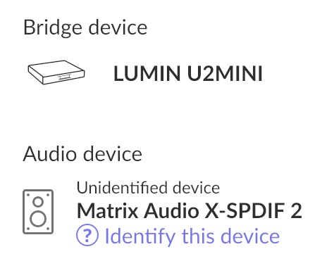

But I figured maybe it would help if I scrounged up some USB audio device to plug into the U2, to force Roon into a state where it again thought a USB output device was primary on the U2 – whereupon it might start showing me the opportunity to edit stuff. And indeed it was so, when I scooped up a Matrix X-SPDIF bridge and plugged it in.
It showed me this:

…giving me the opportunity to click on the hot “Not your device?”, which cleared out the remembered Yggdrasil and dropped me back to:

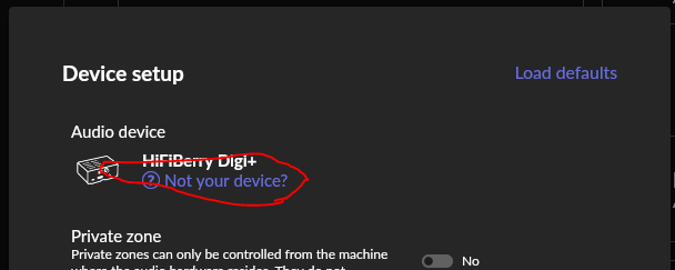

eventually we got here, which was the goal:
So problem finally solved!
