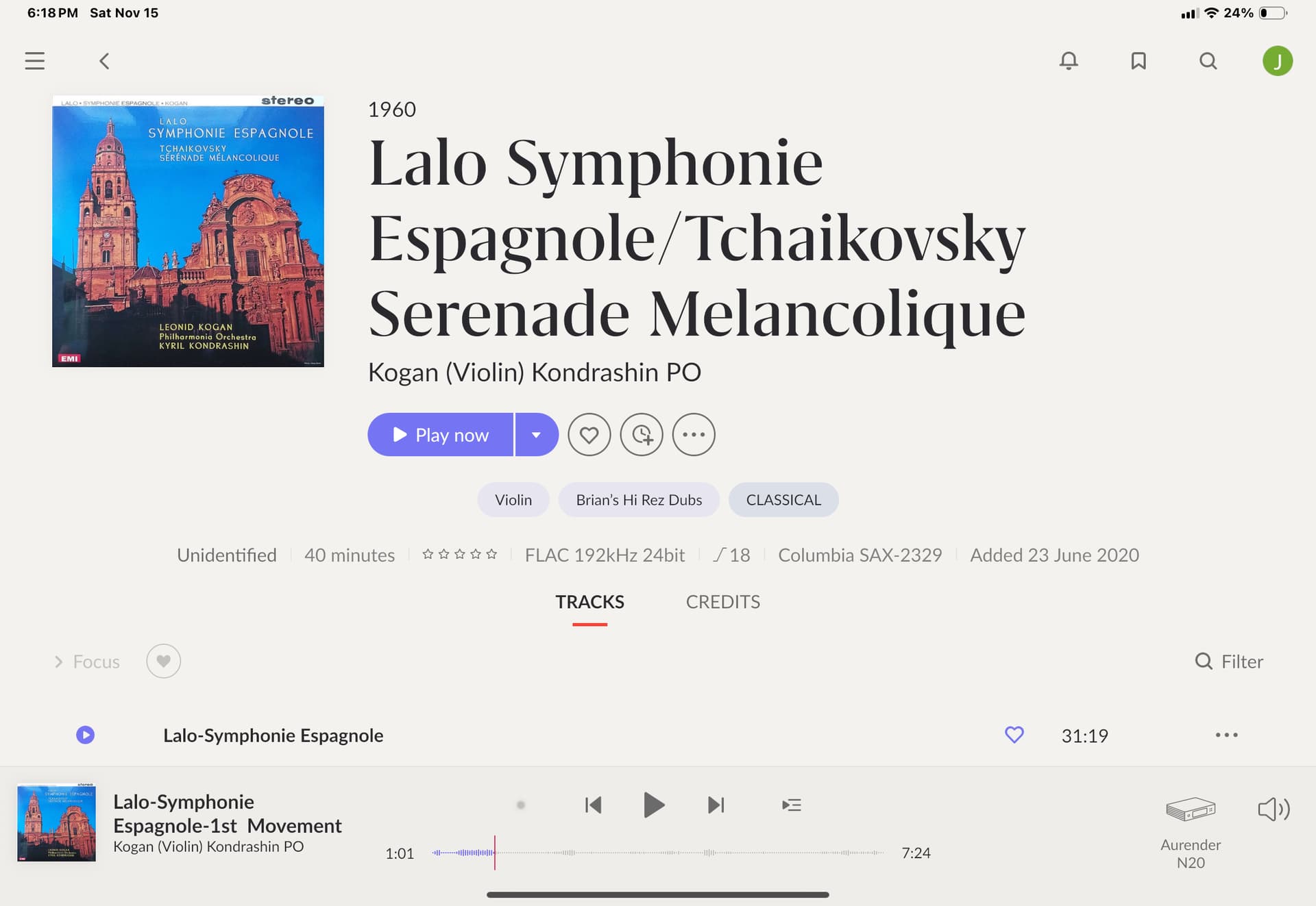

This is a simple example because the recording only has two composers:
The screen shot shows my Roon listing for this recording. I’m separating the two composers with a slash, but I’ve also tried entering each one as though I was creating it for a single composer, like this:
Lalo: Symphonie Espagnole; Tchaikovsky: Serenade Melancolique
I’m wondering how others handle this fairly common problem with classical music because either way I compose the metadata title the secondary composer and title is not searchable.

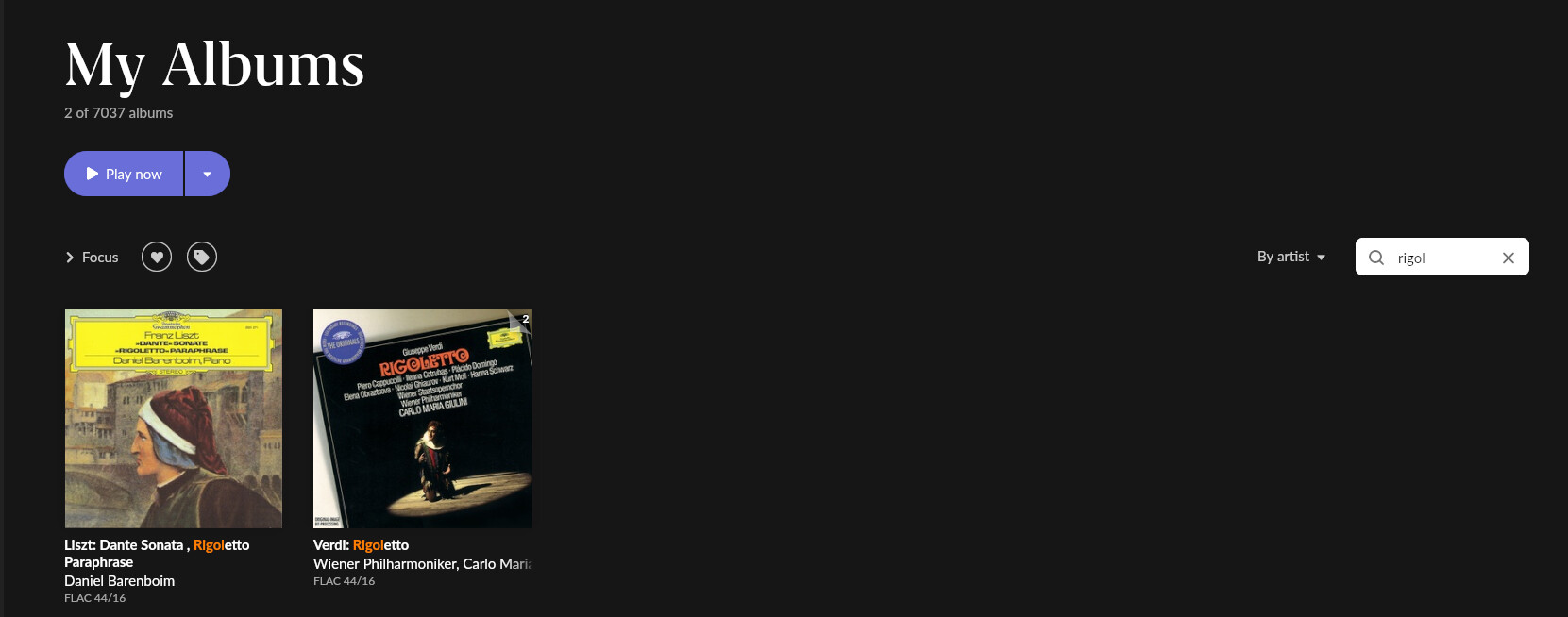

Have you tried the Filter tool
Next to the sort selection.
Think of an album, then think of 3-4 letters that are “fairly unique”, not a composer say Rigoletto if you choose “rigo” you will get very few hits If you add the next “L” it drops to 2
It works just the same on Artists so “calla” would fine Callas

That’s why Filter is so good it just looks for the sub string anywhere in an album title
Eg “vau” is not going to match much more then Vaughan Williams. If it does just add the “g”
