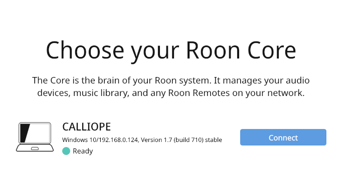

I’m trying using the full version in my home office. It’s on the same network as the core, both hardwired to the network. When I clicked on Find My Roon Core it started searching the network. It seems to be hung up. The core is powered on and working.

Do you mean this -
If not, please print screen that you are referring to.
I don’t believe that, particularly if your DAC is connected via USB to your Roon endpoint.
If core does not find endpoints you might have network issues. A lot of issues with Roon in the end have to do with network setup.
